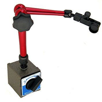

      All,
      Can anyone recommend a DTI holder – the articulated type with a central locking knob that locks all three joints in one action?
      Prices seems to range from about £20 (including a DTI ! ), to about £200 for a Mitotoyo item.
      Obviously I want one with a high force switchable magnet, and high rigidity.

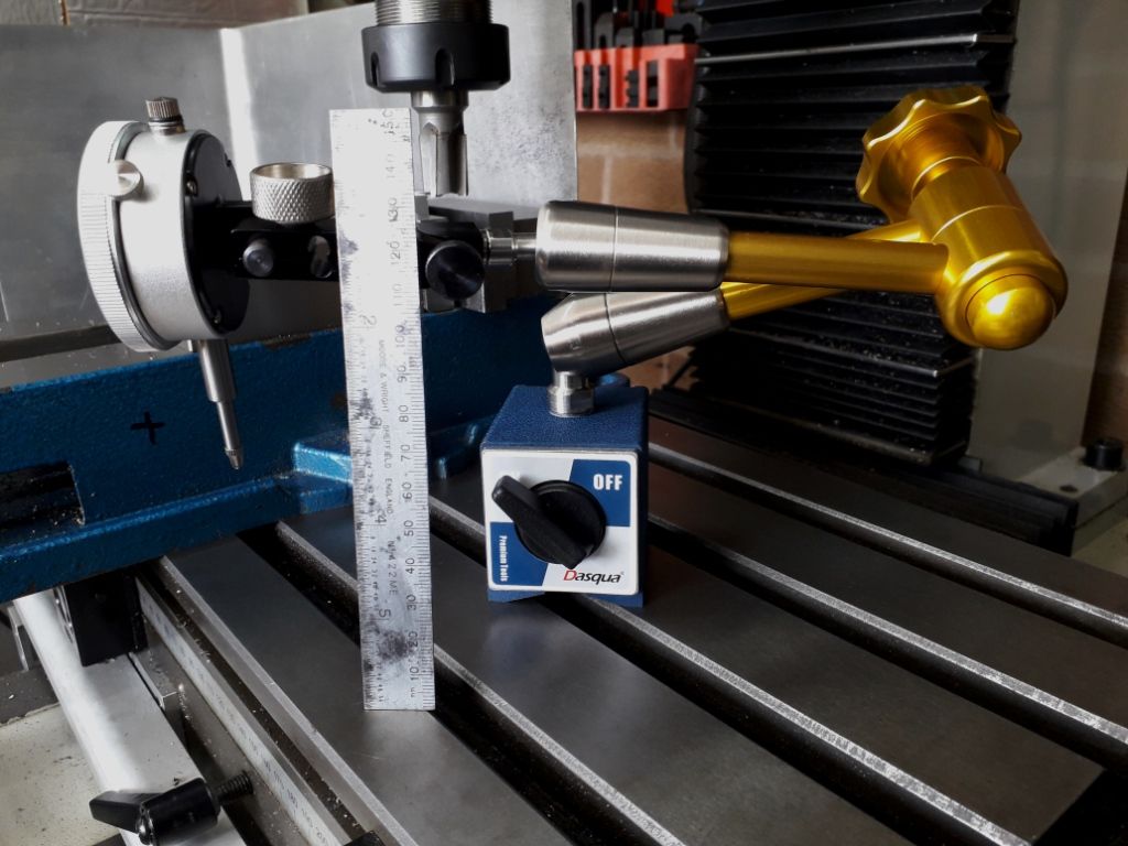

          I have a hydraulic Dasqua from Chronos, mid price range but very good.

            Thanks Henry.
            What's the reasoning behind it being hydraulic?

              I have the one pictured(or it's twin), and a couple of much smaller ones that were about £10 from ebay. The big one works perfectly out of the box; less than a turn of the knob locks it up tightly. The cheap ones now do the same after I took them apart and finished all the mating surfaces of the wedges properly.
              So I would say it's more of a wedging action than hydraulic

                    TBH I've no idea Dr! It does allow for a good feel when setting up if needed, unlike the clamp type which tends to be either clamped or not the hydraulic damping is there as required. Others here have Mitutoyo hydraulic but they are twice the price! I have to say it is very stable, I bought it for clocking on the mill, I use it under the head and sometimes on the quill/spindle so it needs to be stable. I have a conventional clamp type with a magnetic base for use on the lathe but much prefer the hydraulic!
                    One thing you might want to consider is the size of the base and arm, I have a Seig SX4 mill, its fine size wise for that, but may be a little large for smaller machines.

                                    Jez – These cheap mag bases 'move about' due to the fact the machined edges are not flat nor are they square to each other. I bought 2 similar to the one pictured by Journeyman in the toolmarket in Shanghai for £5 for both of them (knocked the seller down from just over £8 for the pair) I thought it was worth the money just to get the arms!
                                    However, after transferring the arms to a more substantial Starret mag base I discovered the out of truth in the original base. Put it in the mill and trued it up and now it is quite a handy tool with the smaller base.

                                      I have a Noga and 2 cheap versions. The Noga is perfect as it should be for the price. The 2 cheaper items now work very well after stripping and fettling them.

                                        I just bought one of the cheap ones for £14. I wasn't expecting champagne taste for lemonade money so I found it quite adequate given the cost. The base sits flat and the magnet will hold a DTI and a 2" dial gauge with the arm at full horizontal extension, so I'm happy with mine.

                                                    Gordon A, since you asked and no-one has answered I will tell you how the hydraulic ones work. The answers is just like car brakes. Instead of the foot pedal you have a piston pushed by the screw in knob. This pressurises the oil in the arm which in turn pushes on pistons that squeeze down on the swivel joints to lock them. The use of a small area on the pressurising piston and a larger area on the braking piston allows high pressure and solid locking. If the oil weeps out over time you can unscrew the knob to add a bit more as required.
                                                    When there is no pressure my Mitutoyo is very floppy, when pressurised it locks solidly. Between these extremes the arm stiffens up gradually to allow positioning, just like progressive braking with car brakes. The Mitutoyo I have has the knob at the base end, the Dasqua ones have theirs in the middle but otherwise I expect they work in a similar way.
