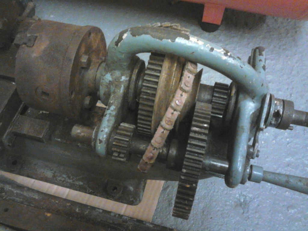

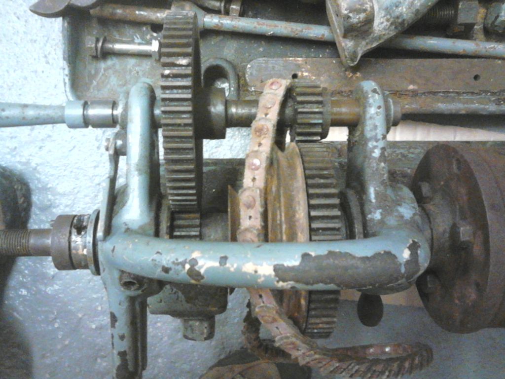

        Second and third photographs show the headstock. I can't get my head around the unusual back gear arrangement. With the shaft locked in what might be described as the rear position, both sets of gears are locked up so the spindle can't rotate…I suspect incorrect assembly by a previous owner. The leadscrew is free and rotates in it's bearings, and the clutch actuating bar is also free. The male portion of the clutch and all of the changewheels are missing so I'll have to make these, as well as fabricating a bracket for them. More info from Tony's site required!
        Fourth photo shows the tailstock. Currently stuck fast on the bed, but I haven't really made any attempt to shift it as yet.
        My eventual aim is to get the machine back into good order and to fit a 1HP 3ph motor with a VFD.
        I have joined the Drummond group on Yahoo, so I'll be posting there too. I'm sure I'll get a lot of useful information from them as well as all the other sources. That said, I'll reiterate the questions I've got so far as I'm sure someone here will have an answer.
        1) Where is the serial number likely to be?
        2) Whats going on with the odd back gear arrangement?

          2 possibilities come to mind for your back gear problem:-
          1 have a look in the face of the large gear on the spindle pulley to see if you can find a bolt head or nut. If so slacken it off and try and slide it towards the spindle. The bolt or nut holds a block that engages in a slot in the inside of the pulley to lock them together.
          2 if there isn't a bolt, look to see if you can find a grub screw buried in the bottom of one of the pulley v's. If there is try loosening it so that the pulley is free on the spindle to see if that gets the back gear working. One thing to bear in mind is that it's always possible that there are two grub screws in the same hole, the outer one locking the inner. If that's the case you'll need to loosen them both.
          Hope it helps but I think 1 was the way that Drummond built it, but it may have been modified sometime in it's long life.

            Many thanks for your post and the information therein. The arrangement you give in 1) makes more sense. The large gear or bull wheel on the spindle has a nut on the forward face of it. I know that this secures a locking block that keys together the spindle cone pulley and the bull wheel. As an aside there is a lot of backlash/play between the cone pulley and the bull wheel so I suspect either the locking block or the locating tenon in the pulley (or both) are worn. I may need to make a new block.
            I can't really understand what is going on with the back gear because in one position the whole of the headstock rotating assembly is locked solid by the fact that in that position the spindle bull wheel and pinion are locked together by the gear and pinion on the back gear shaft.

              Slacken the nut and slide it towards the spindle to disengage it from the pulley, this releases the pulley and rear gear which are fixed together on a sleeve coaxial with the spindle, this drives the front gear and spindle, slowly. Oil the sleeve!

                Thanks for that, I had suspected something of the kind. There will be a fair bit of work to do before I get to "oil the sleeve"! Great resource this site.

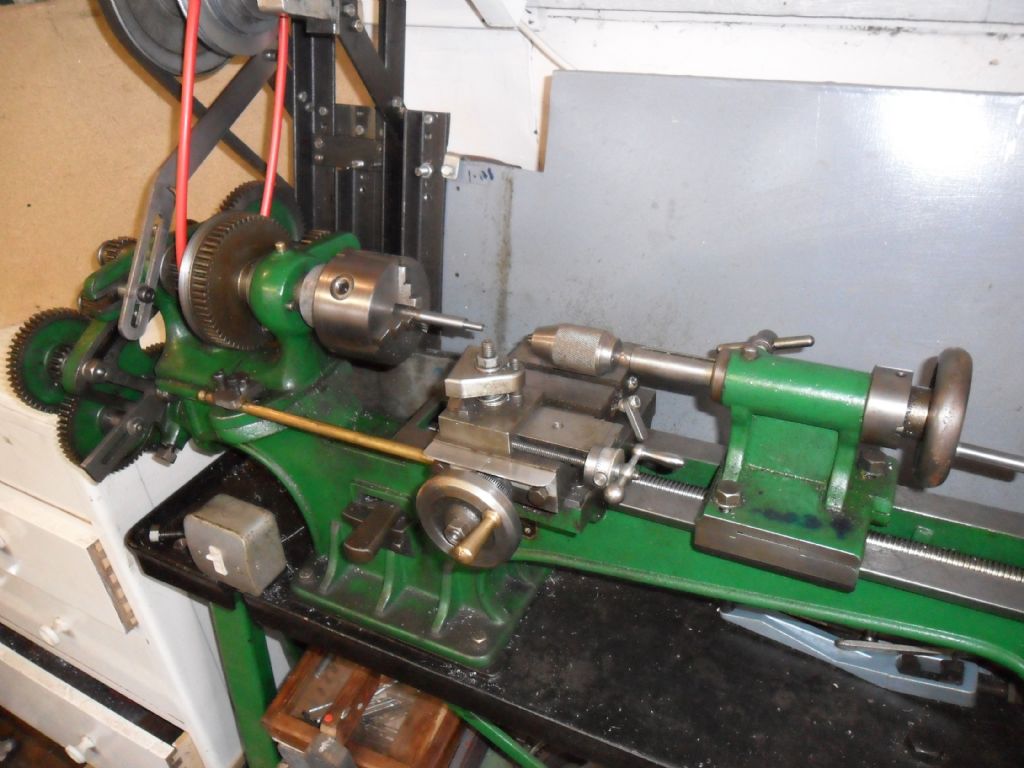

                            Did you mean no top slide . My flatbed did not have one . so i made a little one to help when screw cutting
                            Nobbydrummond

                              Yes I meant topslide, slip of the tongue, or rather of the keyboard. I suspect the topslide has been lost over time.
                              Thanks for posting the picture of your machine. It looks very good indeed. I think making a topslide will be on the cards along with many other tasks.

                                in the picture it's not the original X slide or tool post . They are under the bench

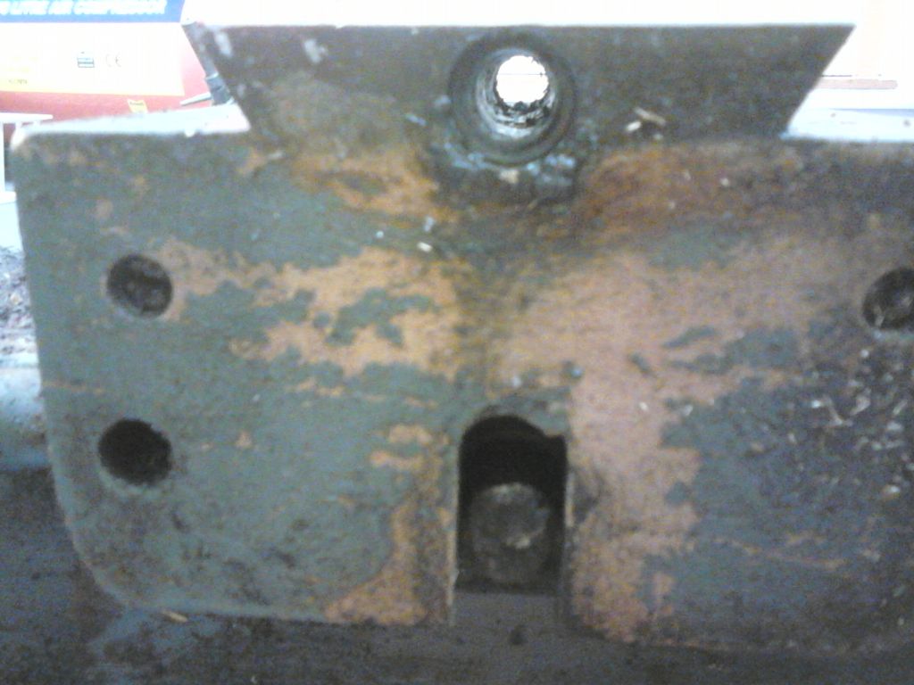

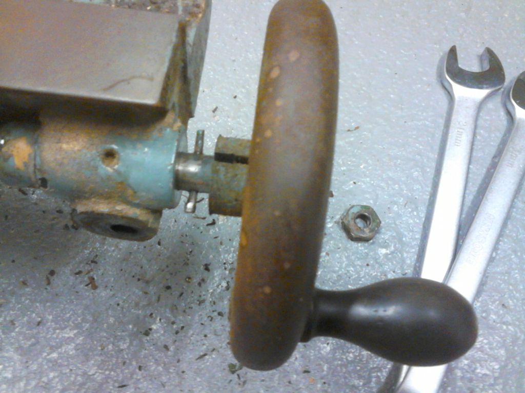

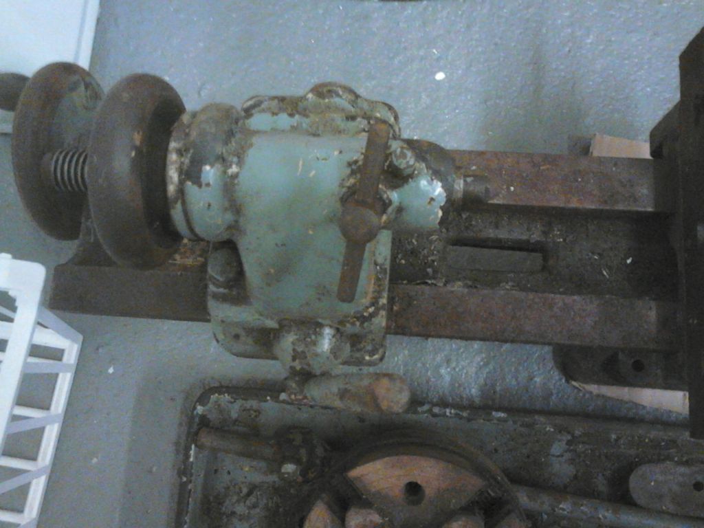

                                  dsc_0026.jpgdsc_0027.jpgHello All,
                                  Thanks for that Nobby. This afternoon I started to strip down the machine. Started removing the major sub assemblies in order to get a good look at the bed. Photograph below of bed with cross slide still in situ.
                                  So far headstock is removed and partially dismantled, spindle and bearings are out. Spindle looks to be in decent condition without any major wear. Likewise the bearings, early indications are good. Some light scoring but nothing that won't polish out. Some superficial damage to one of the threads but nothing to write home about. There was no detectable play in the bearings pre stripdown. See photograph above. Clutch sleeve removed from leadscrew.

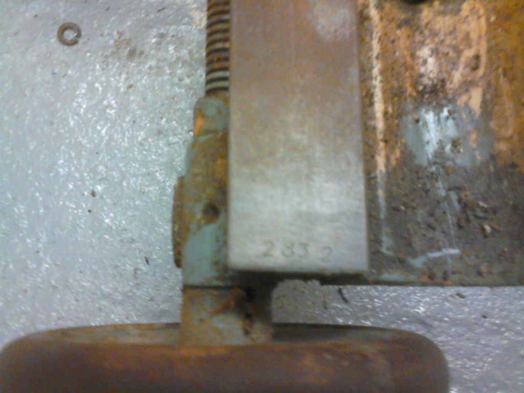

                                  Have managed to locate the elusive serial number under all the dirt. It is located at the tailstock end of the leadscrew side bed shear, just as the literature says. It is 2832 which gives a date of manufacture of 1919. So she is 5 years shy of her telegram from Her Majesty. Also photograph above.
                                  Most of the piece parts are in reasonable condition, the block that locks the bull wheel to the drive pulley is quite worn, but should be fairly straightforward to make. The thrust ring that threads onto the end of the spindle has been fairly well chewed up. Someone has used a hammer and punch to tighten it rather than a peg spanner that I assume would have been supplied with the machine when new. Again ring should be easy to make.

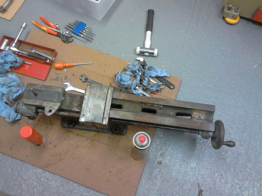

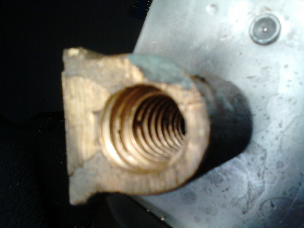

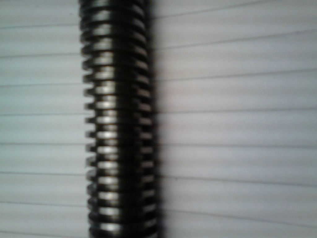

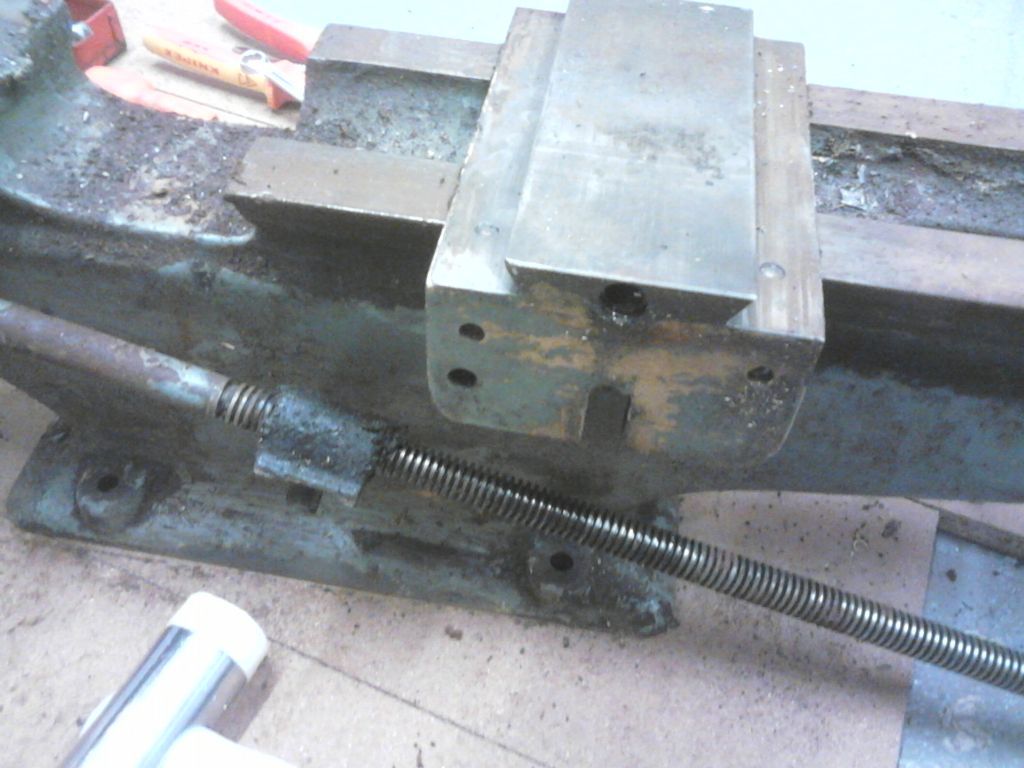

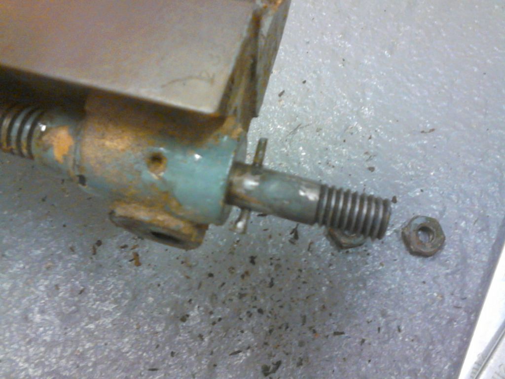

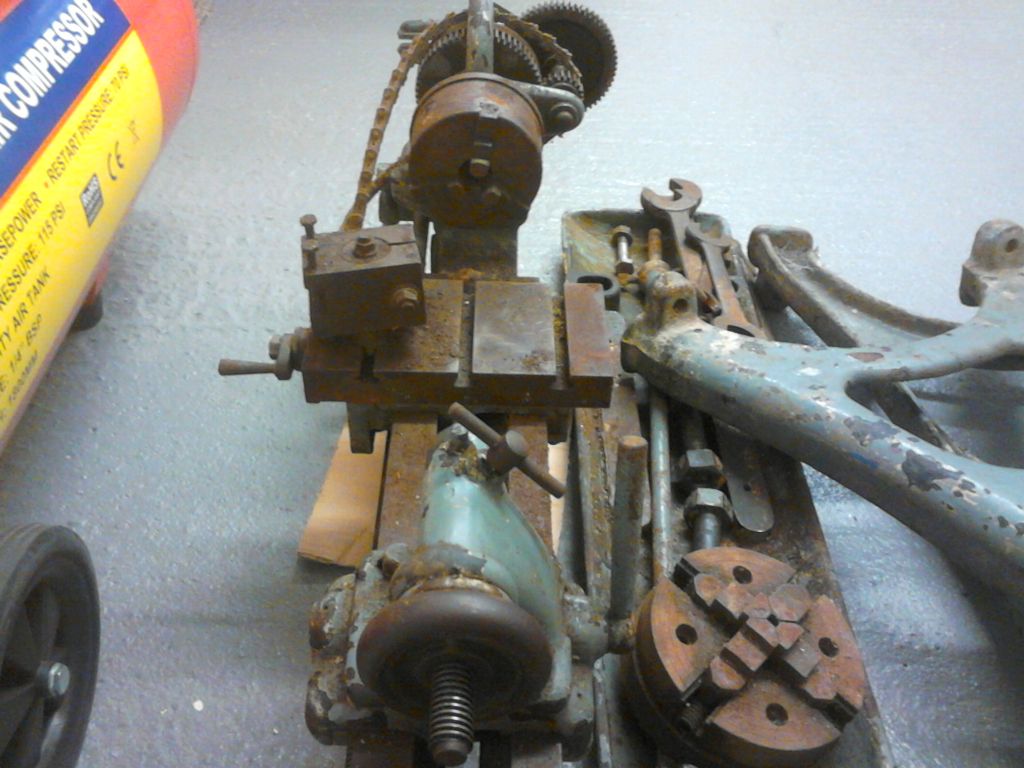

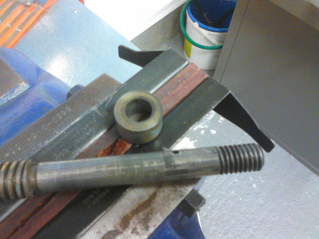

                                        dsc_0036.jpgdsc_0034.jpgdsc_0033.jpgdsc_0031.jpgdsc_0030.jpgdsc_0029.jpgHello All,
                                        Removed the leadscrew and saddle today. Leadscrew handwheel is secured by two locked nuts and transmits drive via a slot engaging a transition fit pin in the screw. Once the Handwheel was off I drove this pin out and then threaded the screw towards the headstock to gain enough clearance for removal. During this I discovered that the driving feature on the full nut – a threaded section that engages a slot in the saddle – had sheared off. It was not possible to take the leadscrew out via the tailstock end due to a transition fit collar on the screw.
                                        Once the screw was out I threaded the full not off, and it rapidly became apparent that the internal thread was very worn.
                                        After removing the transition fit collar, I gave the leadscrew a preliminary clean and it looks to be in decent condition. One thing that gives me pause is that the thread form of the leadscrew. Maybe it is just my eyes but it looks square as opposed to acme. Does this ring any bells for anyone? I had better find out as I will need to make a new nut.
                                        The next job is to clean 95 years of dirt from the bed and then see what condition the ways are in. Hopefully you can make sense of the photographs and what I have written.

                                          Leadscrew is square thread so my eyes aren't going funny.

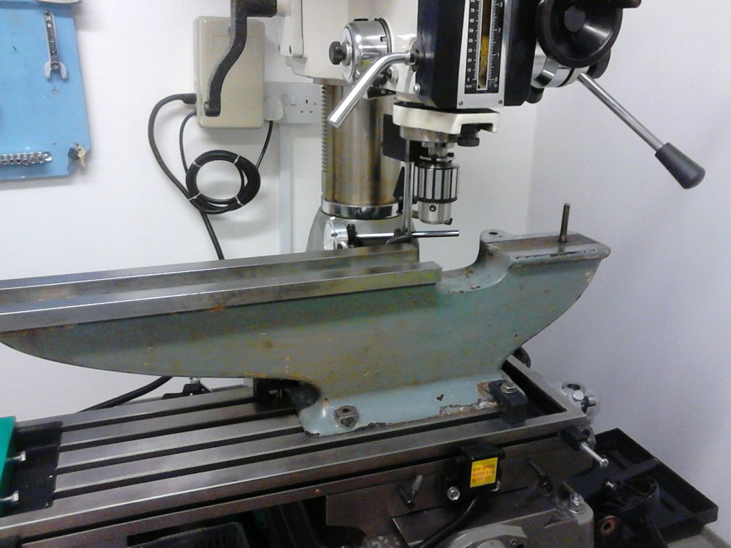

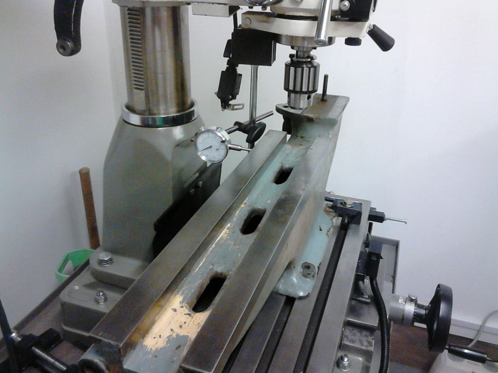

                                            Got the bed onto the table of my Chester mill/drill today. I wanted to do this to check the saddle and tailstock guiding and locating features are parallel. With the bed parallel to the table I ran a DTI along the relevant surfaces. All was well, certainly within 0.0005", which is probably as good as it ever was.
                                            To be honest, I didn't expect to find anything different, I was really just satisfying my own curiosity on the matter. The chaps on the Drummond Yahoo Group have all advised me that if they find any wear on these little machines, they by and large just live with it. It has been interesting and edifying to check this one, and to learn that despite it's long life and indifferent ownership, it is substantially fine.
                                            My mill/drill may be lacking a motor just now but it is still useful for something!dsc_0040.jpg
