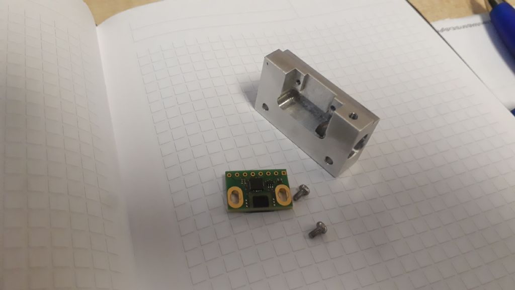

                                      #661274
                                        I would have thought a stick on magnetic strip would not overpower the Proxxon and the read heads are quite small at 10 x 15 x 35mm. A cunning engineer like yourself could probably hide the scale within the dovetails rather than mount it externally which will be what I will do on teh Lateh cross slide if I ever decide to fit a DRO to that.
                                        #661317

                                          #661321
                                          Graham Meek
                                            @grahammeek88282
                                            Posted by JasonB on 24/09/2023 13:40:53:
                                            Hi Jason,
                                            I have been pursuing this avenue but have struggled to find a small reading head. I have seen one in a YouTube video which is about 10 mm square. I have had no luck with a reply from the poster of the video.
                                            I would be grateful for information, if you know of any such reader. Also the readout to go with such a system.
                                            Regards
                                            Gray,
                                            #661408
                                            Ian P
                                              @ianp
                                              Gray
                                              The smallest read head (really small!) is to use a bare sensor and put it your own housing. Some time ago a poster here showed how he enclosed and terminated these tiny modules.
                                              I have tried searching this site but cannot find the relevant thread, the poster gave part numbers, wiring diagrams etc. I think the sensors are made and supplied by a European (Swiss?) company.
                                              I'm not sure if the one is this picture is the same but this poster 'Jed Martens' has not posted recently (if this link works!)
                                              https://www.model-engineer.co.uk/wp-content/uploads/sites/4/images/member_albums/181671/846798.jpg
                                              Ian P

                                                Ian P
                                                  @ianp
                                                  Brilliant Jason, was that from memory or searching?
                                                  Ian P
                                                  #661424
                                                    I did search for it yesterday and found it fairly quickly.
                                                    #661442
                                                    Graham Meek
                                                      @grahammeek88282
                                                      Thanks Ian P & Jason,
                                                      I recall seeing this post some time back. Unfortunately it is beyond me as regards the electronics. Plus the read head will still be too large. I have found an M-DRO Mini Head. which has a 10 x 12 mm section, but the cost of these will make the project impossible.
                                                      Thanks for taking the time out to look,
                                                      Regards
                                                      Gray,
