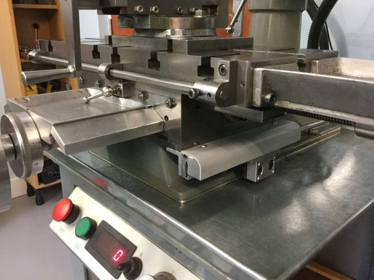

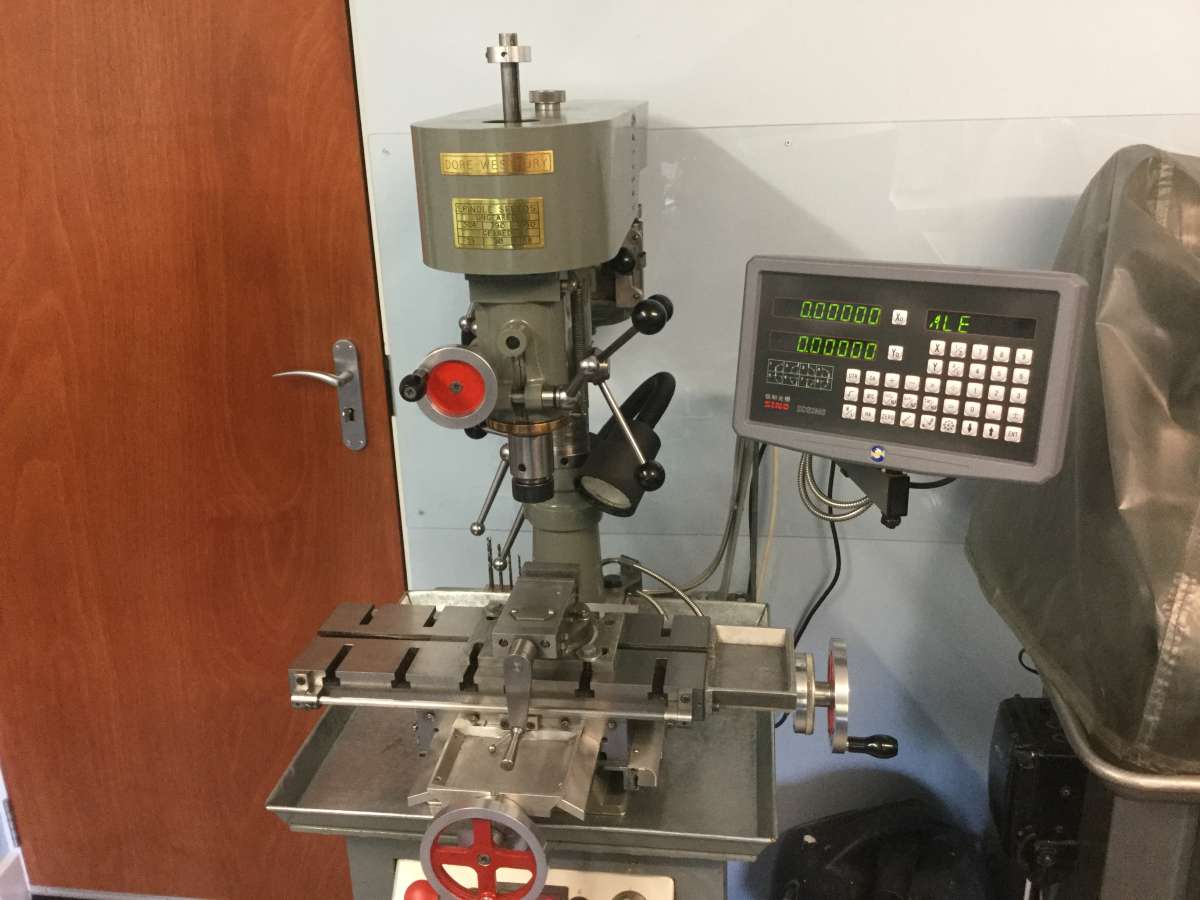

      Hi
      I wish to fit DRO to my Sharp mill and do not know what type would be best, glass, magnetic, make (not some of those Chinese ones).   Swarf and oil resistance.
      The basic details of the mill are
      X 400mm, depth of moving part 28mm, fixed 25mm
      Y 100mm less the thickness of the X scale and reader, depth of moving part 14mm
      Z 240mm, depth of moving part 25mm
      Thanks for any quidance,

        Magnetic is a bit less affected by swarf/coolant than glass.
        I’ve been happy with my Sino glass scales which must be 12-13yrs old now. I had some of the calliper type scales on before that but they did not last long and kept loosing their position. Would probably go with magnetic if I wer doing it again but they were not about at the time.

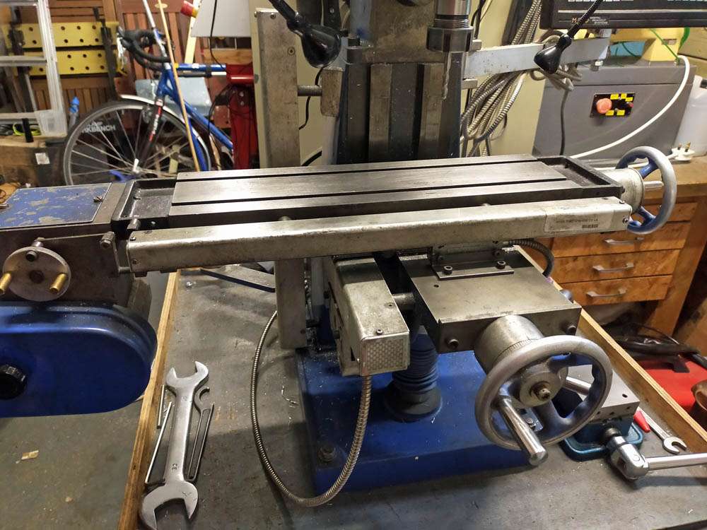

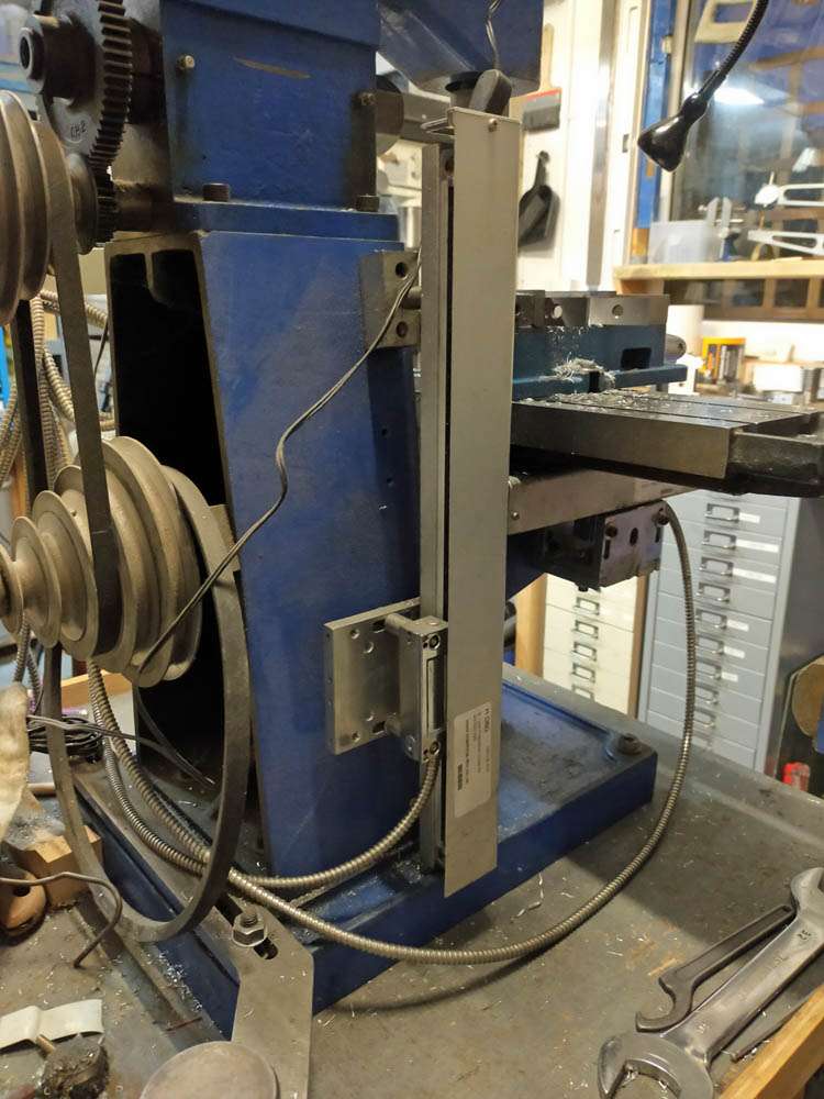

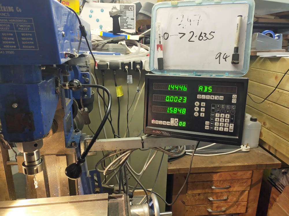

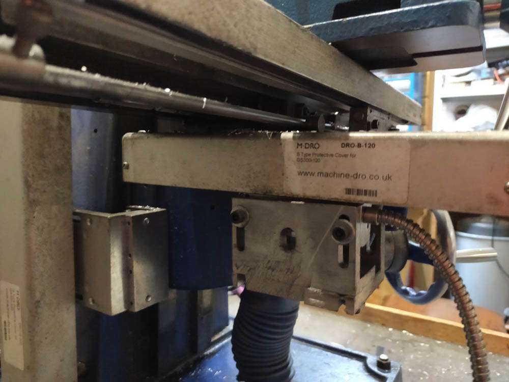

            I fitted old style glass scales to mine.  The X scale was the more expensive (at the time) low profile version to keep it below the table.  All bits from Machine DRO (Allendale).  I’m sure magnetic scales are the way to go now, as I have just fitted to my S7 lathe.
            sharp x axis1
            sharp y axis 1
            sharp z axis 1
            sharp display
            HTH,
            Rod

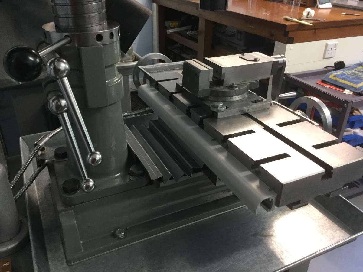

              I have magnetic on my Dore Westbury mill. The scales and reader heads are much more compact than the glass equivalents, which would have been difficult to fit on this small mill. The SINO system, which came from M-DRO, has worked faultlessly  for several years, and it has transformed the machine. My only criticism of the kit was the clunky fixing brackets. I made my own, which are much neater. There are some photos of the installation in my album.
              #728180
              Mike Crossfield
                @mikecrossfield92481
                Oops. Albums doesn’t seem to exist any more, so here are the photos of the SINO magnetic system in my mill.
                3E2C4A2C-7F86-44C6-B19F-DAA2A704395C93AF12A0-0644-40C5-87AE-5C12A04D9A2FBB60DB08-1E8E-455E-9078-161FE7B05428

                  Many thanks for your help.   The compact scales from M-DRO seem to be the right solution for me.   As expected I’ll have to make suitable support brackets.    Rod, the photos of your Sharp mill are really useful.

                    As a guide, I’ve measured the scales on my mill:
                    X 46cm
                    Y 26cm
                    Z 45cm
                    For some reason my first pic is not showing up on my tablet so here it is again (maybe!)  I fixed the X scale on the supports used for the X axis stops and manage without the stops.
                    Rod
                    sharp x axis1

                      Hi Rod,
                      That pic’ helps a lot.    The X stops are not present on my mill so I won’t need to remove them.   What I will lose is the X axis slide clamp and the ability to turn the X axis relative to the Y axis, though I have not yet thought of any particular use for this facility as its easier to clamp the work at an angle.
