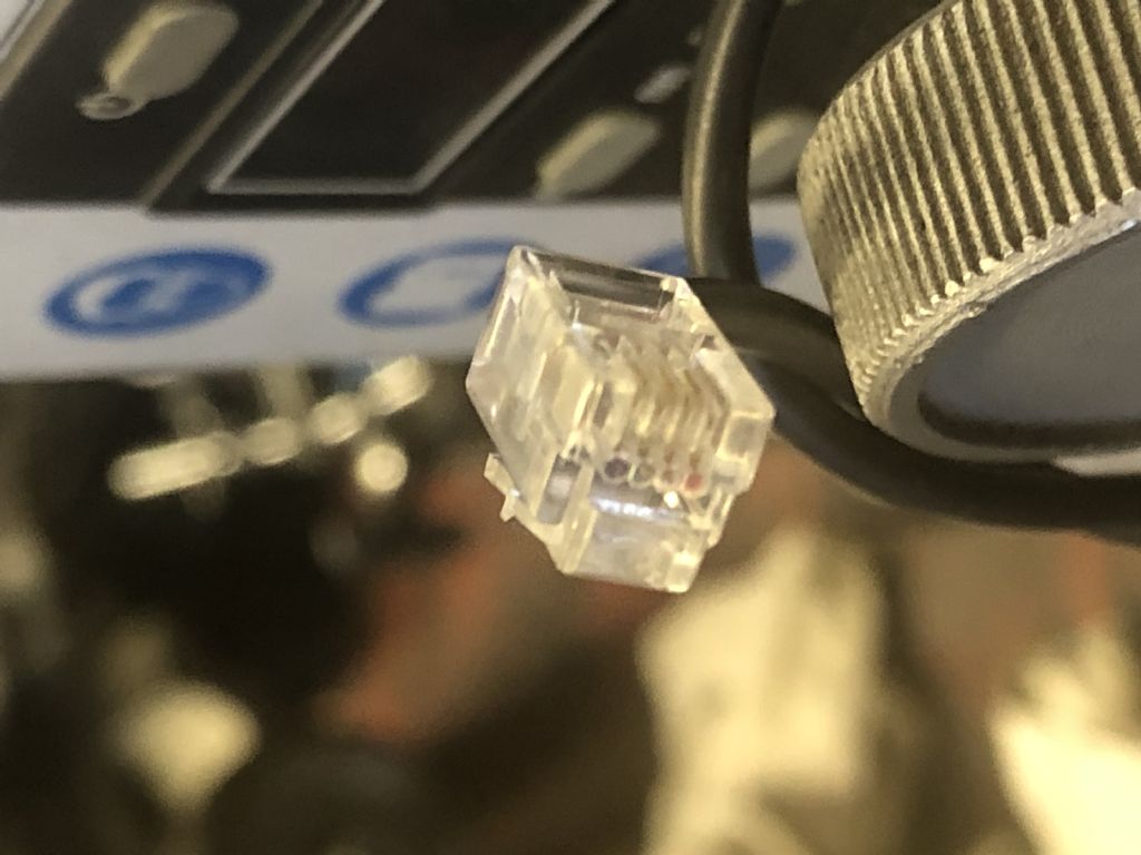

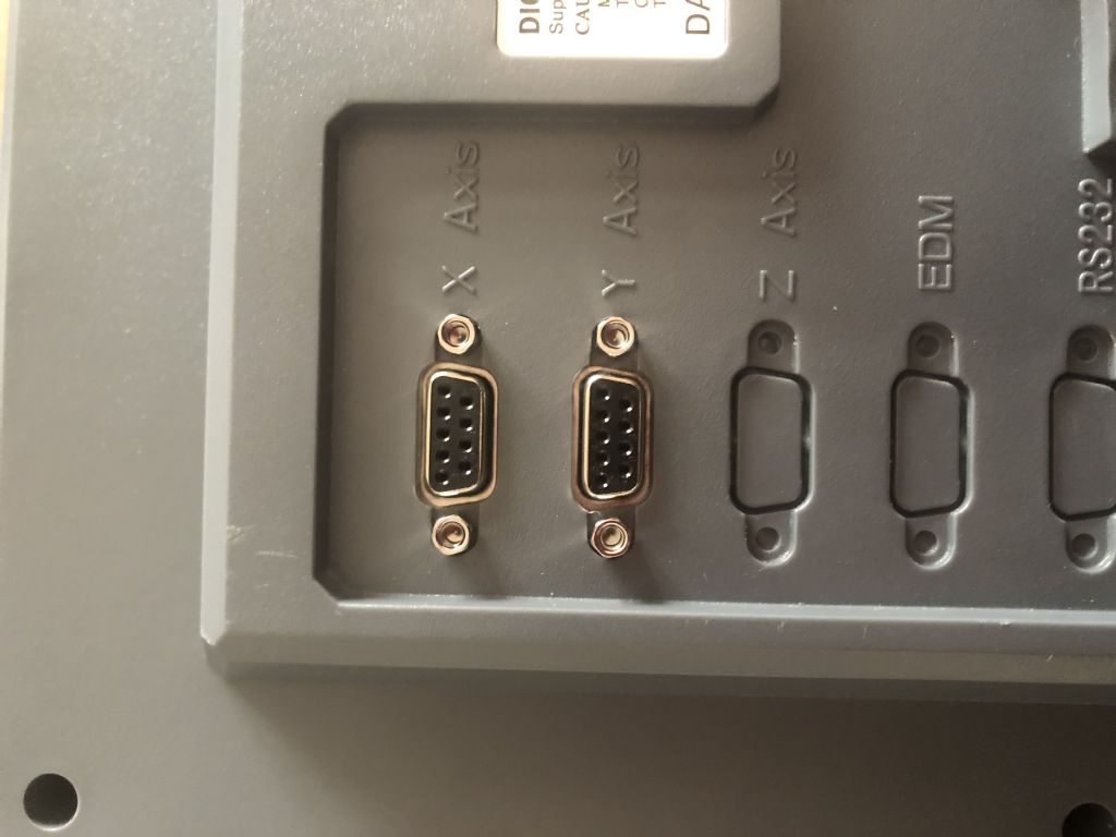

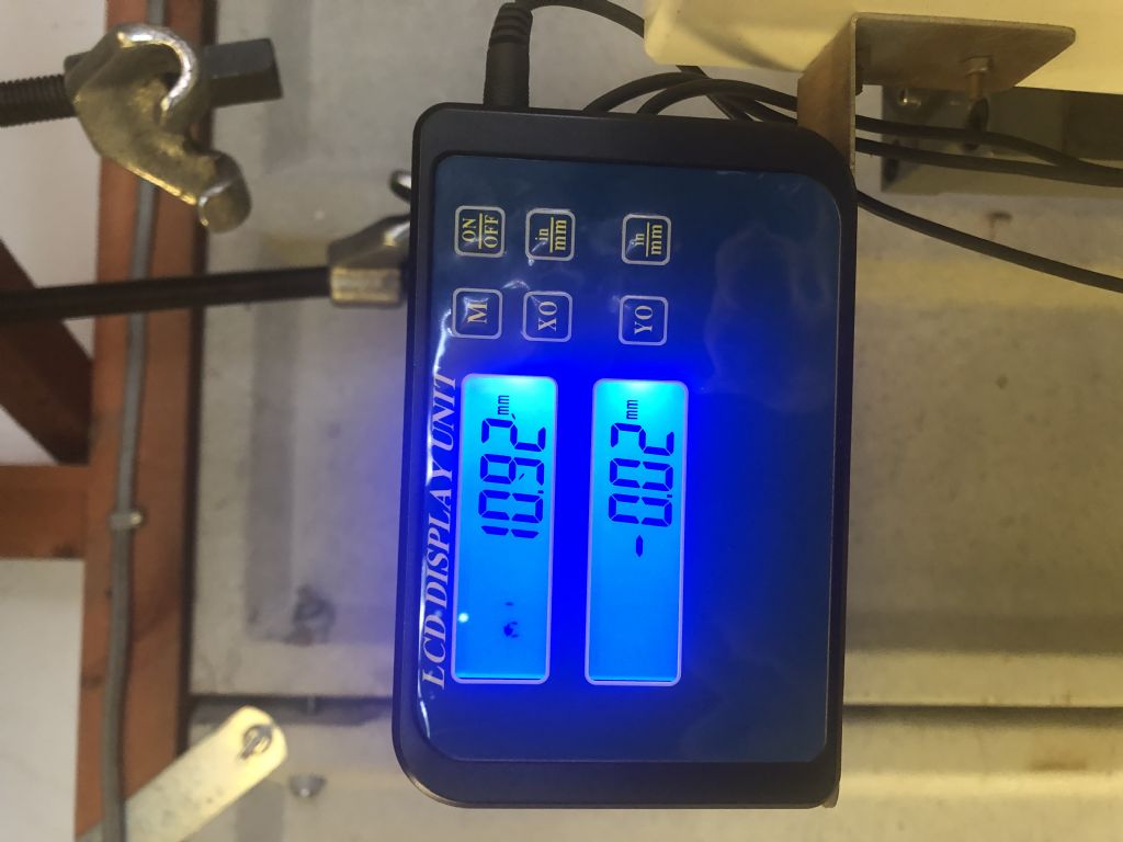

        Hi everyone, hope you are all well. I recently bought a used Chester bench top mill and I’m really pleased with it. One of the attractive parts other than the price was the fact that it had been fitted with a DRO – nice little blue thing, inexpensive but works well. I have been persuaded to purchase a larger head unit, one that’ll do various calculations, bolt rings, trigonometric calcs etc etc. But, when purchased over the internet, no mention of scale types was made. My machine has the magnetic type and I hope that it is compatible with the new head. Does anyone have any experience of swapping types on their setup? Further, there will have to be some minor butchery in the workshop as the cable that comes out of the magnetic reader terminates in an RJ-11 plug, whereas the new head requires the DB-9 interface – there is therefore an obvious question about pin outs. Again, has anybody had experience of doing this particular piece of surgery? If my eyes weren’t fading I’d leave well alone – the magnetic scales have been fitted so well by the previous owner (alas a silent key) that I am loathe to change them if I can avoid it. So any help, at all, will be gratefully received. Aye, Peter.

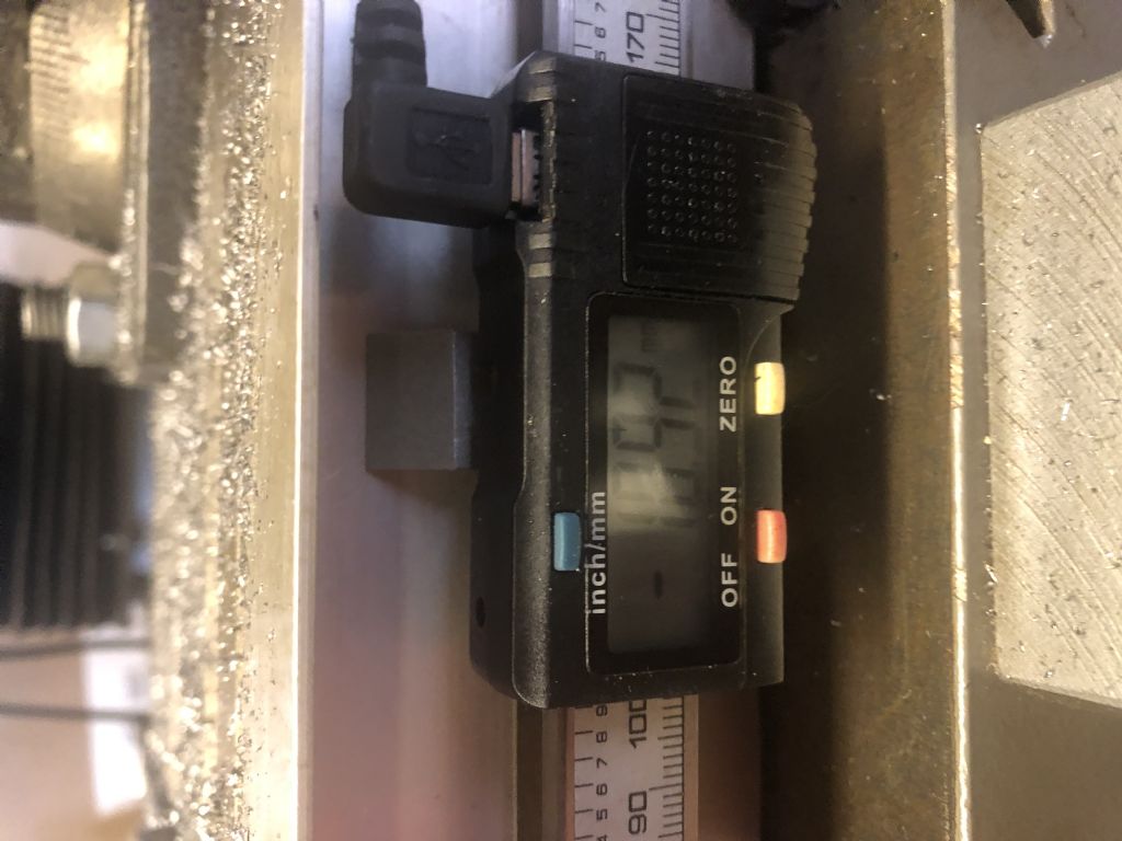

                      Hi Dave – I have the pinout for the new one out of the book that came with it. The problem is the older, existing, head – it came with no paperwork at all and hunting it down on t’internet has proved fruitless.c177779b-76f3-49d4-bc40-7d8ac8f6715e.jpeg

                        Those scales don't look like the magnetic type, if they are similar to a vernier caliper they probably are capacitive scales.

                          Chris – ah well, there you go you see. I’ve only presumed they’re magnetic type – I have seen the exact same scales on vernier callipers but if you say they’re capacitative type then I can maybe go from there. Would they not be compatible with my new DRO head then would you say?

                            The current DRO setup you have looks like the ones sold by Arceuro. I am pretty sure they are capacitive type, the same as digital calipers. In fact they look like digital calipers but fitted with an output socket.
                            Unfortunately, they won’t be compatible with your new display unit which is designed for magnetic or optical scales which have a different output format.
                            I think you have 2 options : buy new scales or return the new display unit if possible and buy or make an interface to use your existing scales with the TouchDRO app using an android tablet as the display. I have this system on my mini lathe and on my mill. They both use diy interface circuits I made myself. I have used modified Lidl digital calipers on the mini lathe and Arceuro scales on my mill (though they are different to the ones you have).

                              I agree with chrisB that your scales are the capacitive type and they will not work most display units as most of them expect quadrature signals which most glass(Optical) and magnetic scales provide. To make things more complicated there are a number of different protocols used with capacitive scales. There is one DIY design that works with some types of capacitive scales. This is a link to it.
