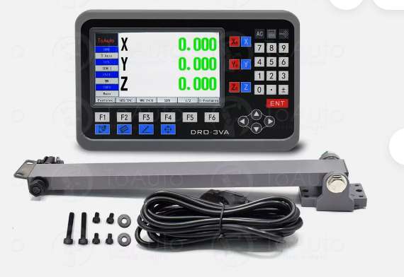

                                                    These are the ones I use and they are much better and only a few quid more. Ebay £125.
                                                    dro for model engineer
                                                    I could’t find the 2 axis dro to buy at the time so I just used the 3 axis on my lathe. Sold my old ones on Facebook Market place for £45 each. You can use them on either anyway it’s only to press F1 and scroll down to the setting for diameter rather than radius. I take a first cut, measure with a mic or whatever and enter the diameter. Then just turn to within .025mm and measure for the final size. Job done.
