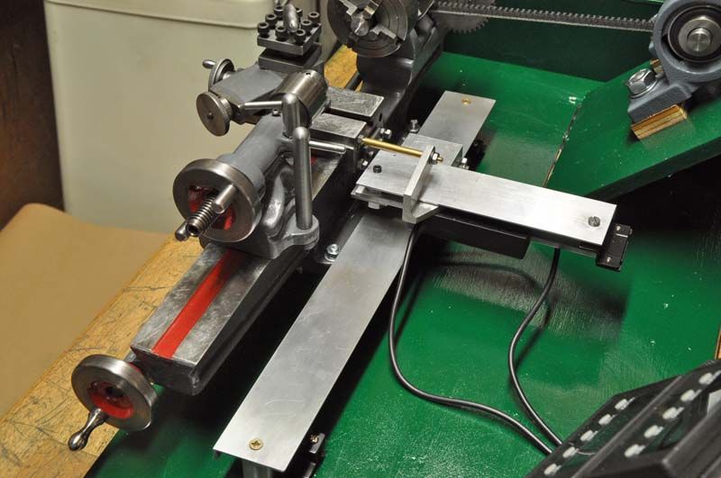

                I fitted DRO's this weekend past and used magnetic scales. My mill like the WM is a small one and fitting them was a breeze and can be cut very easily to the exact length required. But the main reason I went for magnetic ones is there small profile so I would not loose any of the machines capacity. They also do not require any additional protection in the way of coolant and swarf guards further adding to small profile.

                                        I have fitted similar remote display to several others, mine was from Warco, I used simple aluminium u-channel to protect them from coolant and swarf. I don't think I have had to replace the battery in the scales often, but I know when I need to as the display will jump 0.200". If I was fitting scales again and could afford it I would go for a more up-market option with more facilities, in particular the PCD and half/centre options.
