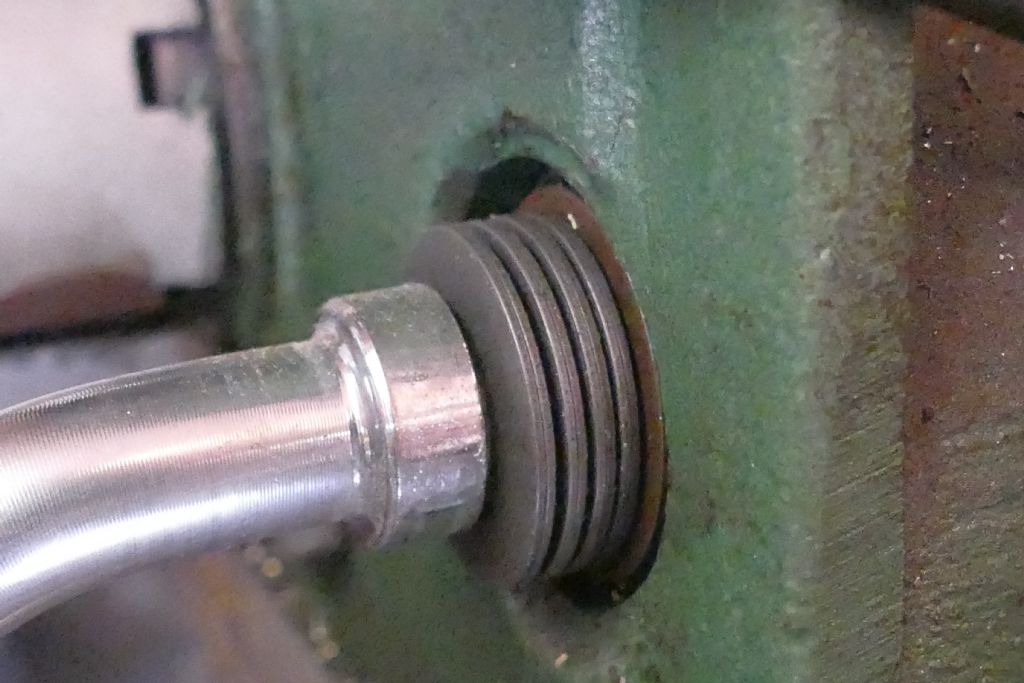

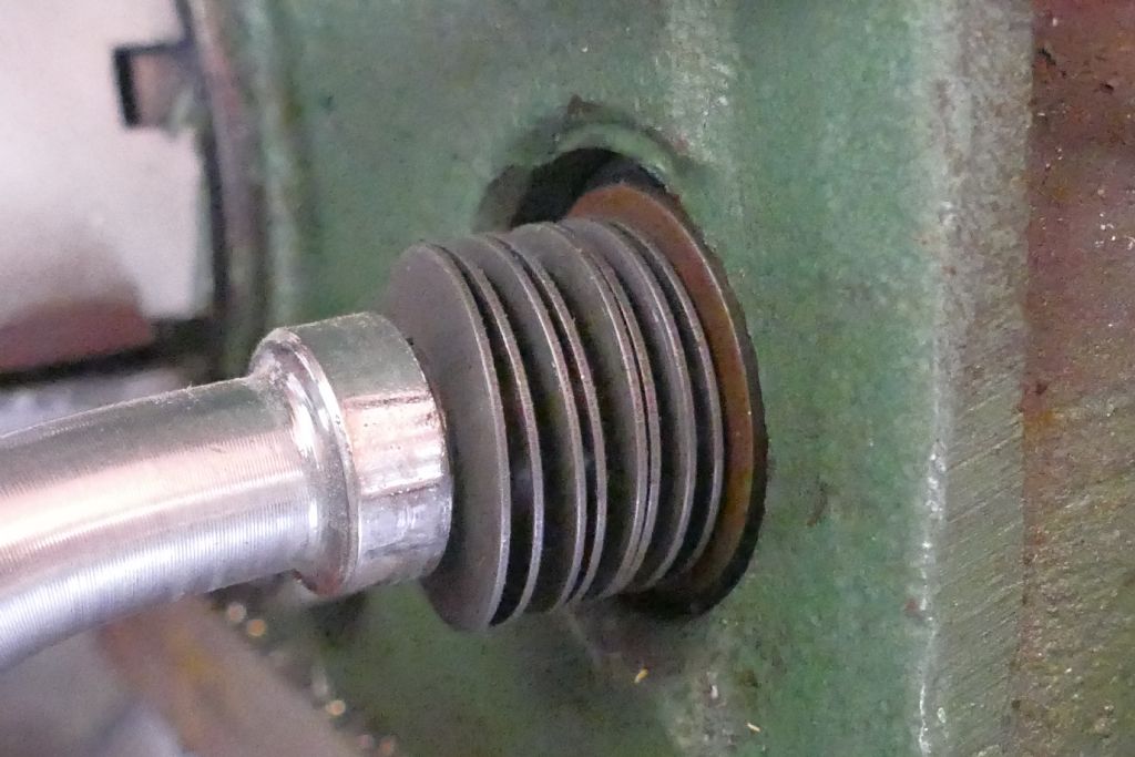

    Martin Connelly
      @martinconnelly55370
      I added some disc springs to my clamp lever.
      These are 25×12.2×0.7 disc springs, 8 of them with alternating direction of their conical shape. The top picture shows the lever backed off and the bottom picture shows the normal position with the springs compressed to give a constant pressure and drag on the quill to give repeatable and predictable movement. I put the disc springs in the chuck on my lathe, held in the grooves in the standard jaws, to drill them out to 1/2" bore turning the chuck by hand. You can still clamp the quill up solidly when required.
      Martin C

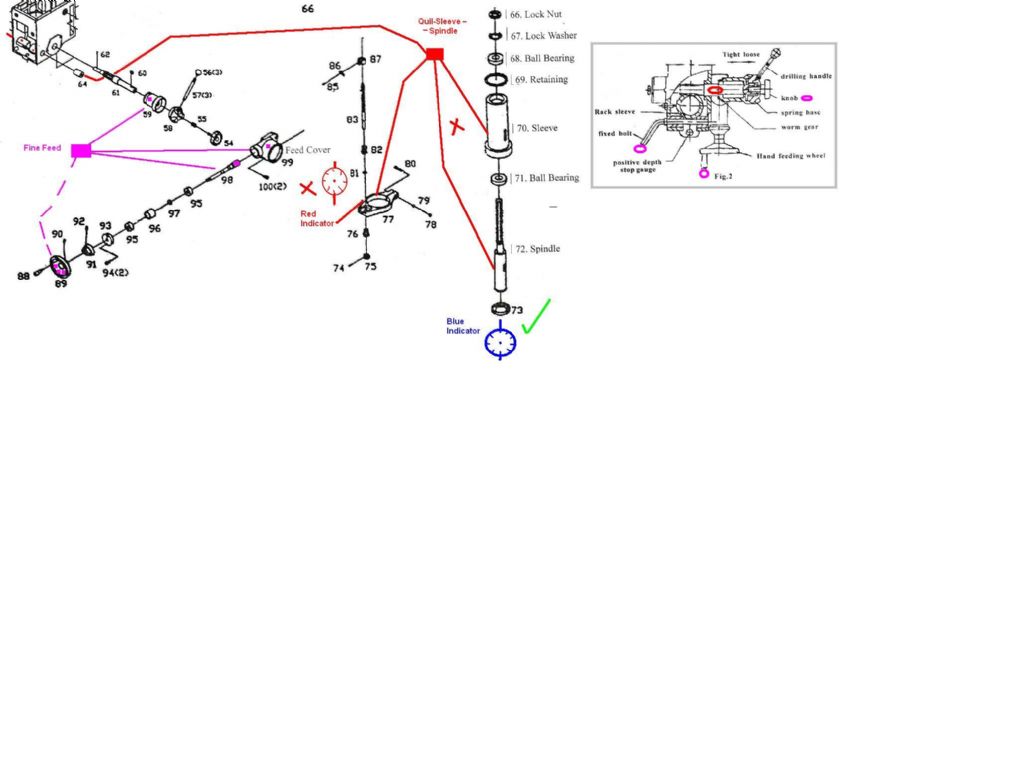

            From manual:
            #591415
              I can understand some movement of the red DTI as the quill clamp is locked and unlocked and also some backlash in the quill rack.
              But don't see how you are getting different vertical readings for the spindle with the blue dti unless there is excess end float in the spindle.

                My problem is all about locking the quil, to Mill by using the Fine Feed.
                Jason B, the blue indicator do not move if I lock the quil, this one is stable, however when actually milling, I of course cannot use this one, its in the way. "The spindle do not see the problem" If I could have tapped measurement the centre of the spindle, I would have had no problem.
                So I have to use the red indicator(From Quil)……I find a way around the problem.

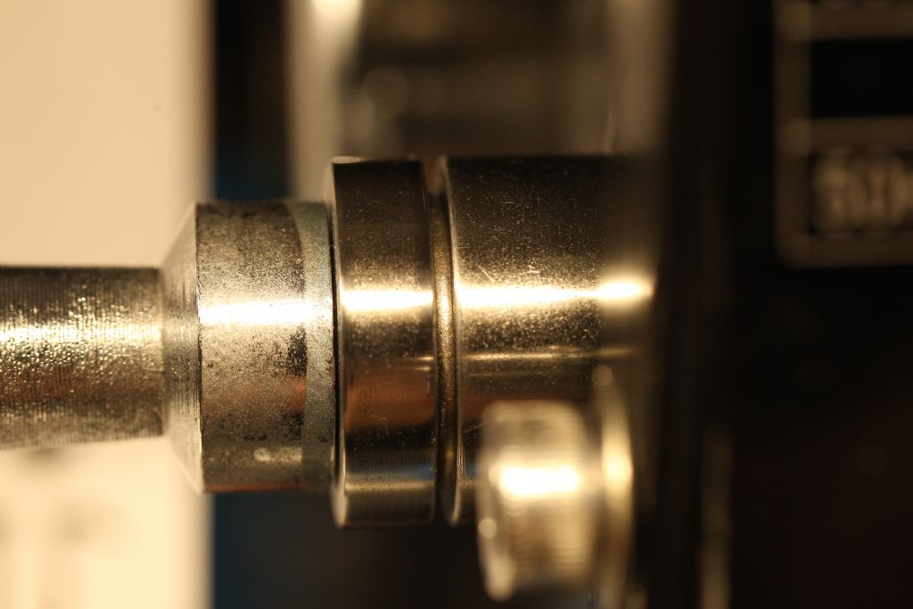

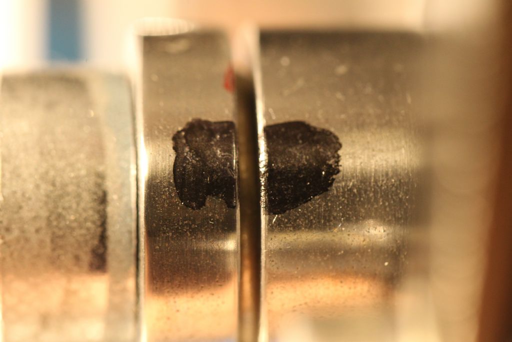

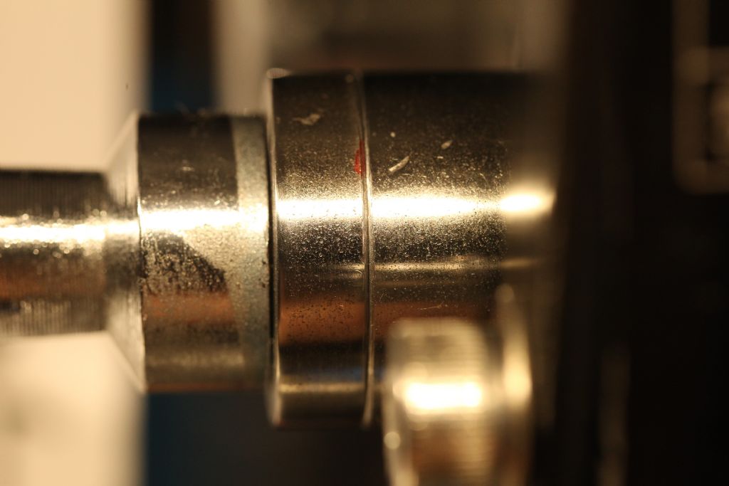

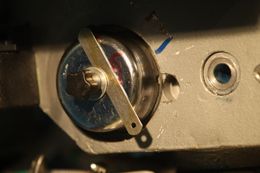

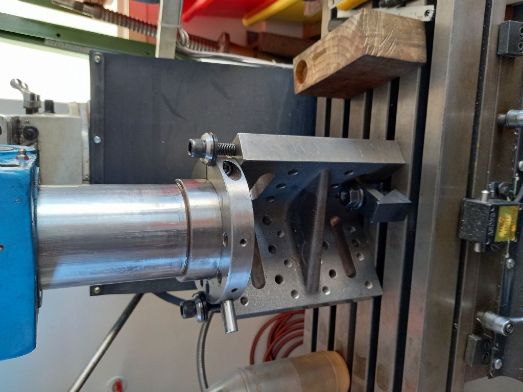

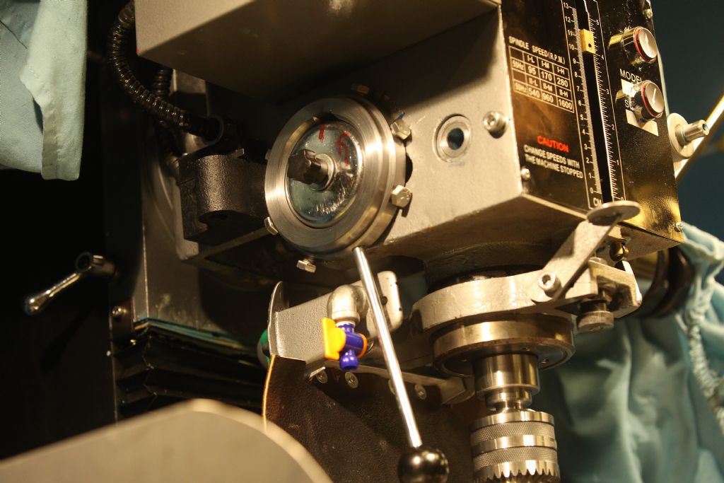

                                    I added photos to explain some parts made & used:
                                    1-I added positive tention to quil spring, made tool.
                                      -I prevent quil spring cap being jammed by tightning bolt.
                                    2-I added preload before quil lock to prevent dial indicator give false readings.
                                    3-I am now happy with this on my mill.

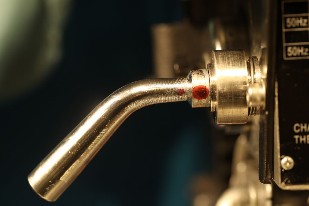

                                    #592275
                                    Jon
                                      @jon
                                      Same Lux head as mine but my quill casting wore 14 years ago oval. Last time measured was around 0.6mm. I drilled and tapped M5 round the lower casting to put pressure on quill in desired direction. The lock pushes quill rearwards.
                                      Seen and proved loads of errors on others caused by using the depth stop to move any scale, theres always play but its very easy to do that way.
                                      #592737
                                      Chris Mate
                                        @chrismate31303

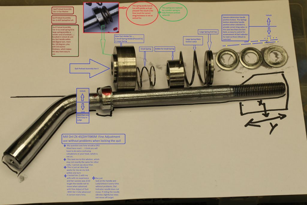

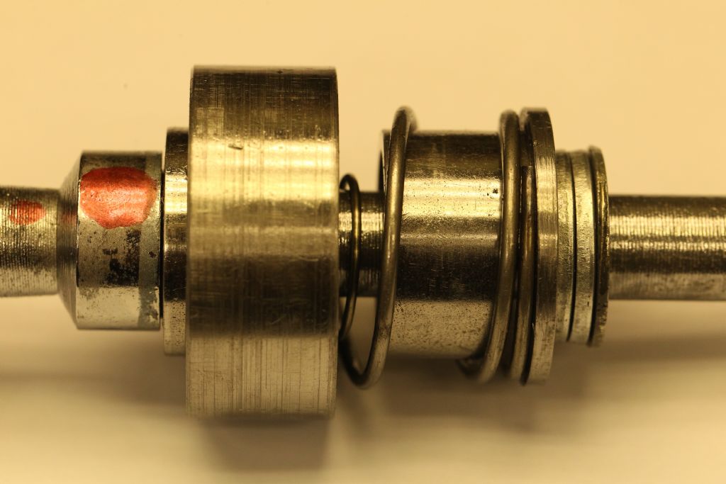

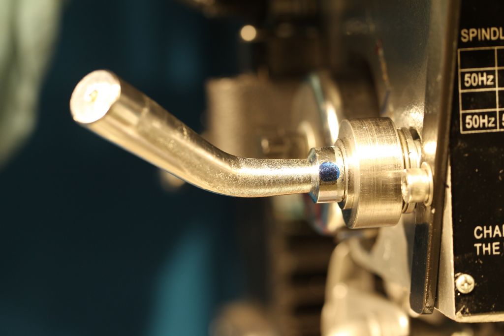

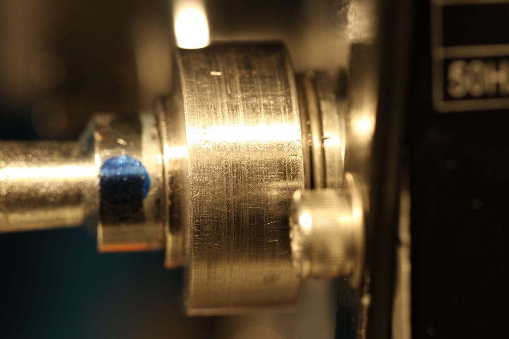

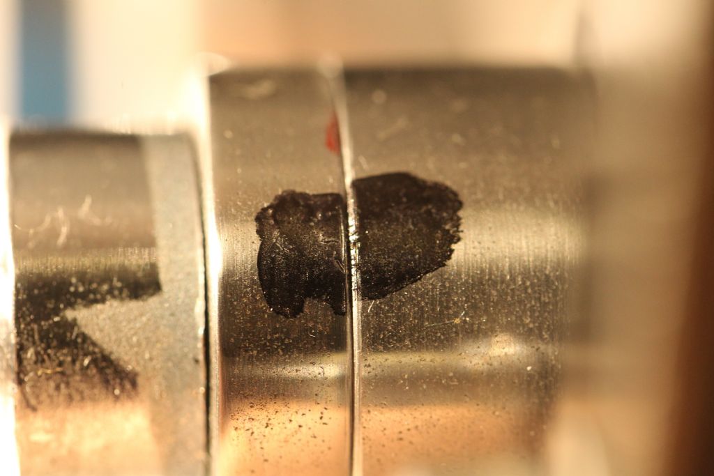

                                        Mill Drill Quil Lock used with Fine Adjust provided on ZX-45[ZAY7045M] mill(New).
                                        When Quil is locked the Dial Indicator needle deflects, a DRO here would probably not work well as a result.
                                        Ver-1=A tap washer was used…..It worked but….
                                        Ver-2=A stiff spring was used, but after I tested it with my wife with no mechanical experience, she was only 2/10 times successfull advancing the quil down 0.1mm without deflecting needle. I then realise the stiff spring was giving a too narrow band of tention to judge the drag applied before Locking the Quil without understanding how it works.
                                        Ver-3=So I relook the effort and decided to use two weaker springs which gave a much wider flatter tention range that was enough before Locking the Quil and I could Lock/Unlock with the handle with in one turn, within 380 degrees, so now you look at the handle position, and you know instantly where Lock & Unlock position is.
                                        The 3x washers can be played around for 1-Needed gap, 2-For determining the Quil Lock position.
                                        My wife could repeat every time with this effort without the needle moving after Lock applied.
                                        So here are the pictures for those that might be interested:
