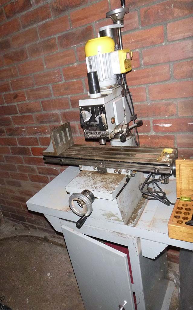

      What option do I have for a 3 axis dro for this milling machine:
      Some else on this forum has a similar machine Emco I believe who fitted a DRO, would be interested in speaking to his to see how easy it was to fit

          It would help to know your budget. Will you be able to stretch to glass/magnetic scales and a full function didplay or are you limited to the calliper type scales with separate readouts and no fancy functions.
          X&Y should not be too hard, the Z scale will need a bit more thinking about.

              the x & y axis is straight forward
              but I don't see how you could fit the z axis to the swivel head ??, unless you of course just have it fixed
              as for scales I would buy glass scales, that's my preference,
              when you do fit the scales, fit the scales at the front, on the table, will give you more room
              either way enjoy fitting them, and don't bother using the hardware supplied, make your own, its easier and quicker

                          There is a similar Emco machine with X&Y scales fitted half way down this US suppliers site to give an idea of how to fix them
                          I would suggest keeping the Y axis at the back so you can still easily use the stops on the front of the table provided the is room when the table is fully away from you

                              You can mount the Z axis quite easily. Did this years ago with an Ortec DRO system on the FB2.
                              Remove the top and bottom column key bolts. Replace them with home made studs with extended heads to act as stand offs so that the scale when fitted to these will clear the column clamp. The top of the stand offs will need to be tapped for the scale securing screws. If you have a scale protector, this can be drilled for the correct spacing of the modified bolts.
                              The read head can be fitted to the column clamp plate using an adapter plate and using the existing holes in the machine.
