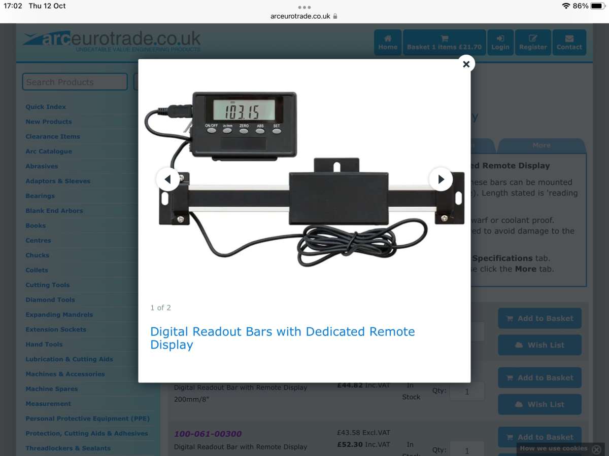

      I have an Amadeal AMAT 210V mini lathe 8″ x 16″ and I am looking for a 2 axis DRO which uses ‘slim linear scales’ but ideally has a nice big bright readout.
      I bought the lathe used and it came with ‘slim scales’ fitted which have micro USB connectors on the ends of the cables which fit to small individual LCD readouts (the read out seems quite popular and looks a bit like small temperature readout/timer module etc) The issue is that the scale cabling has become damaged (it wasn’t well protected) and I find the read outs not great to read so in replacing this I would like a bigger display, but due to the size of the lathe I think it would be good/essential to keep the linear scales the same slim profile.
      I have recently fitted a decent enough 3 axis DRO set up to my Seig SX2 Mini mill and whilst the shrouded linear scales fit, they are a bit clunky for the small machine. I have held the same scales up against my lathe and I cannot see how these units would fit my cross slide without causing significant obstruction.
      I am struggling to find a suitable device to fit my lathe, I guess that lots of people have fitted DROs to their mini lathes, I would be grateful for your advice.

        Think about magnetic scales, you might even be able to stick the magnetic tape onto the existing bars, small read heads are smaller than what it sounds like you already have and they plug into the proper big DRO consoles with all the bells and whistles

          Thank you @JasonB this looks like what I need. I can see that the separate sensors have ‘D’ connectors for connection to the larger display units, so that ‘s ‘a tick’, although I am unsure how the sensor tape is applied.
          Given that my current sensors are magnetic I assume that I cannot just apply the new tape to the old strip, they would interfere I guess.
          Also I have just noticed that buying all of the bits separately like this makes it quite a bit more expensive :0(
