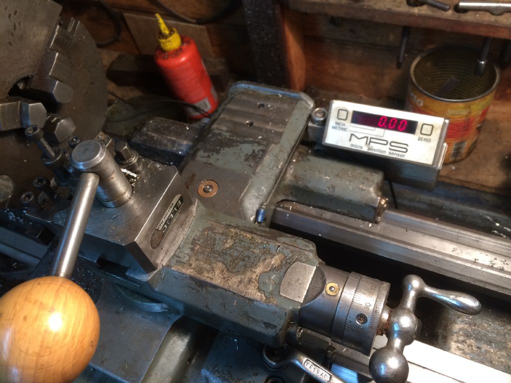

                                            Today, I moved the RW Electronics MPS DRO from the mill to the Boxford AUD lathe. The DRO is a 'pull wire' system which has seen me good for the last 18 years or so on the milling machine, but as I hope to install a different system on the mill, the MPS 'came free'.

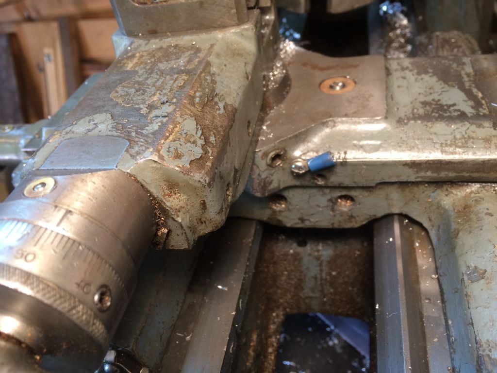

                                            I didn't want to extensively modify the Boxford or spend too much time installing it. At the rear of the saddle, there are two un machined pads that would take a couple of 2BA bolts to mount a bracket onto, but as I have no access to the rear of the lathe, I removed the saddle by removing the rear slideway locking plate, the front saddle lock screw, the Thread indicator and the 2 hex cap screws that attach the saddle gearbox. This leaves all the leadscrew, feed gears etc in place without disturbance.
                                            As accuracy isn't an issue, I drilled the two holes with a battery drill and tapped 2BA. At the same time, I drilled and tapped a 6BA hole adjacent to the Topslide Locking grub screw which the free end of the MPS wire would attach too. Again, nothing fancy and did it by eye.

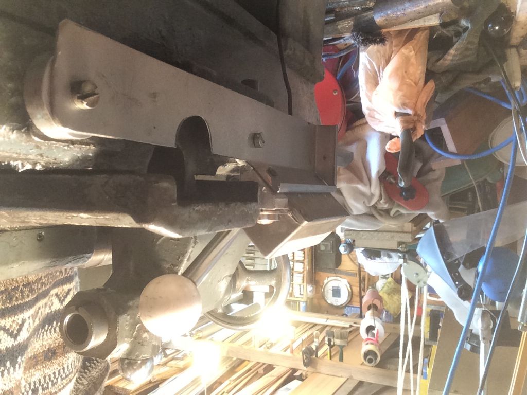

                                            I folded up a bit of 16 SWG plate to make the bracket for the MPS, drilled it to suit the centres of the 2BA screws and a couple of 1/8" diameter holes to suit the existing cover holes of the MPS.
                                            I re-installed the saddle and fiddled to get the saddle lock screw back in.
                                            My first attempt on mounting it all together showed that the tailstock lever fouled the readout, so I turned up a couple of spacers about 5/16" thick to place between the rear of the saddle and the mounting bracket.

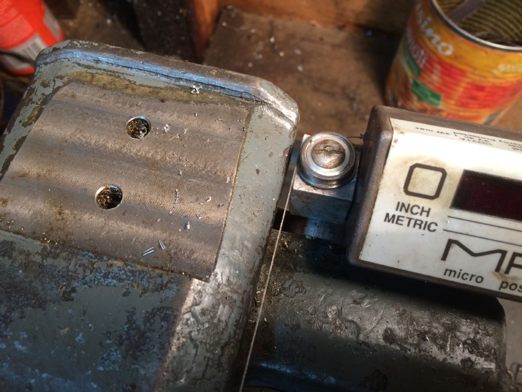

                                            The pull wire needed a pulley to change the direction of the axis of the wire. Lucky to have a small shouldered bearing in the come in handy box, machined a block of Al alloy to mount the bearing onto and then superglued the bearing block onto the bracket.
                                            And that was about it ! A bit of electrical work to take a 9volt supply from the existing RPM display.
                                            These modifications still allow use of the travelling steady and full use of the gib screws and minimum fouling of the tailstock / saddle.
                                            Finished job showing the line of the 'pull wire' and blue crimp connector at the free end
                                            Bearing and mounting block

                                            Free end of the pull wire and blue crimp connector held by a 6BA screw
                                            Upside down photo of the mounting bracket – perhaps a bit flimsy, but it seems to do the job. Note cutout to clear cross feed screw and nut.
