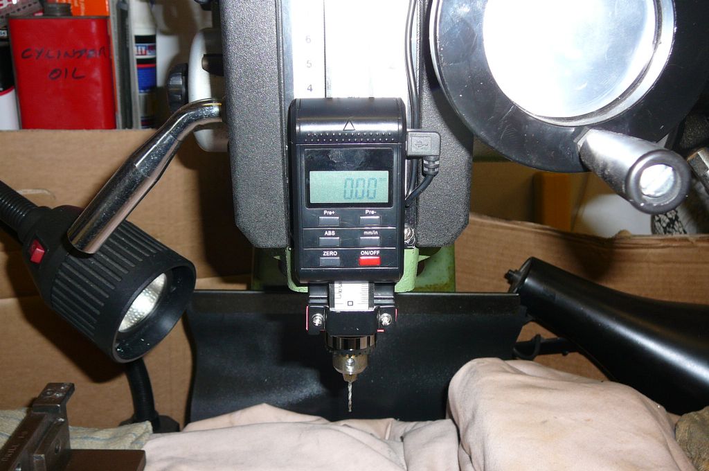

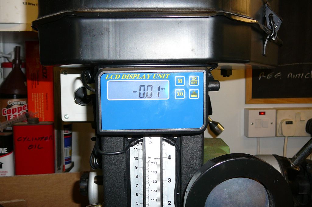

      After my original Z axis readout died on my mill/drill I fitted a new 6" vertical scale and a remote display as the scale display was rather hard to see where it's sited.
      I found that when switched on the remote display powered the read out so I dispensed with the battery however the display now 'drifts'. You can zero it, turn your back and it's changed, re-zero it turn your back changes again!
      I initially thought it was binding somehow but that's not the case. If I replace the battery in the readout the drifting stops. Now that's all well and good but with everything switched off any accidental movement of the quill switches on the readout for X number of minutes and eventually the battery drains and starts to drift again without you realising.
      I was wondering if anyone had come across this or had any ideas of a fix/workaround.

                          Thanks for all the replies and advice. I put a meter across the battery terminals and get 1.2v so the remote is putting out a voltage across the battery so that's coming out, strange that there was no mention of this with the remote displays instructions.
                          As general consensus is to put a capacitor across the battery terminals that's what I'm going to try first (I think I have a bag of mixed ceramics hidden somewhere that I couldn't bring myself to throw away)
                          I'll let you know how it goes.

                                  The scale takes a single 3v 2032 cell. The voltage at the scale terminals is 1.7v regardless of the display being on or off. As the display can be powered by batteries or external power I've removed the external psu from the equation by fitting batteries, 2x AAA, to the display with the same result.
                                  I did fit a 200nF tantalum cap across the scale terminals last night but that didn't make any difference. I have got a few electrolytics but at much higher values but I don't know if that's worth a try?
                                  Hopefully there should be a couple of pictures below, if not they'll be in my album.

                                                Right, I've isolated it to the scale. If I yank out the 'usb' display cable the scale stays powered up for roughly 8 secs during which it still fluctuates.
                                                I've tried various size electrolytics across the battery terminals but it doesn't make any difference.
                                                I wonder what quality a 2032 cell has that causes the display to be stable? I might stick a resistor in the circuit out of interest.
                                                I've got to the stage where I'm not so much worried about fixing it as to more intrigued why it's not working properly!
