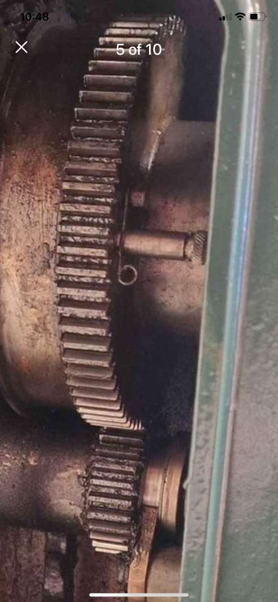

          Paul Radford
            @paulradford79614
            Great thank you Chris! Whilst you’re here- don’t suppose you know where I can get another of these spring clips from do you? IMG_0886

            Chris Crew
              @chriscrew66644
              Sadly, I don’t think TS spares are available any longer but as long as the spring clip holds the back-gear drive pin in or out engagement it doesn’t need all that much tension, although I would agree it’s not a very good design in the first place. Denford’s used to supply spares just after TS went out of business but I think that even they are now long gone or absorbed into Boxford who now, as I understand it, only produce laser CNC machines and software.

              Nigel Graham 2
                @nigelgraham2
                On any conventional Vee-belt you should be able to push the middle of it in with light finger-pressure. On some machines the tensioner has a spring designed to give the correct tension, but if not about half-inch depression on about a foot of belt seems about right. They should never be bar tight.
                The clip is most likely a “special”, made for the machine, but from its appearance it does not seem something too hard to make from spring wire or strip if need be.

                    Howard Lewis
                      @howardlewis46836
                      Could you make the spring clip from piano wire of the correct gauge?
