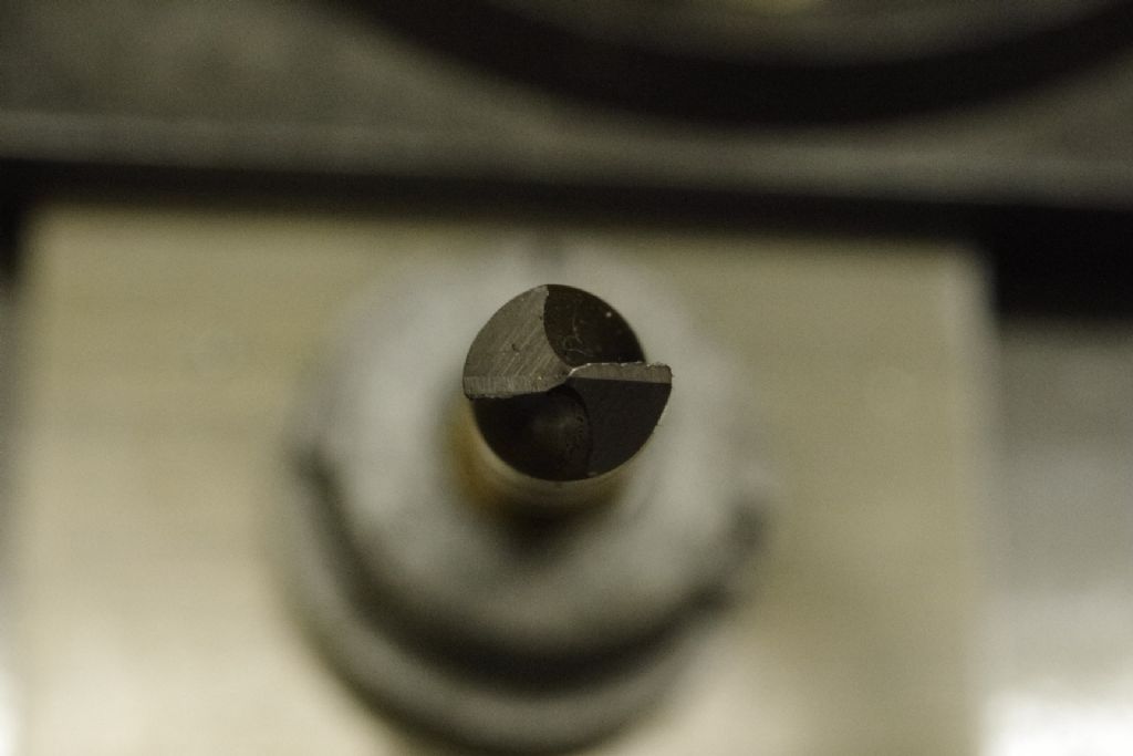

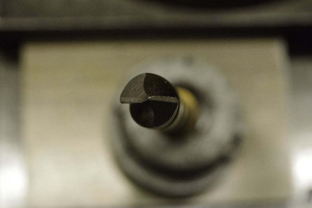

                              I will try to remember to take a photo of a drill tip which has been backed off, tomorrow.

                                  _igp2455.jpgI have a couple of pictures of a drill bit that has been backed off, it needs sharpening.

                                    Blowlamp, your drill on the left is a split point, not a special brass/ bronze one. The relief angle is the same as the one on the right.

                                      I mostly use split point and don't get a problem in bronze or brass, never stoned a drill bit.
                                      That photo of a backed off one is not like most I have seen where the face is stoned to near vertical which is like using a zero top rake lathe tool.

                                        Stoning the face that way has a similar effect. I think the op's problems stem from trying to feed too fast.
