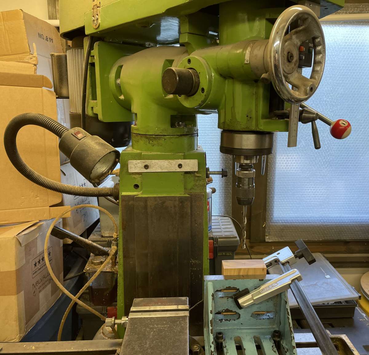

      Not as good as my old Omnimill but the rotating head on my VMC comes in really handy at times when you need to put a hole in the end of a long item. Apologies in advance for those distressed by the sight of the brown stuff (wood) being attacked on a milling machine. 🤣

        Perfectly acceptable technique, I’ve done it a few times over the years.

          Yes, that’s a perfectly viable and common method for end-machining long items.
          The problem with bio-metal is not the milling and drilling.
          The problem is cleaning all the powdery swarf out afterwards! It is not good for the machine.

            I used mine to full depth cut a 30mm diameter channel to seat an air rifle action in a custom walnut stock.
            power feed and proper clamping made it way less sketchy than it would have been with my router.

              I have used the 12 x 24 Atlas lathe to turn a length of wood which was too long for the S & B model A. And a mill makes precision drilling of wood much easier than a pillar drill.
