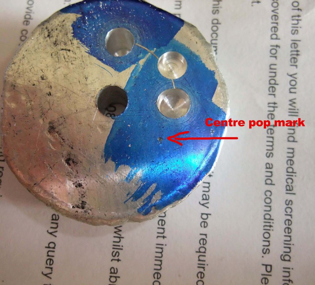

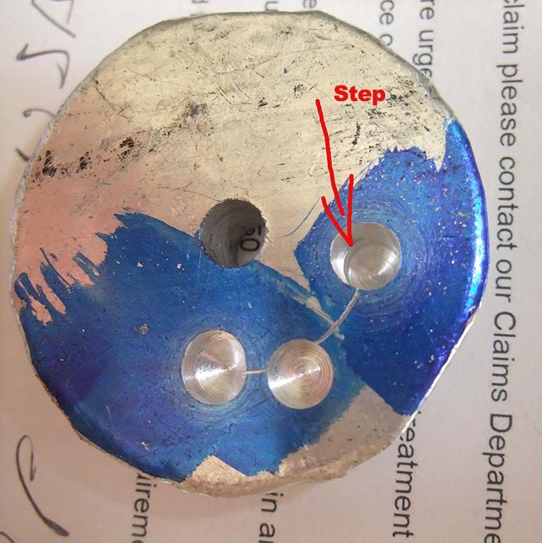

      I have notices when I use a mill to drill a partial hole and then chage to a drill the drill is off ctr and vica vera.
      This photos shows a puch mark done with the drill chuck and then the mill chuck and as you can see the mark is in the same position.
      However I then drilled a 6mm hole, remove the chuck and fitted the collet chuck and as you can see in the second photo there is a step.  The table has not been moved
      Any idea why?

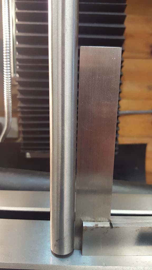

                  Is the spindle at 90 degrees to the table? If not you will get the error you describe [if I understand you correctly].

                      As Tony says it sounds like a tram issue, as the head/quill will be nearer the work when using a short milling cutter rather than a longer drill the error will show the result you are getting

                            Tony and Jason, good point, I have a ground shaft that I can use to check the head is 90deg to the table.

                                  Hi Petro1head,
                                  An easy way to check the tram is with a DTI at right angles to the chuck as shown in the picture.
                                  By swinging the DTI round in a circle on the table top, you can measure how far the head and table are out, right/left and forward/back. The DTI being on an arm means you can see tilt of 0.01mm over a distance of 200mm quite easily.

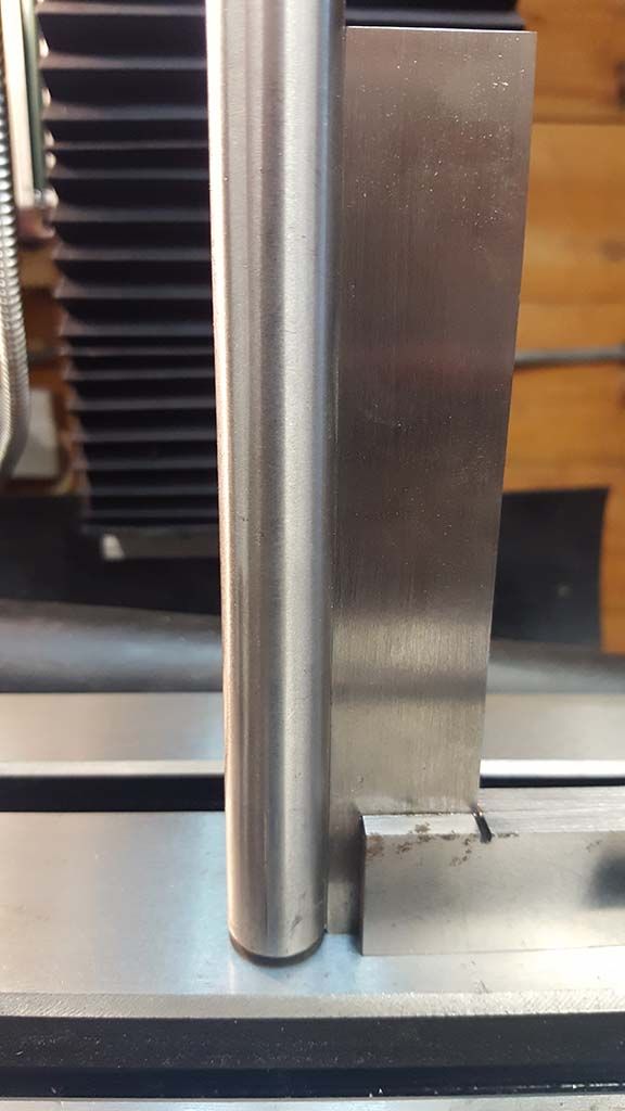

                                    You guys were right, I am such a duffer
                                    Not as technical as a dial guage
                                    Before
                                    After
