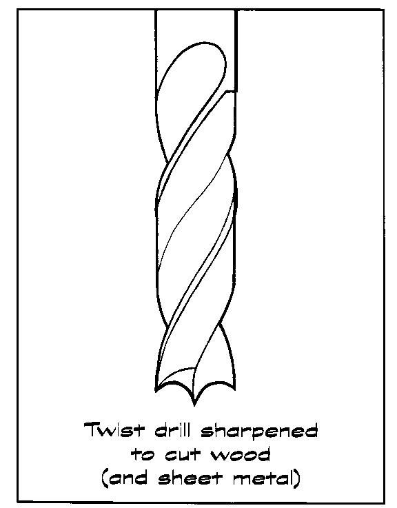

                      Good trick. Also, if you are doing a lot of sheetie work, you can sharpen your drill bit as below. These days I just use a step drill for the thin stuff.

                            Yes indeed. The sheet metal drill illustrated above works best when the sheet metal is on a layer of wood underneath it. The point goes through into the wood and holds the drill centred, then the points more or less trepan the OD of the hole until they break through into the wood.

                                  I have some special sheet metal drills designed to drill unsupported sheet alloy such as aircraft skins. They drill a perfectly round hole because there is no relief on the outside like normal twist drills which tend to leave triangular lobed holes.
                                  If possible for flat sheets, the sandwich method is best to reduce distortion.
