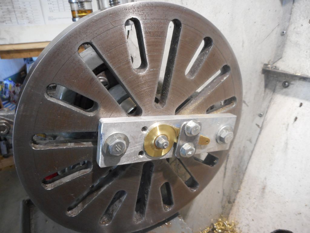

      Hi, I am attempting to refurbish a very worn Lucas Automatic Timing Device for a classic bike. One of the bobweight pivots is badly worn, and I need to make a new pivot pin and socket. The socket has been worn off centre and out of round and I plan to bush it in phosphor bronze and re-drill to 3/16 bore, the pivot pin nominal size. I can mount the bobweight using a projection on the Bach Concentric with the original hole, then drill using cobalt(?) drill, but this will then be out of centre to the worn bore and liable to catch or break or wander off centre. Or, I could drill down the worn hole's centre to make it round, bush and bore, this might put less strain on drill but it still has to go in an out of round hole. Any suggestions? Thanks, Andy

          You will have trouble getting a hole like that drilled using a drill press, there is too much slop in most of them. I would have difficulty using a mill and a stub length solid carbide drill. A short carbide end mill would be a viable alternative with a very slow feed. I don't think a cobalt drill would stand a chance.

              If you can set it up in a lathe at the right centre, maybe in a 4 jaw chuck, you can use a dremmel type grinder with a grinding wheel to true up the hole held in the toolpost.

                +1 on David's suggestion above. Or maybe even drill it out with a short carbide end mill cutter held in the lathe tailstock.
                For holding small odd-shaped jobs like that in the lathe I often use a square of scrap aluminium plate say 2" square or so and 3/8" thick, or whatever is in the scrap box. Then clamp the part to the plate by drilling and tapping holes where needed to put a piece of flat bar etc across the top of the part as a clamp. Or even just screws and washers on some parts. Then the plate is attached to the faceplate with a couple of bolts through the plate and faceplate slots. You can then move the whole plate around to get the part centred exactly where you want it.

                        Make a steel guide bush and clamp it in place to guide a 4 flute carbide endmill, your pillar drill will easily accomplish this.
                        A brass guide bush would probably be fine for a one-off.
                        Note that I am speaking from commercial experience here, not speculation or theory.

                          If you're lucky, the guide bush – end mill (or even drill bit) approach above will work just fine. However, it hasn't always worked for me, especially for slender cutters, because the off-centre forces on the milling cutter may cause it to cut sideways into the bush. After a ridiculous amount of procrastination and analysis-paralysis on one job, the solution came. Add a sleeve to the cutter (superglue), so the guide bush is protected: only the sleeve runs in the bush, the cutter becomes an end-cutter (only) and the whole setup gains rigidity as a bonus. Good luck.
