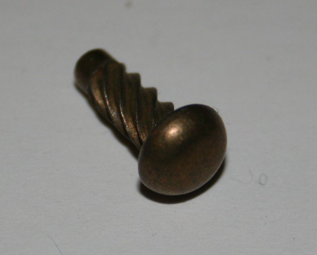

        Hi All,
        Hopefully a quick answer for someone…
        I am currently trying to drill out a blind rivet on a machine casting that is holding the belt speeds plate on – but they are either hard or work hardened – either way a HSS drill wont touch it.
        I have looked at Carbide drills, but only ones of the right size (1.6mm) I can see are listed as PCB drills – are these up to the job?
        Any advice gratefully received!

          James
                  These are something called a drive pin. They are a blind rivet as you say but they have helical serations on them (rather like a very coarse thread). They could be described as metal nails as they are driven in with a hammer. They are almost impossible to remove. The only way that I know of to remove them is to try and remove the belt speed plate without damaging it too much. Then make up a tapered wedge to go under the head. Then gently tap the head of the drive pin while taping the wedge in. There is the danger of bursting the casting and you end up with a crater. For your information the hardness is like a masonry nail. I would have thought drilling was a non starter. I would be tempted to grind the head off, remove the plate and when replacing it move it up or down 5/6mm and re-drill.

                  Hi James, if you haven’t seen them before this is what they look like.
                  Yes they can be removed by a bit of tinkering, I’ve managed to get a good grip on the sides with a decent pair of pliers and twisting, but it doesn’t always work. A little leverage under the plate can help if you can get something thin enough to start. If you’ve got a Dremel type tool, you might be able to cut a slot in the head and use a screwdriver to loosen it up a bit. But if all else fails, just grind it off, like what has been said.

                          Thanks for help on the above. Because one on the plates was in a recess, access was a bit limited for mole grips on some of the pins – so I went for the cut off wheel in the dremel to cut a small slot in the head.
                          Appropriate screwdriver and a good downward pressure and all drive pins are out, without damage to the plates!
