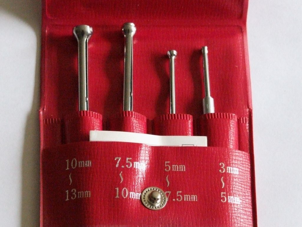

      I have a need to accurately drill a 10mm diameter hole transversely in a 16mm diameter bar. Actually, a hole a few thou under 10mm would be ideal. 25/64th inch is 0.3906", 0.003" under, so possibly ideal.
      However. I was concerned that it would not drill accurately – my 10mm diameter drill drilled a hole nigh on 0.014" (0.35mm) bigger than 10mm – so I did a trial.
      I have a stub of 20mm bar so set that up on the drill and drilled progressively holes of diameters 1/8", 3/16", 1/4", 5/16", 3/8" and finally 25/64", starting with a centre drill and using a pecking technique rather than just blasting through. From 1/4" and upwards I measured each hole diameter with an inside mic; the 1/4" hole was 0.0025" oversize, the 5/16" hole 0.003" oversize, the 3/8" hole a whopping 011" oversize and the 25/64 hole 0.006" oversize.
      So the 25/64, far from being 0.003" in theory under 10mm ends up 0/003" over 10mm.
      Question is, are these tolerances the norm (not really bothered to check before) or would a better quality drill be more accurate?
      And would getting a 9.8mm – 0.3858" – drill on the basis that if it drilled few thou oversize as expected it would end up roughly where I want it to be, be a good option, or would a high quality drill drill more accurately, and if so, what make is recommended?
      All my drills are bog standard HSS drills of no particular parentage BTW.
      Chris
      Edited By ChrisH on 24/04/2021 10:18:20
      Edited By ChrisH on 24/04/2021 10:19:11
