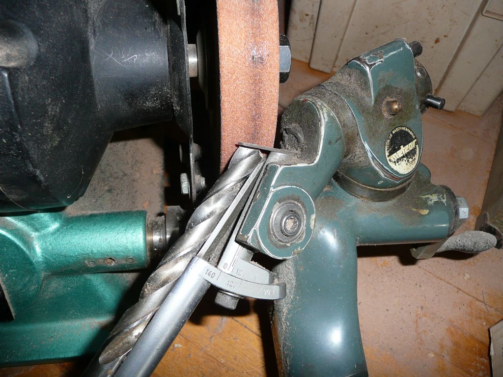

        I wonder whether it is worthwhile sharpening drills 3mm and under. Buying in packs of five drills it is not time/cost effective to waste time sharpening them.
        Bigger drills of course will be cost effective.
        My drill sharpening machine is a ‘Meteor’ of Swiss origin, I doubt it is made today.
        This will take drills from 3mm to about 20mm parallel shank, limited by the length of the groove on the bar and micrometer stop.
        Below 3mm I sharpen by hand and eye, or just replace it!

                Sorry for the late reply! I got a solution just for that…it will be good to build a sharpening jig than buying as this is endless….so many out there!
                For drill bits I used the Tormek concept to grind 4 facets sides drill bits. See my photo.
                For end mills I made a simple tool and cutter jig with influence from Quron, Deckel So and only recently Bristol Cutter grinder from MEW. See my photo.
                With these 2 jigs one could sharpen anything. But to sharpen the flutes of end mill is a challenge though. Also drill bits smaller than 3mm is best done using a hand grinder for better control than a bench grinder.
