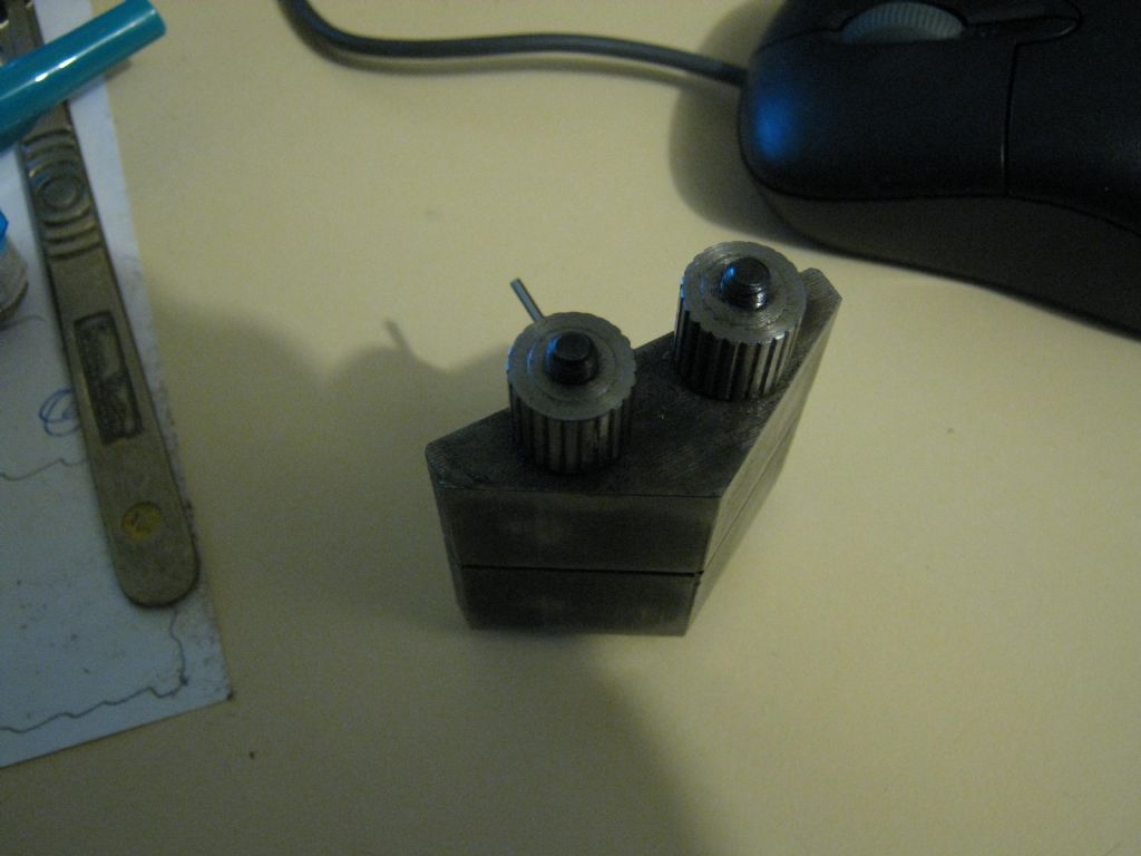

                                    the photo is my drill sharpening jig, one of my first model engineering projects at the suggestion of a maestro.
                                    there is a little V notch across the thing which locates the drill. you eyeball the angle of the drill usually by matching the existing sharpening. the whole thing is then just stroked along an oiled fine slipstone. it achieves absolutely regular drill ends.
                                    I made mine on my shaper from SAE4140 which my maestro friend then hardened and nitrided for me.
                                    It is a model engineer published design though craft disease hits me for the details.
                                    I think it was a Bradley design. works a treat.
                                    that is a 1/16″ drill in it.
