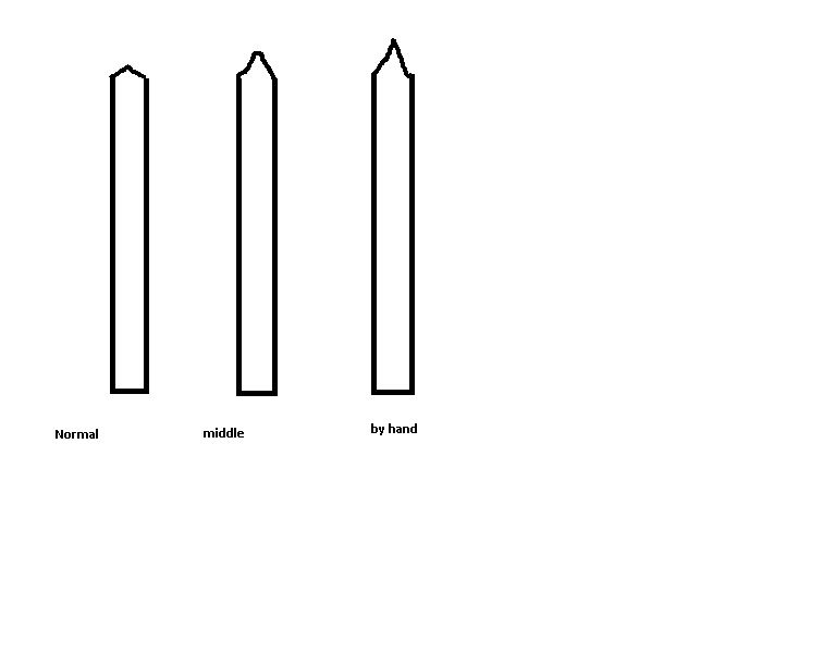

              Ady1
                @ady1
                I have a basic rule of thumb where the larger the angle the easier it is to drill by hand
                Here is a totally unscientific drawing
                The more pointy it is the easier it is for hand drilling in steel and the more it grabs the work if you push hard with a machine tool so you use it lightly in any machine
                The cutting angle is between the part you grind and the inner spiral
                If you can hand grind for hand drilling steel then machines are easy peasy
                When you hand drill steel always always use a pilot drill of about 3-5mm max to clear the centre area out
                Hand drill steel at low speed to save on drill wear, 2-300 rpm, once you get some skill and experience you can up the speed as required
                A well ground drill is your pal and cuts into the metal straight away, no metal means a regrind
                Grinding for a machine drill is about grinding a less acute angle because even cheap machines can apply such huge pressure at the cutting edge compared to a puny human and the drill should also last longer with more meat at the cutting edge
                Edited By Ady1 on 08/07/2021 16:59:02
                #553265
                Howard Lewis
                  @howardlewis46836
                  If you can make / arrange a set up that provides four facets, do so.
                  They cut like a hot knife through butter, and centre more easily.
                  Having equal length cutting edges is essential if the drill is not to cut oversize.
                  Is it my imagination, or do four facet drills wear less rapidly?
                  Howard
