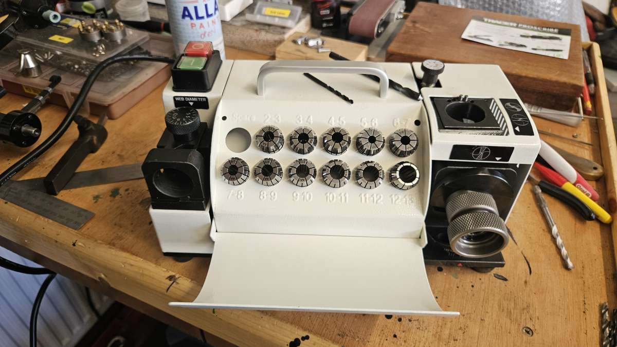

      I have just bought the Warco drill sharpener. Very reasonable price and looks robust.
      initial results are encouraging so it looks worth the outlay 20241029_151307

        Does the sharpener do split points?
        Also, if it does, can it sharpen existing split point drills, or is it only able to do split-point grinds on standard-grind drills?

            Bill,   it does point thinning which is similar to a split point I’m guessing.

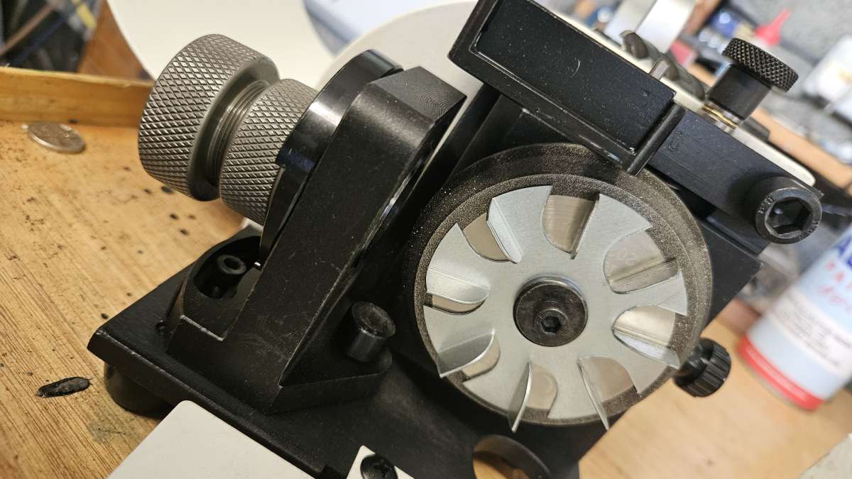

            The first operation is to set the blunt dril in the collet chuck so that the webs are properly oriented and the protrusion is right, this is a simple thing using the jig on the left hand side of the machine.
            Next operation is to grind each Web in the port on the right hand front of the machine.
            Finally the collet is lowered in to the port on top of the right hand side to thin the point each side of the drill.
            The diamond d wheel is shaped so that it can achieve this, it’s not just a plain stone as I thought it would be.
            20241029_151326

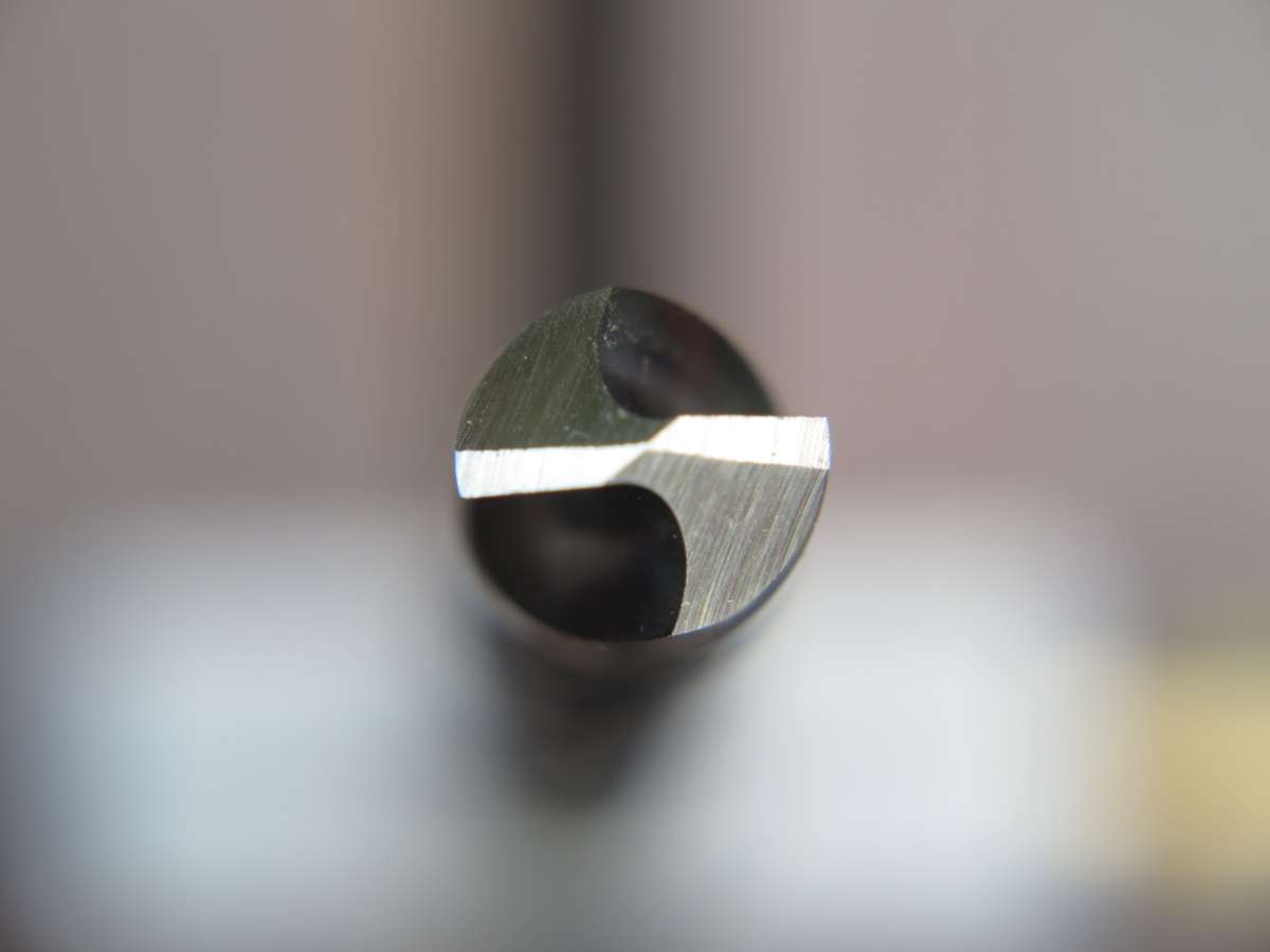

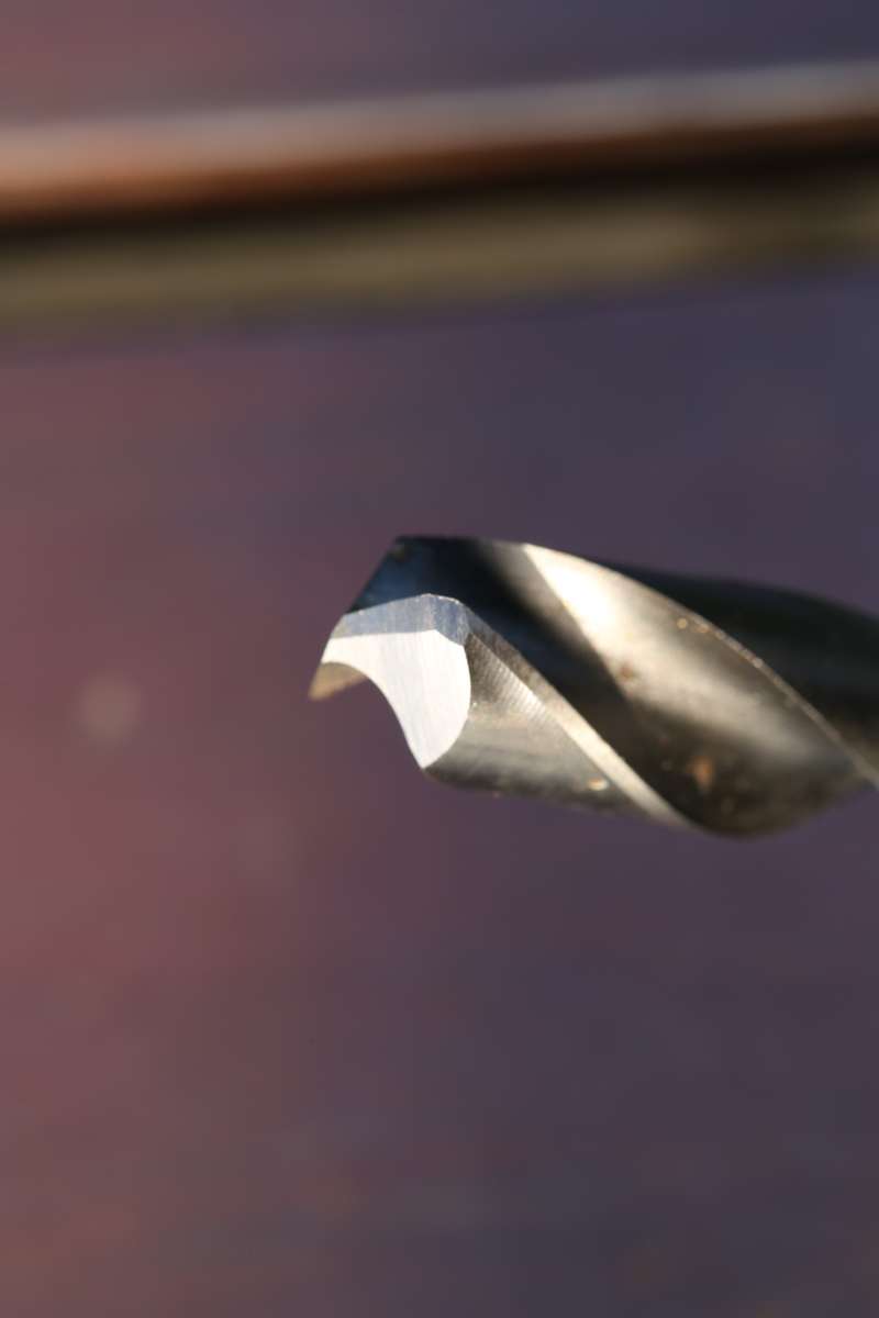

                                I’m quite surprised that none of you seem to put a secondary point angle on drills, it makes the drill more useable for longer.
                                #762121
                                Bill Phinn
                                  @billphinn90025
                                  What do you mean by a secondary point angle, Bernard?
                                  #762125
                                  bernard towers
                                    @bernardtowers37738
                                    Sorry Phil don’t have library photo but will post one tomorrow. Basically halving the angle on the outer tip of the drill which travels fastest and furthest, this slows down tip burn.

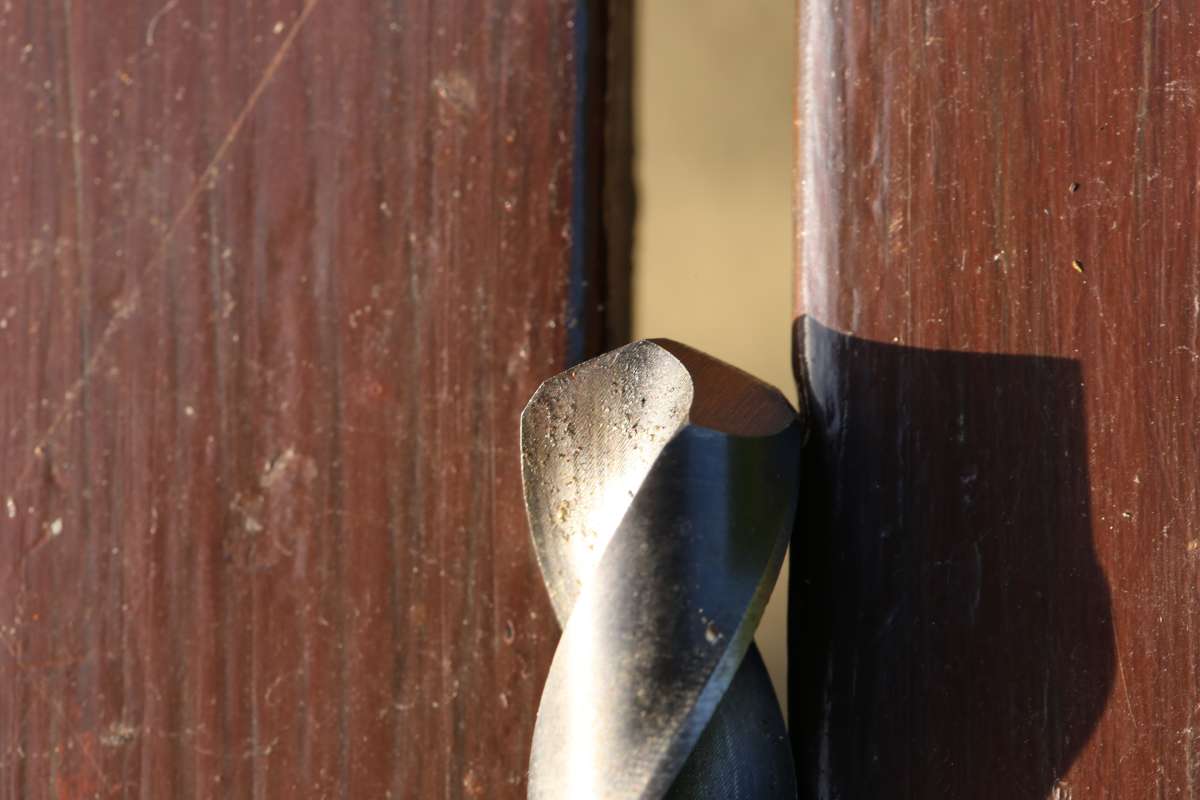

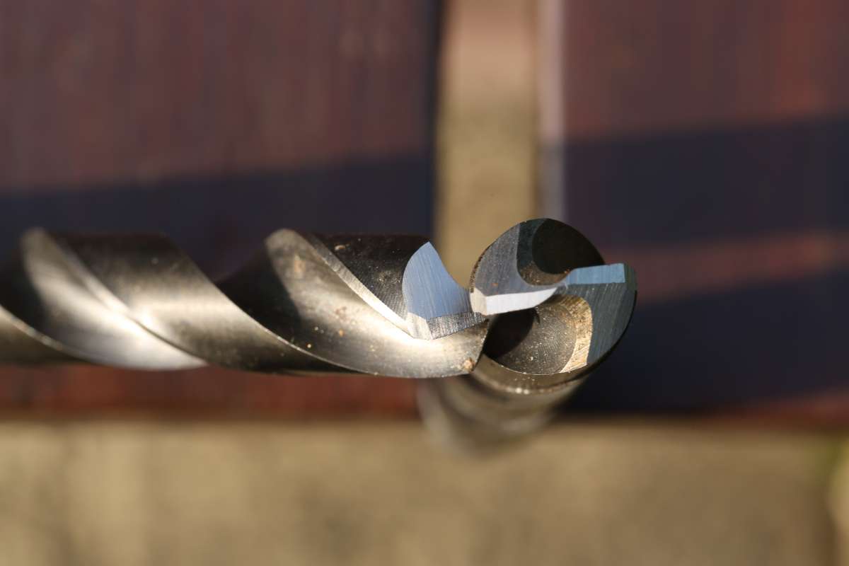

                                          Sorry about the typo Bill but here are the images as promised. as you can see in the 3rd image the angle is halved reducing the tendency to tip burn because as we know most people use drills 10mm and over at speeds that are too fast.S11A7250S11A7251S11A7252

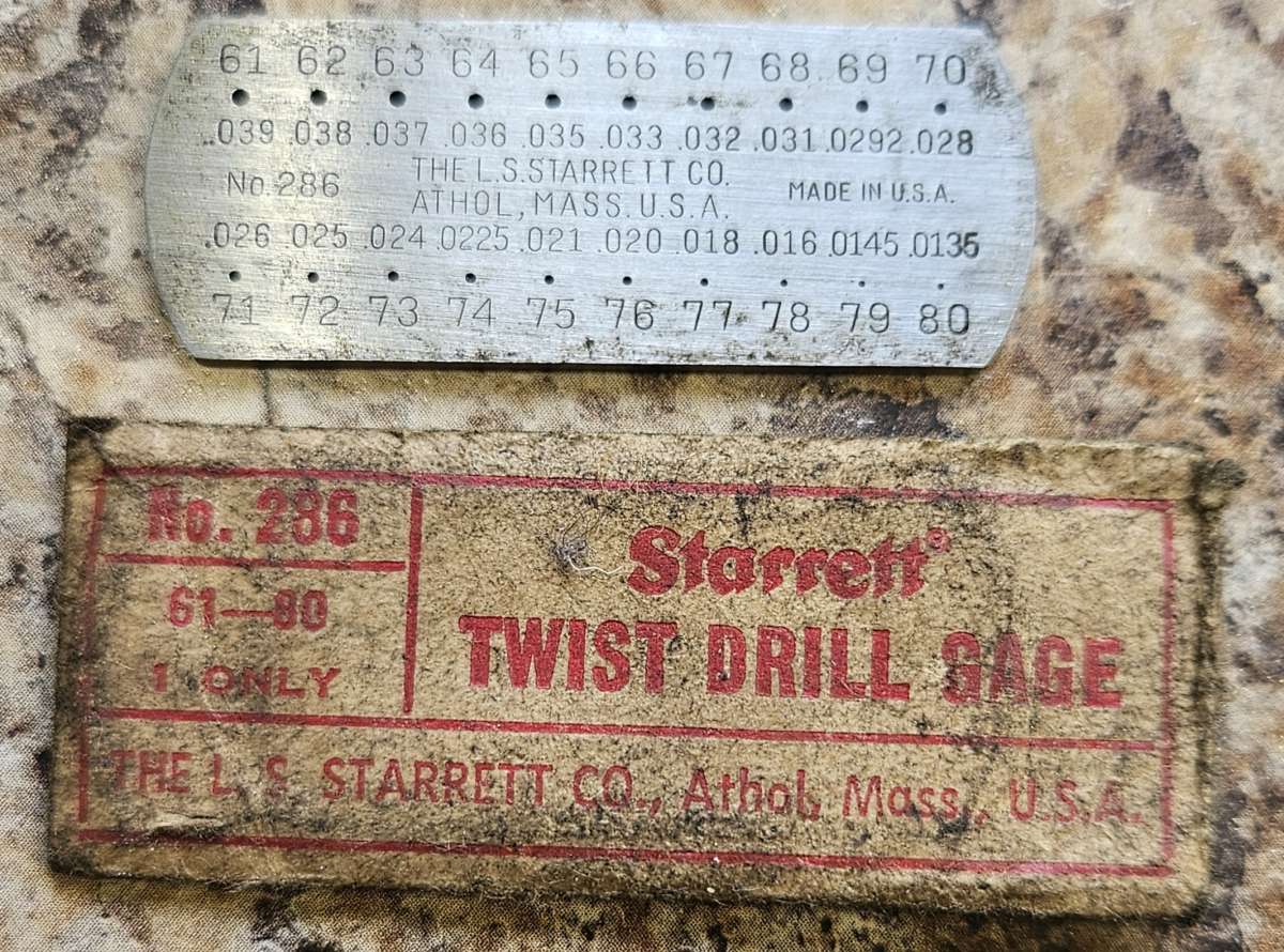

                                              Found this drill gauge in my box of bits. I would not fancy trying to sharpen a No. 80 bit….
                                              20241031_131321
                                                Now I get it, Bernard.
                                                I wonder why drill manufacturers don’t do this to their drills.
                                                Are there any functional disadvantages to it, e.g. slower drilling?
                                                #762266
                                                Mark Rand
                                                  @markrand96270
                                                  That form of secondary grind is used for cast iron on conventionally ground drills.
                                                  In the case of four facet grinds it’s useful because the grind produces excessive clearance at the tip of the drill and the secondary grind helps to control the tendency to feed too fast into the work.

                                                  bernard towers
                                                    @bernardtowers37738
                                                    yes from the information I found it seems to come from the american motor industry in the middle of the last century, they claimed nearly 5 times the life between grinds and straighter holes. You can see by the last image how well the angle is halved, presumably sharing the heat generation to two points instead of one. Who knows?. The results i get from the larger drills is quite encouraging especially the finish on the inside of the hole.
