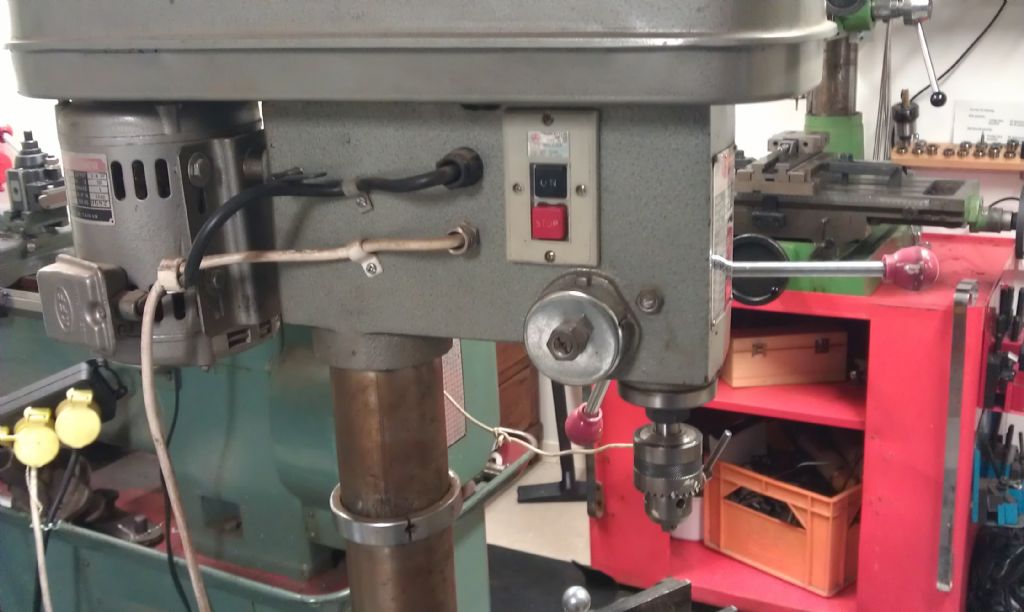

        Hi
        Is there anybody who have a manual or drawing for the
        KTF-13 Drill press
        (King Feng Fu Machinery works co Ltd)
        Bertil
        #139389
        Svarven
          @svarven
          I have to disassemble the spindle then this unfortunately was a little crooked. So it can be when buying used items.
          This machine is available under a variety of names.
          So if anyone can help me with instructions to mount the spindle down without ruining anything, I would be happy.

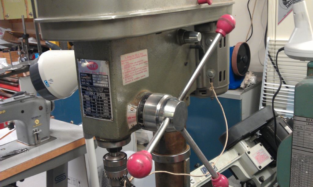

            Hi
            cant help with spindle . But I notice in No. 2 photo . there is a large gap between the head and the stop on the pillar . elf and safety . slide it back under and lock in place . if you swung the head round at the moment the head would drop and my do some damage or injury . Please accept this in the spirit of this forum

              Bertil,
              Apart from the colour it looks the same as my Naerok. Mine has quite a lot of runout on the quill and I have just replaced it. Sorry I can't help with your problem
              Nobby,
              The head is fixed. That ring is the upper locator for the rack to raise the table. Sadly, not like a Fobco.. Kind thought though.

                  Trevorh
                    @trevorh
                    Hi, if it is assembled like the old Alpine then its quite straight forward
                    with the spindle in the raised position you need to remove the coiled tensioner spring
                    next remove the 3 handles and gently pull out the splined shaft
                    once this is out you can now -by hand- lower the main shaft out as a unit
                    once out there will be a couple of circlips to be removed and then the inner shaft can be removed
                    you now have access to all of the main components – had to do this to my Alpine to change the Taper roller bearings the other month
                    cheers

                    Svarven
                      @svarven
                      Thanks
                      Now i have to test that.
                      Bertil
