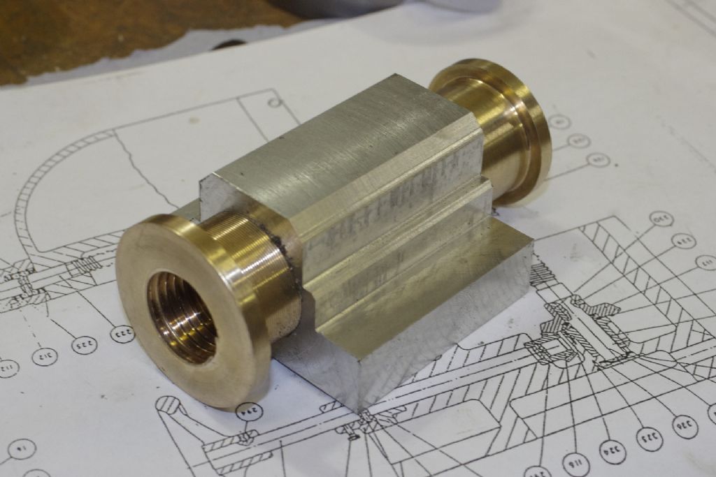

                The 2.5mm Trapezoidal inserts arrived the other day and the first 2 nuts are made as well as the X nutblock. Getting the pitch was straightforward, instead of the original 120 idler gear, the Smart and Brown model A has a double 127/125 and driving in that order turns a 10TPI set in the Norton gearbox into 2.5mm exactly. To save money the body is a block of aluminium. One nut will be Loctited in place and the other is screwed in with a 40tpi thread. The flange of the screwed nut will have axial holes in it for adjusting in situ, and there will be a spring loaded clamp to prevent it turning by itself. reversing the motor while threading is easy, I stop before changing direction, it gives time to back off and/or advance the cut depth.

                    I had a good look under the drill mill before deciding to make the nut assemblies for the X and Y. The X still has about 100mm space either end when at the limit of travel, so this doubling of the nut length will not do any harm. The Y axis nut is restricted towards the rear, but there is plenty of room at the front side, so the front nut will be displaced towards the winding handle.

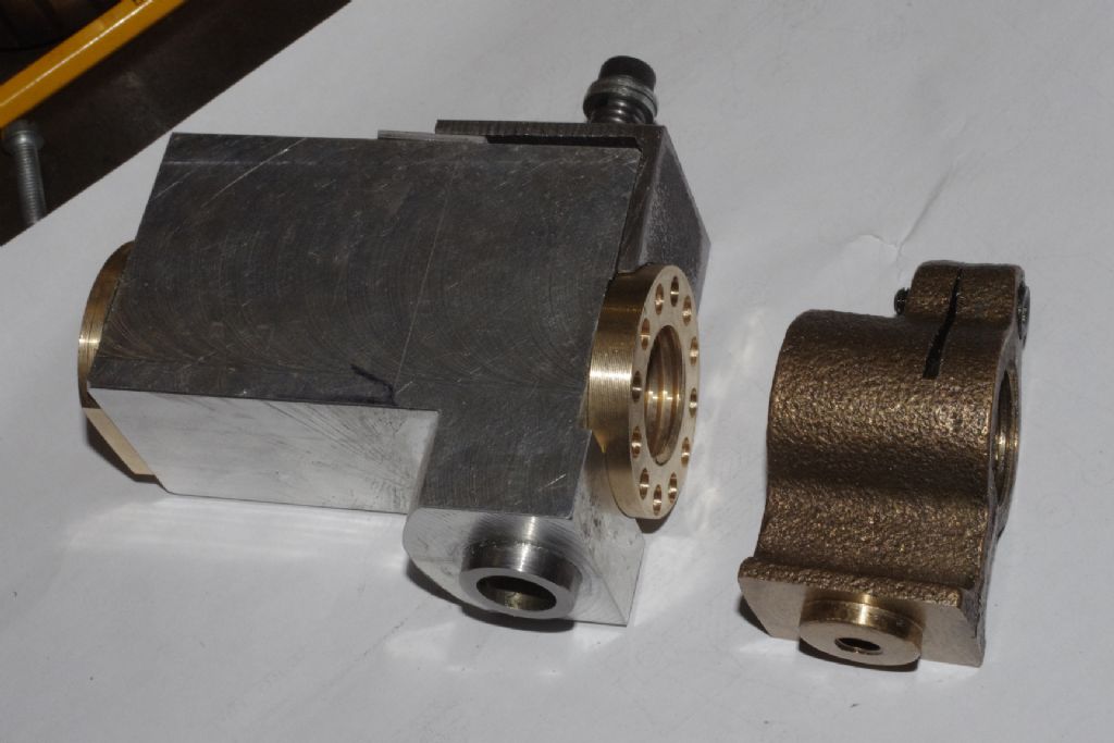

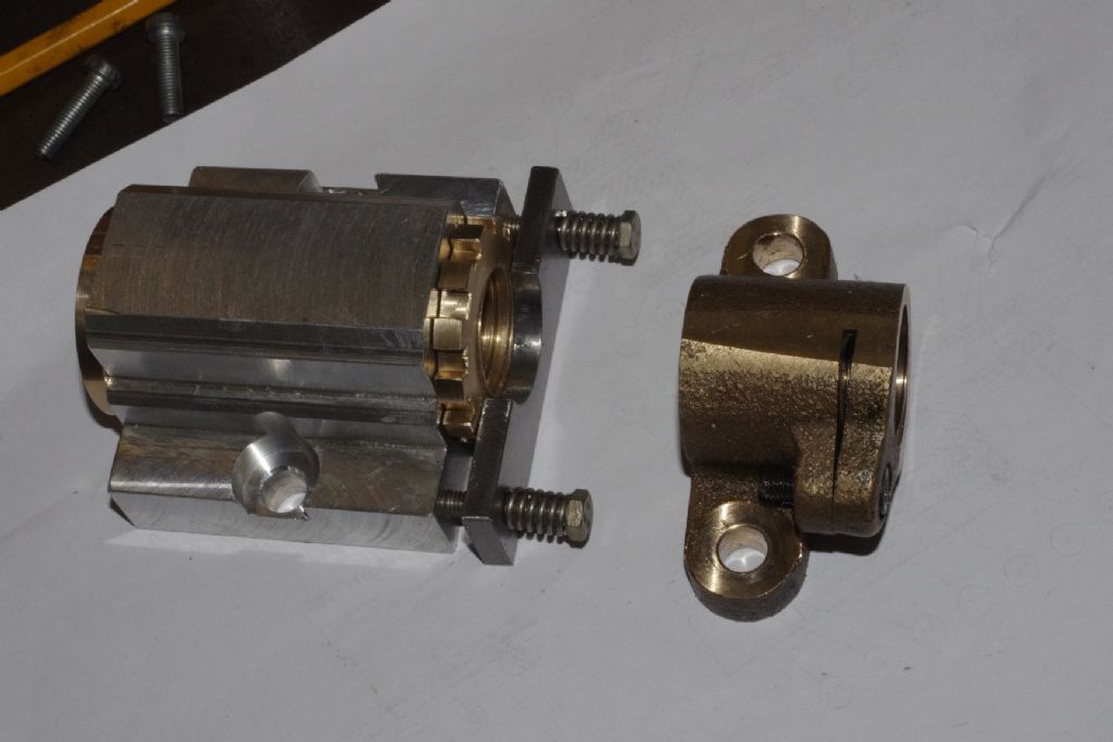

                      _igp2874.jpgWe have almost finished the re assembling of the mill. Here are some pictures of the old nuts next to the new ones.

                        The mill is back together, and I have confirmed that the X and Y travel is unaltered. Both have 0.1mm backlash which is down to the leadscrew thrust bearings axial play, they will need a complete rethink of the original Taiwanese design.
