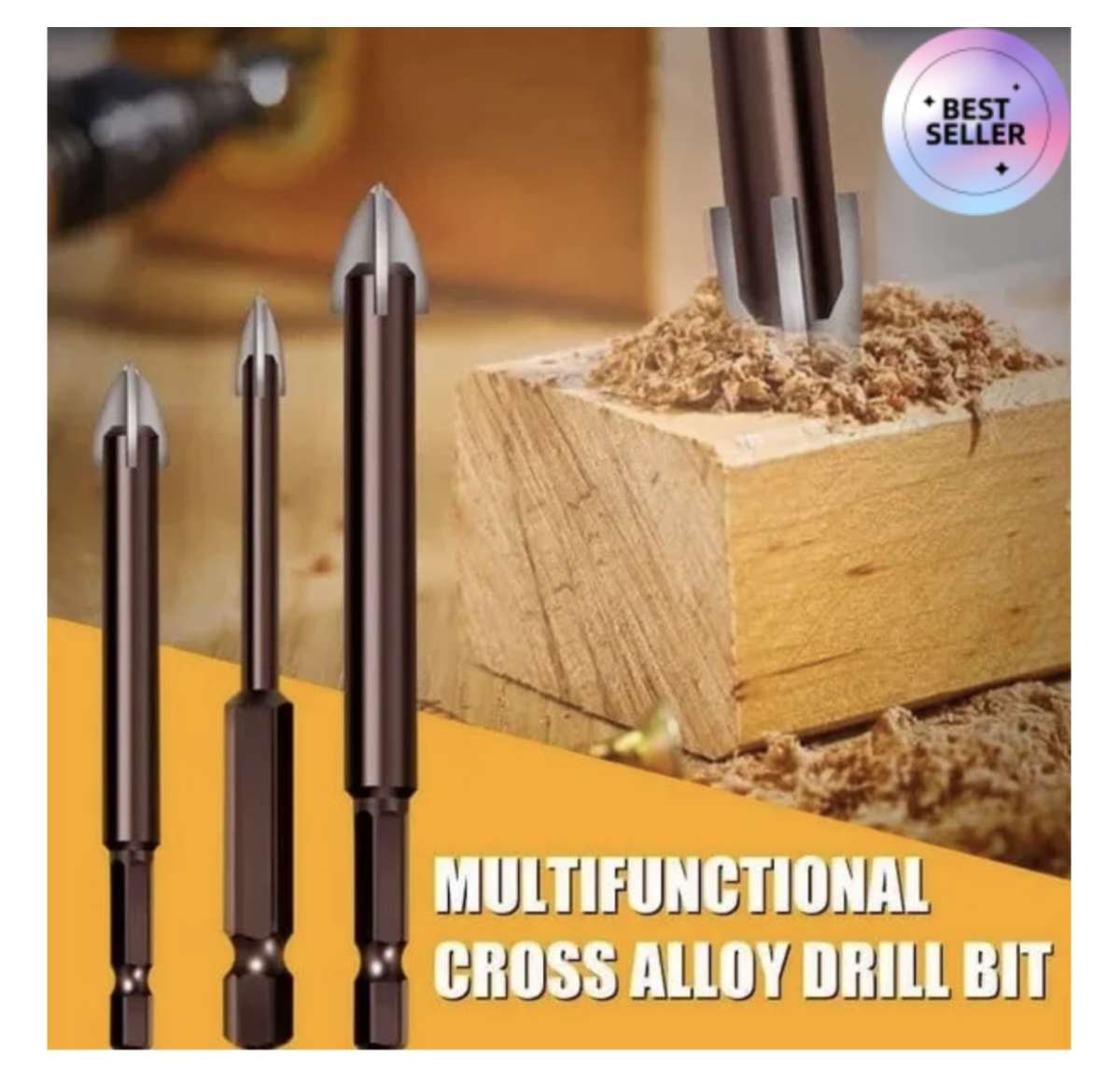

      I wonder what these Carbide drill bits are like? Set of four on places like eBay for about £6.

        I haven’t seen ones like that before, but from the design I suspect you need high speed drive, heavy pressure and sturdy equipment to be able to bore your way through by heating, eg melting the hole rather than drilling it.
        Others may know better
        Brian
        #719004
          They are meant more for stone, ceramic, composite etc which they work like any other spade type bit. Only difference is they put a bit of a helix on the shank which being smaller than the carbide tip’s diameter won’t do a lot to help clear dust from deep holes.
          The 1/4″ hex shanks are likely to be used in cordless drills so no need for heavy equipment.

            Those look weird!
            If the tip, (which appears to have no cutting edges) is carbide and relies on extreme pressure to create a hole, why would it have flutes I wonder.
            Not enough info in the image to really identify what the drills are.

                I did some searching before I replied earlier but could not find any that looked like the one Brian showed.
                Now, having looked closely at the picture I can see an outline lighter shaded bullet shape which I originally thought was the blister packaging.
                IMHO the drills are ideal exhibition demo fodder, although I am sure they will work (to an extent).

                      Apart from very high cone angles the e-Bay advertisement suggests their cutting-edge geometry is not ever so different from any masonry drill: no rake and shallow clearance. They scrape rather than slice the material.
                      Odd-looking flutes too, though I don’t think their outer diameter is much less than the tip diameter. It is hard to tell from the heading photo.

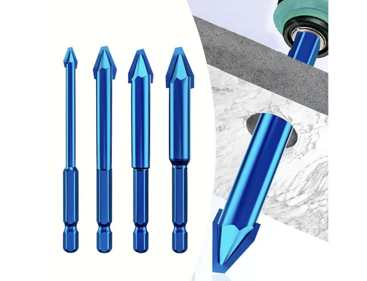

                        Also available without the flutes in Blue! 😆

                            As I said really no different to the traditional spade type tile drill. Which work well on certamic tile, slate, marble, linestone etc. I use them for work without problem. All they have done if put fancy flutes on them and made the shanks so you can use them in an impact driver or cordless with quick change.
