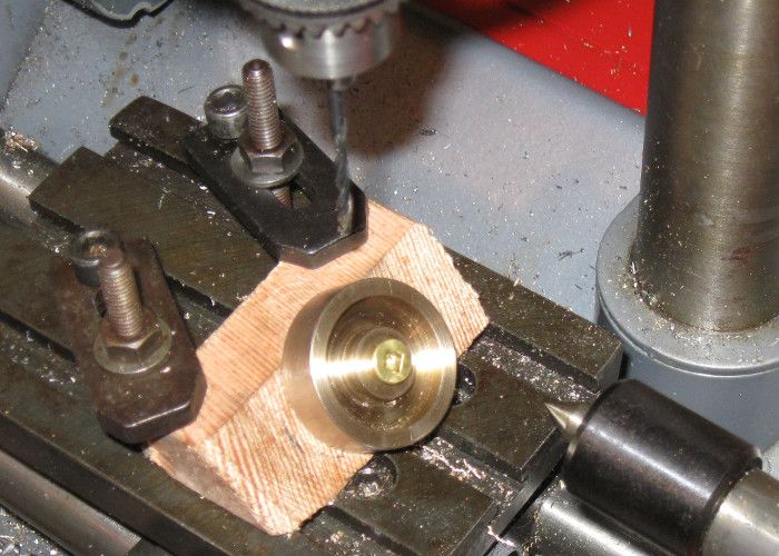

                  This is how I did it when I built my first engine.
                  I cut off a scrap of soft wood at 45 degrees in a mitre box, screwed the flywheel tightly to the wood off-cut which was then clamped to the drilling table of my lathe.
                  Bear in mind, that it is a small flywheel and a small Unimat lathe/mill/drill. Anything larger would probably have needed a far more secure method of holding the flywheel.

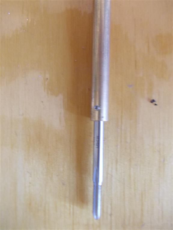

                      I have ordered a longer 2.5mm drill bit (101mm) as my current drill bit is only 55mm. At 101mm long I would prefer to use 2.4mm as the tap drill but they do not have them at 2.4mm. I am already holding the flywheel in the vice and using timber under the vice to get a good angle. I punch a small mark on the hub to give the drill bit a starting point. All this works quite well but then the main problem is the M3 taps which are quite short. At the moment I am getting it done by just holding the end of the tap in the tap wrench by about 1mm but this will not work for some of the larger flywheels I have.
                      Jason : can you post a photo of your tap extension if you have one handy ? I have a few ideas in my head but I would like to see what you use.
                      Edited By Brian John on 26/02/2016 07:32:48
                      #227007
                        I did look for one yesterday but could not fine one with a tap.
                        For M3 take a piece of 5mm or 6mm roudd steel, face off the end in the lathe and then drill it so that the shank of the tap is a good fit in the hole and say 15mm deep. Clean the tap and loctite or superglue it into the hole and leave to set. You now have a long tap which will reach where you need.
                        Once the job is done heat the rod being careful not to overheat the business end of teh tap which will make the loctite joint fail and you can pull the tap out of the hole.
                        This is the same principal with a drill bit on the right
                        The 2.5mm drill will be idea, 2.4 is getting a bit tight for M3

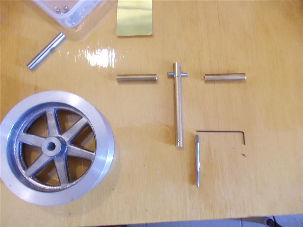

                                I have spent the afternoon making this tool from 1/4'' round brass…well, I spent most of the afternoon thinking about it and much less time making it ! I drilled and tapped the main brass shaft to take two M2 X 2mm grub screws : this holds the square part of the tap. There is one grub screw on each side. I did think about going for four grub screws but decided to stick with two for now. I drilled and tapped the shaft right through at the other end to take an M3 X 20mm pan head screw. The head was cut off leaving just the M3 thread exposed on either side. The tommy bar was then made by drilling and tapping the ends of  two pieces of 1/4'' brass which were screwed onto the thread.
                                It actually works. I can get in closer to the hub of the flywheel with this tool and no Loctite required. The only problem I had was the hex tool to tighten the M2 grub screws. I  had four 0.9mm hex tools but only one fitted the grub screws and the others did not as they were too small. I thought 0.9mm AF was the correct hex tool for an M2 grub screw ?
                                A smaller shaft [less than 1/4''] would probably require Loctite as there would not be enough thread on the grub screw to adequately grip the end of the tap.
