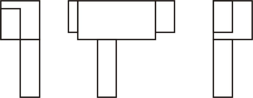

                  You question the value of knowing the projection. This example shows a front bview and two side views of a part:
                  If you don't know whether this is first or third angle, you can't tell which of two possible shapes the object is.
                  Now think of something complex like a real car engine block, or a house… actually the simpler the part, the greater the chances of an error.

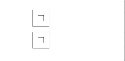

                    Welll….looks like view on left of main view is wrong…but the point is correct….A knoledge of the system in use is as much a part of the drawing as any view.

                      "How silly is that?? Its the same diagram, just rearranged. No wonder its confusing cos as a novice you are looking for something much more complicated."
                      Hi Wolfie,
                      Here is a drawing of a simple component.  Projection method (1st or 3rd) is not specified. Does it matter?  Draw me a 3D sketch and post it here.
                      Best regards
                      Terry
                      Edited By Terryd on 20/09/2012 07:12:42

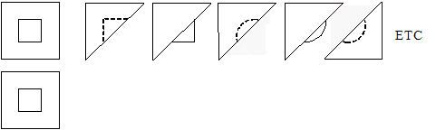

                        Posted by jason udall on 19/09/2012 23:24:36:
                        Edited By jason udall on 19/09/2012 23:37:49
                        Hi Jason,
                        This has been covered in a another thread some time ago
                        The first 4 possible solutions are third angle while the last is in 1st angle.
                        There are actually an infinite number of theoretical siolutions as the sloping face could be a curve and the central element can be either a cut out or a projection from the surfave and could be of almost any profile especially if hidden lines are excluded.
                        Interesting, classic example.

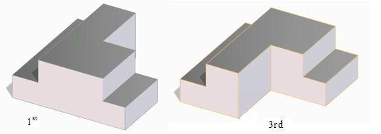

                                  Hi Wolfie,
                                  Better, and half right. (drawing skills no problem, as long as you can put over an idea accurately it is inconsequential). Actually that is one possibility, however if you gave that to an engineer he would either wonder what the line down the centre of the top represents or conclude that it is two seperate components.
                                  These are the two possible solutions (there are others but more of that later) :-
                                  If the drawing was in first angle proj. it would look like the example on the left (as you drew it, but rotated 180) the sketch on the right is what the component would look like in 3rd angle. Of course this is a simple example and would be explained with a plan view, but not all confusions are this simple and can lead to some real problems if the conventions are not understood and observed.
                                  The cut out could also be curved (e.g. quadrant) and that would also need a plan. I have though seen drawings in ME which have confused me until I realised that one side view was in first angle projection and the other in third angle crook. It is useful to understand the differences and be able to interpret drawings correctly to prevent expensive errors
                                  I was recently able to buy for pennies a rather nice piece of steel, about 20mm thick by 300mm wide and 450 mm long which had been accurately ground on both sides. The unfortunate machine operator had read the drawings wrongly (1st/3rd angle confusion) and made a very expensive piece of scrap – great for me, not so for him I believe.
                                  It's not just a pedantic exercise, believe me, when some use 1st angle and others 3rd angle projection systems. It would be good if we could all agree on one system but its a bit like the metric v imperial debate, but let's not go there – its Tiger country! wink
