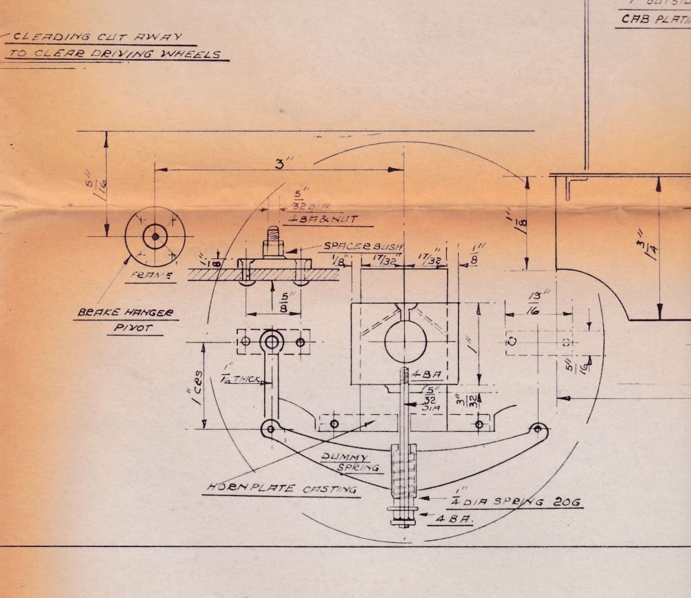

Hi, as anyone a good drawing of the axle box for the trailing wheels axle for a 5 inch gauge Stirling single. The only drawing I have is missing much information. Thanks
Is this what's needed?
Thank you.
