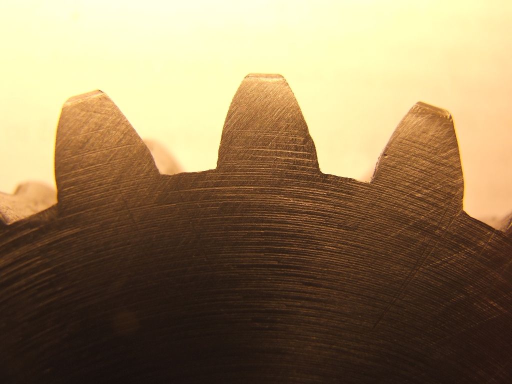

      Having now machined a real worm wheel I'm none the wiser as to how the tooth form varies across the tooth. sad

        You must do, or you wouldn't have pointed out my approach would generate a helical gear, not an enveloping one!
        Think in slices through the gear. At centre it is true involute. At sides it is less depth, but also it is not a radial slice through the worm… so not just the tip of the involute, but a stretched version of it.

          Neil, Did you notice that the worm has a different profile on each side of the "tooth"? Due to the inclined nature of the contact I doubt it is really "involute" but some modified form – a sort of oblique involute (if such a thing is still involute) of some sort.

            Surely it should be symmetrical…?

              Nope, very clearly asymmetric. I think due to the helix angle, but I was starting to think that the the worm should have an involute form of some sort rather than a straight sided flank.

                Looking at the end of the teeth they seem slightly asymmetric to me:
                But of course that could just be iffy machining. crying

                  My guess .the original was filed to fit and run for polish..tight wears and clearance doesn’t matter..this is why things used to be “run in”..
                  The engineering/design fascinates me. But it might be the curves and surfaces “generated” by the run -in meshing set differ from our ideal in subtle ways … …
