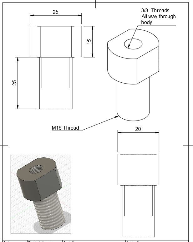

      Hi, Newby and made by first big mistake..!!!!
      I have got myslef a 2nd hand Beaver mk2 Mill and is my first every machine/mill. The chuck needed for this mill is a INT40 and the only ones i could find had a M16 threaded drawbar. So, to go with my purchase of my new INT40 ER40 Chuck i got a lenght of M16 threaded bar to test it out. BUT..!!!!! the quill sharft is only 14mm wide.
      So, does anyone know if you can buy an adapter that can use a 3/8 Darbar and thread onto a M16 chuck?
      Or….. my Plan B, can anyone make the attached adapter for me? Happy to pay the cost of material, time and postage.
      Any help and advice would be much welcome.

          If you use what you have drawn to solve the problem, be very, very sure that the 3/8" drawbar will unscrew before the M16 thread.
          If you are not very, very sure, put a double locking nut at the top of the 3/8" drawbar so you can drop everything out of the bottom of the spindle if necessary.
          Have you checked there is enough headroom up inside the spindle taper to accommodate the 15mm height of 25mm diameter above the end of the 40 taper tool?
          The M16 to M12 or M10 version of this might be a better solution:
          https://www.ebay.co.uk/itm/325124381095
          Loctite it into each tool and the drawbar will always come out as it should.

            Could you not screw the 16mm allthread into the chuck, cut it off flush and drill and tap it to 3/8” to take the drawbar. Kind of like a threaded insert, fairly certain i did a similar thing when i had a 40 int Beaver. You could thread lock it into place.
            Sorry, just read post above, which is an off the shelf solution of what i’m describing.

                But sounds like uncle murphy (OP) has a lathe so could drill and tap first using the lathe.
                If headroom to clear the 15mm head of teh adaptor is an issue make a fluch one like Alan suggests but cut a slot in the end so it can be screwed in and you also have the option to screw it out again if needed.

                  My standard drawbar is 3/8 BSW, so a more modern arbor with a M12 thread is converted by screwing in, hard and and "Loctiting" a piece of M12 studding of the apprpriate length.
                  This is then faced , drilled, and tapped 3/8 BSW.
                  With a M14 or M16 thread, this should be less fraught.
                  The difficulty will be holdingbthe INT arbor, in the lathe, but no doubt a suitable holdr could be manufactured.

                    Maybe I was reading his stated "my first ever machine/mill" too literally. I wonder, if he has a lathe, why he would be asking for someone else to make the item pictured?
                    It is an interesting exercise to list the minimum amount of stuff needed to bootstrap him out of this hole.
                    My B&Q starter for ten: M16 threaded something, hacksaw, vice, cordless drill, 5mm drill bit, M6 tap, M6 threaded rod, M6 penny washer, M6 nut, 10mm spanner. Make the first one with an M6 female thread, the small diameter giving lots of wiggle room in the end of the M16 rod. Even if drilled not in the centre and not completely square it will still work. Use the first one to hold the ER chuck in the mill to make a second, much better one.

                      Thank you for the info and support… some great ideals. Would poss go with DC31k idea on the insert thread and change out to a M12 Drawdar to get me going. Then when up and running with some practice try and make the part at home.
                      Thanks again all….
