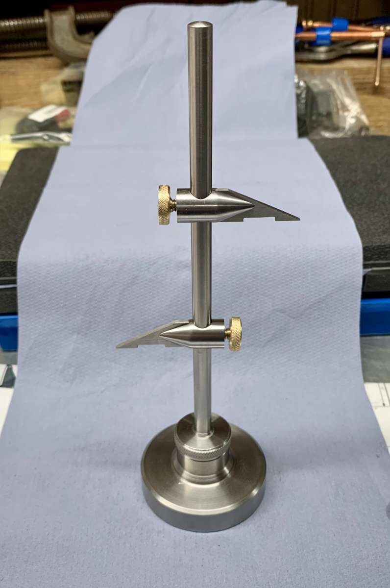

      I am a complete newbie… I’ve finished making my first Hemingway kit & am very pleased with it.. the Centre Height Gauge..
      I am now embarking on another, this time the Spherical Turning Tool. Reference is made in the instructions to ‘draw filing’ – for example the ‘prepare the SIDE ARM by draw filing all over’ … I don’t understand why this would be necessary… and TBH perhaps I don’t fully understand what has to be done & why?
      Can anyone enlighten me please… my apologies for asking, but ‘there’s no such thing as a stupid question’ & I’m probably going to ask a lot more!!

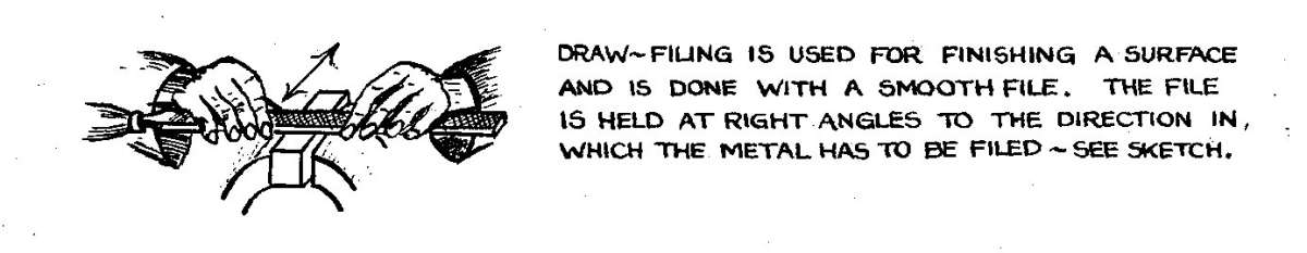

        It is really only to clean up the surface to remove any marks from when the metal was drawn /rolled or to remove machining marks.
        A fine file is held across you and moved to and fro along the work so the file is cutting sideways. This will give quite a nice finish, if you want finer you can then wrap emery cloth around the file and use it in the same way
        #745116
        Nicholas Farr
          @nicholasfarr14254
          Hi Flatline, just as JasonB has described.
          Draw Filling
          Regards Nick.

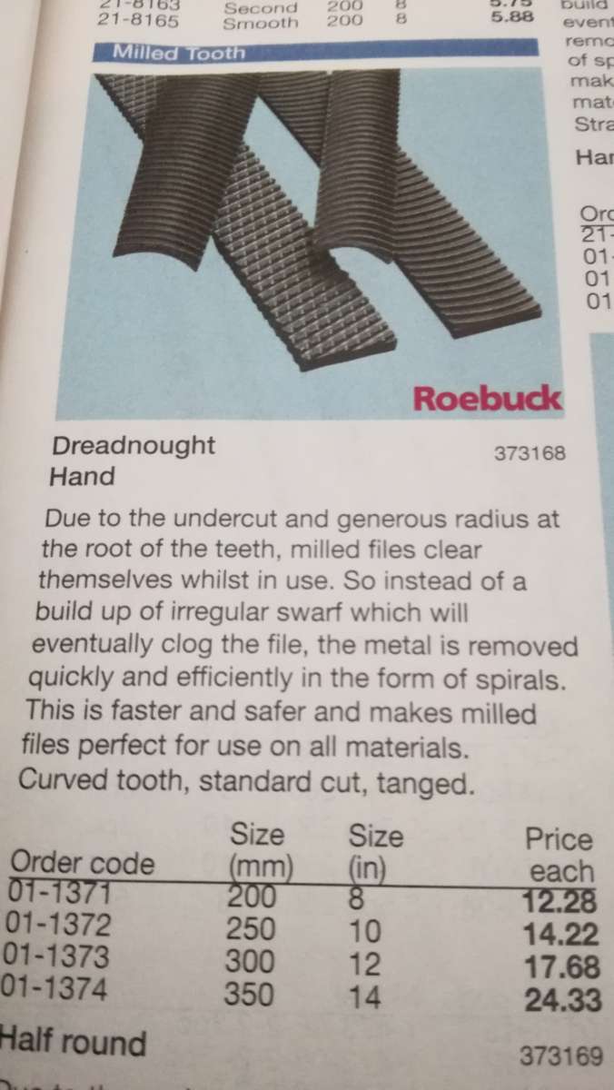

                          Is that what is called a mill file? In a previous existence one of the really skilled chaps kept one of these locked away, rough types like me were not allowed to touch it. He was the one who could file oval crankpins round again rather than having to press them out and remachine
                          #745270
                          Nigel Graham 2
                            @nigelgraham2
                            No. A Mill-file, or milling-cut file, has a single row of straight of curved teeth, but is very coarse.
                            Draw-filing uses a Second-cut or finer, grade.
                            #745285

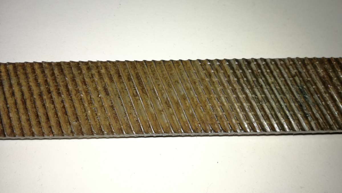

                            Nicholas Farr
                              @nicholasfarr14254
                              Hi, as Nigel Graham 2 has said, a milling cut file is very course, and cuts much like a milling cutter does, not very good for draw filling. When new they will remove metal very quickly with a few strokes, but don’t really leave a very smooth finish, I used to use 12″ ones a lot, filling keys down, before finishing them to size with a smoothing file. The one in the photo below is a section of a well worn 10″ one.
                              IMG_20240805_081054
                              Regards Nick.

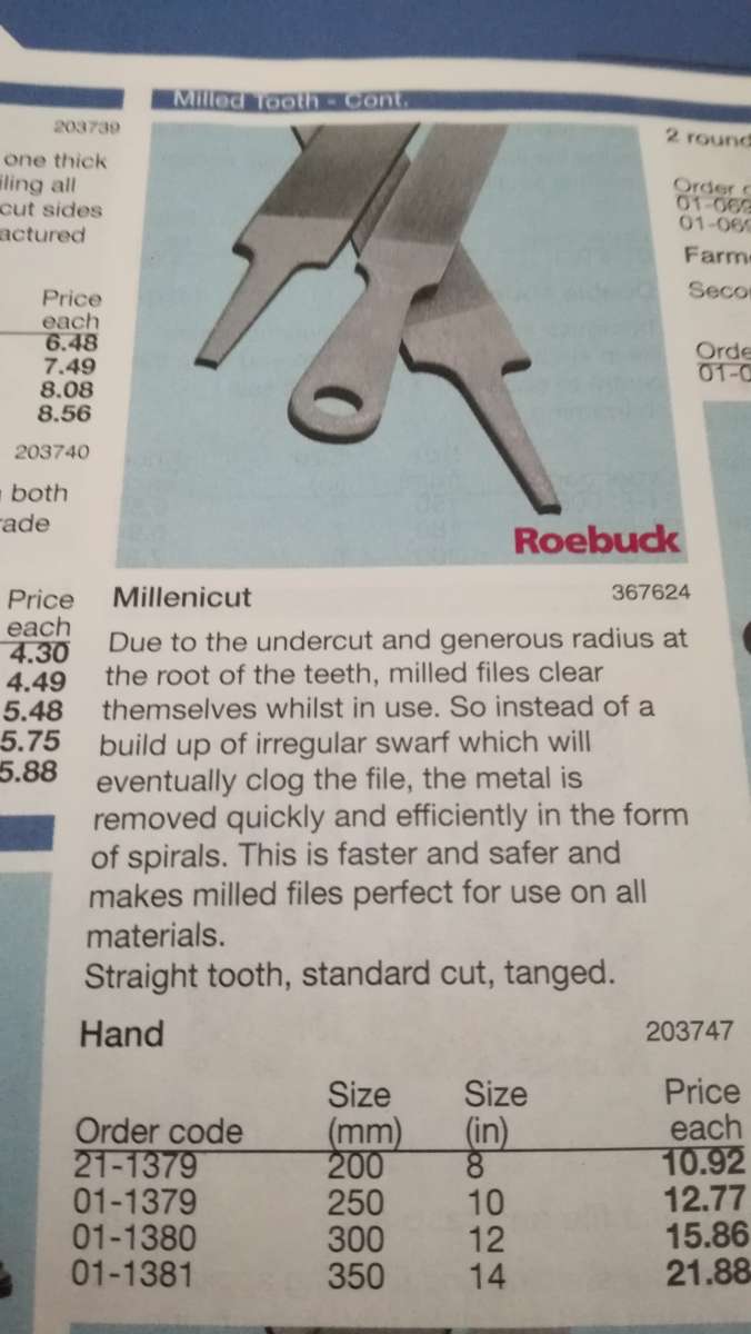

                                    Don’t worry, Duncan … you were right
                                    https://www.classichandtools.com/vallorbe-10-blunt-mill-file-single-cut/p1269
                                    https://benchmarkabrasives.com/blogs/news/difference-between-a-mill-file-and-a-flat-file
                                    … I think it’s the good old English language that’s struggling again.
                                    ’Mill File’ is not the same as ‘Millenicut File’
                                    https://www.wonkeedonkeetools.co.uk/files/what-is-a-millenicut-file

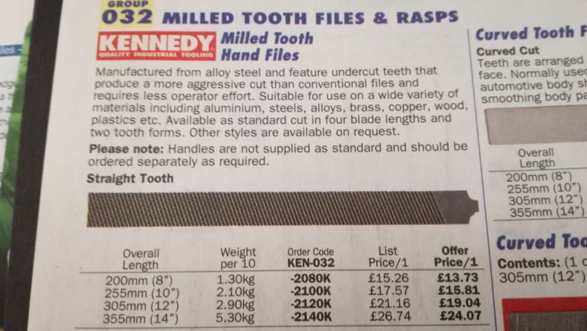

                                      Nicholas Farr
                                        @nicholasfarr14254
                                        Hi, I guess it all depends on local terminology, I’ve always known the type I’ve shown as milling cut, however, Buck & Hickman called them Milled Tooth, and the particular one I’ve shown, is a Dreadnought, and the finer toothed one a Millenicut.
                                        IMG_20240805_113236
                                        IMG_20240805_113331
                                        Cromwell also call them Milled Tooth.
                                        IMG_20240805_112855
                                        While looking through the Cromwell catalogue that I have, I found this.
