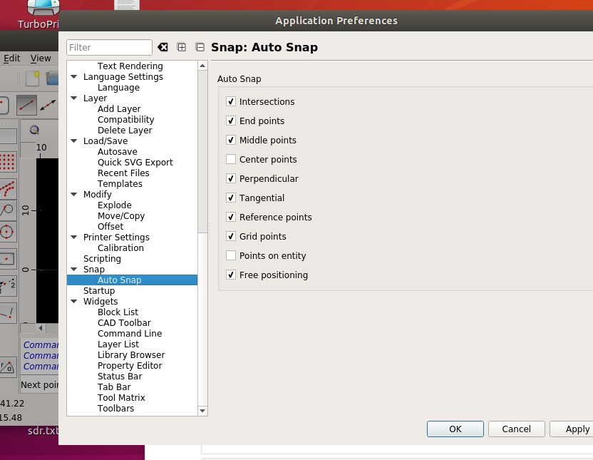

                                      Err, possibly. I like the way QCAD works.
                                      • The 'AUTO' setting does the all the common sensible snap combinations and can be configured in Application Preferences
                                      • Otherwise selection of a particular snap turns the others off which is usually what's wanted. Most of the time AUTO gets it right but total control is available whenever necessary.
                                      With CAD packages, it's easy to get hung up expecting them to work just like the last one. Actually, they have to be driven a bit differently. If the software behaves unreasonably, check the manual – there's always a learning curve, and beginners often stall, crunch gears, indicate with screen-wipers and jump red lights…

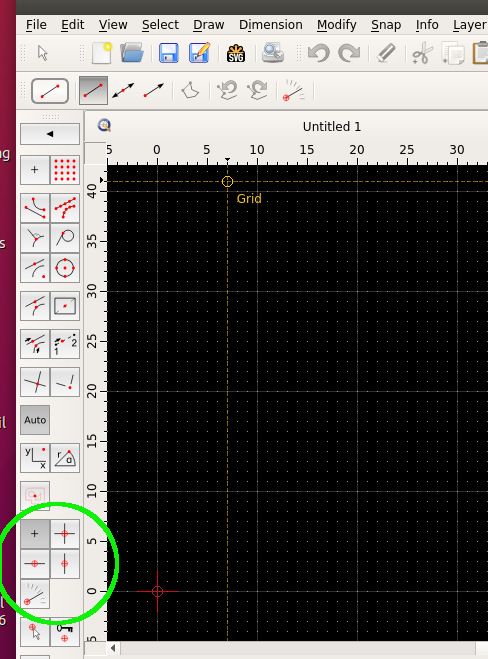

                                                You can type commands as described by Brian or – usually – there's a button. In general it's easier to drive QCAD on the buttons. Commands speed up operations when you know what you're doing but they take some learning.
                                                In line and other drawing modes, Snap and other control buttons appear in the left hand panel. Ringed in green at the bottom are the line angle controls. They are:
                                                • + is OFF, ie draw line at any angle
                                                • red circled cross draws only vertical or only horizontal lines
                                                • red circled horizontal line draws only horizontal lines
                                                • red circled vertical line draws only vertical lines
                                                • fuel gauge-like button allows any line angle to be set

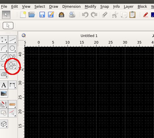

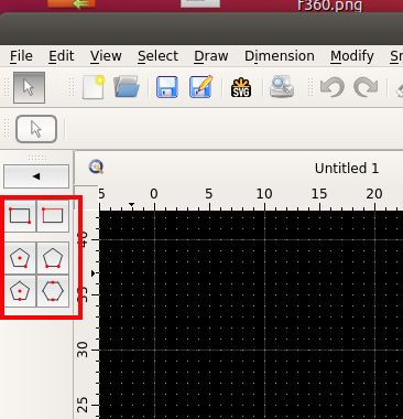

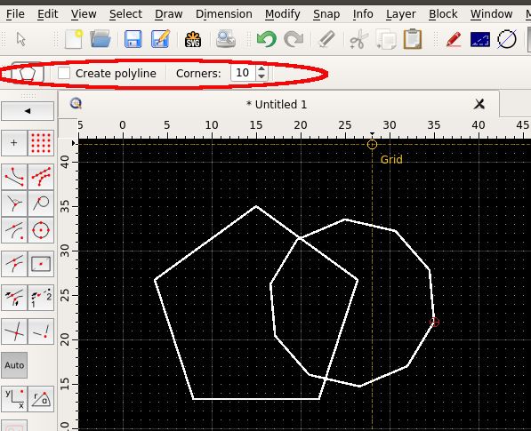

                                                    That's one way of doing it! I know you Northerners are tough guys, but that's like learning to swim by jumping off the high diving board at an Olympic Swimming Pool. It's easier to use the shape tools:
                                                    Pressing the shape tools button opens up the usual ways of drawing polygons (not just pentagons as implied by the icon):
                                                    Clicking a polygon button allows the number of sides to be selected:
