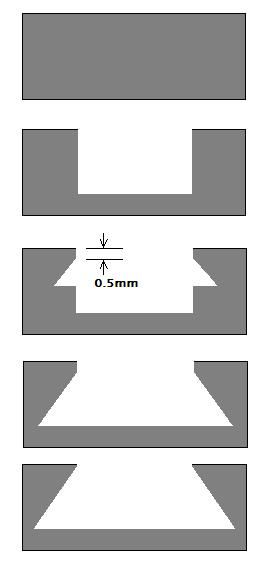

      I have the recent 25-year anniversary issue and in Harold Hall's article about the grinding rest he describes a method for cutting dovetails.
      I'm a little confused by it. It seems to indicate that a dovetail is to be cut at two different depths, instead of going with full depth from start to finish. Is that right? Is this done to minimize cutter load?

          I would suggest several passes with a straight cutter that is the width of the smaller dovetail dimension. This will remove the majority of the waste. Follow with dovetail cutter at full depth.
          #198789
            I think he's aiming to get a better finish by keeping the second cut smaller.
            #198803
            Paul Lousick
              @paullousick59116
              My interpretation of Harold's instructions is to rough out the slot with a straight cutter then cut half of the dovetail, leaving 0.5mm of the finished width. Then lower the dovetail cutter to the full depth to machine the bottom half of the dovetail. Finishing with light cuts to finish the complete dovetail (removing the 0.5mm at the top). This reduces the load on the cutter. The tips of the dovetail cutters are small and could easily break.

                Like this?
                #198829
                  That's how I machine dovetails

                    GHT described cutting dovetails which stated that it is best not to cut the slope and the base at the same time, because of "cutter flutter". His recommendation was to lift the cutter off the base by about 5 to 10 thou for a very light finishing cut along the slope.

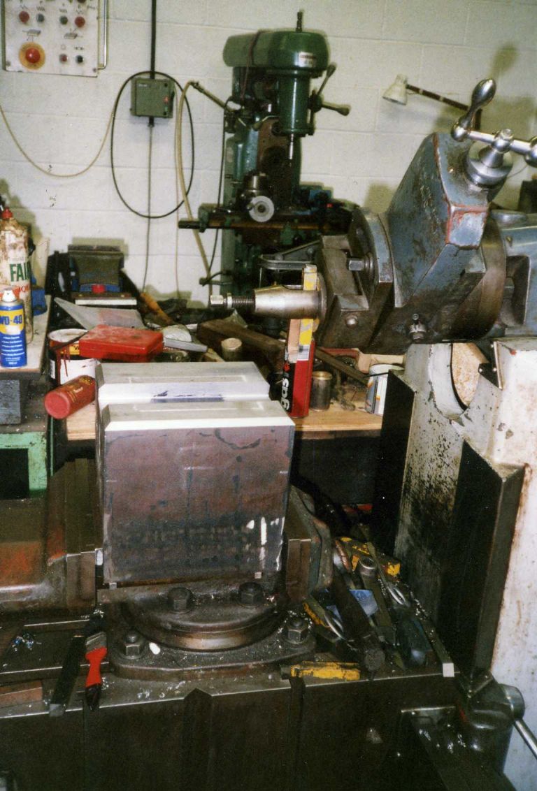

                                  What about using a shaper, ? I have made loads of dovetailed forging hammer die blocks,
                                  With a shaper you can cut any size or angle of dovetail that is required.

                                    My advice Mike is, if you have a largish cutter and a robust machine, then attempt it in one pass, but if you run into problems then revert to the two stage method as you so clearly illustrate in your drawings. These, prove the saying, a picture is worth a thousand words.
