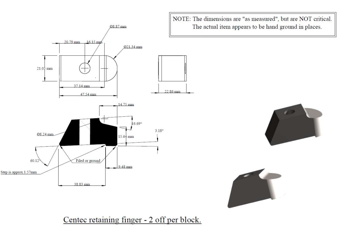

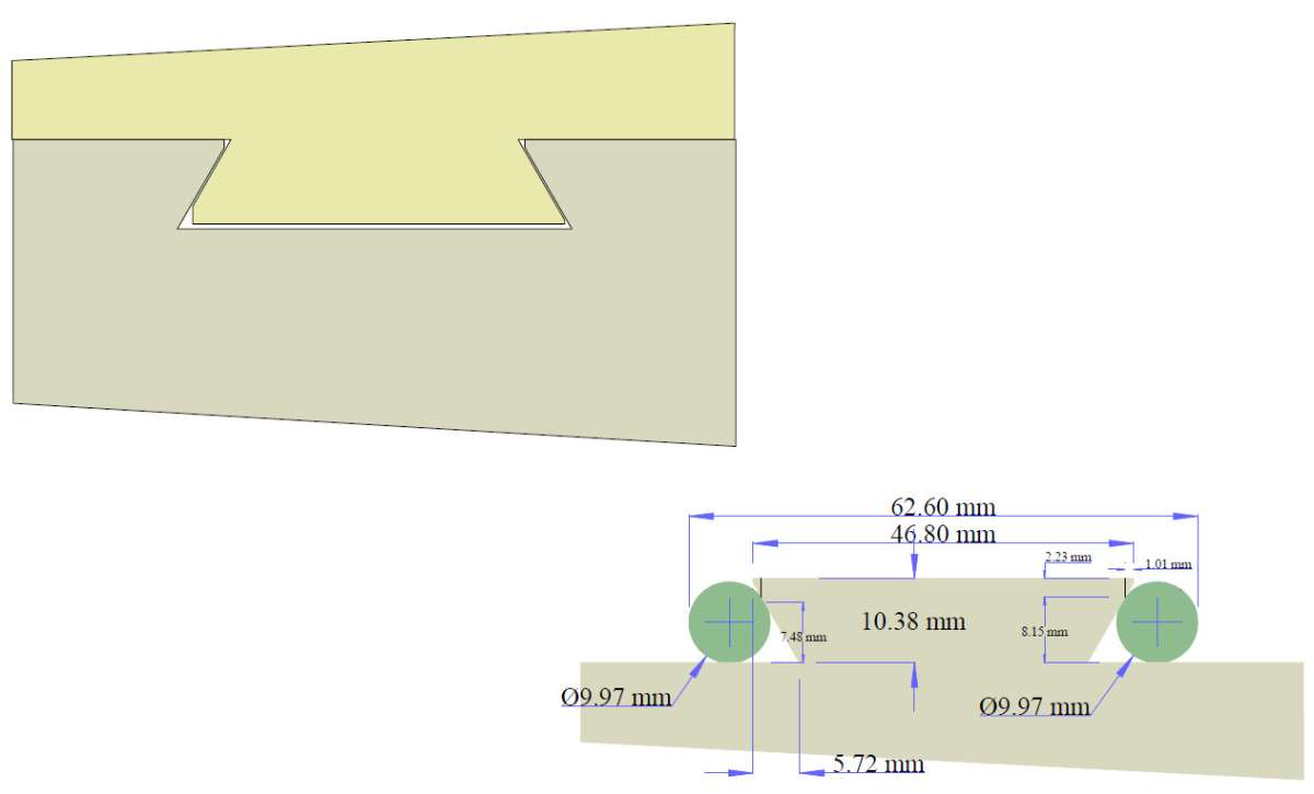

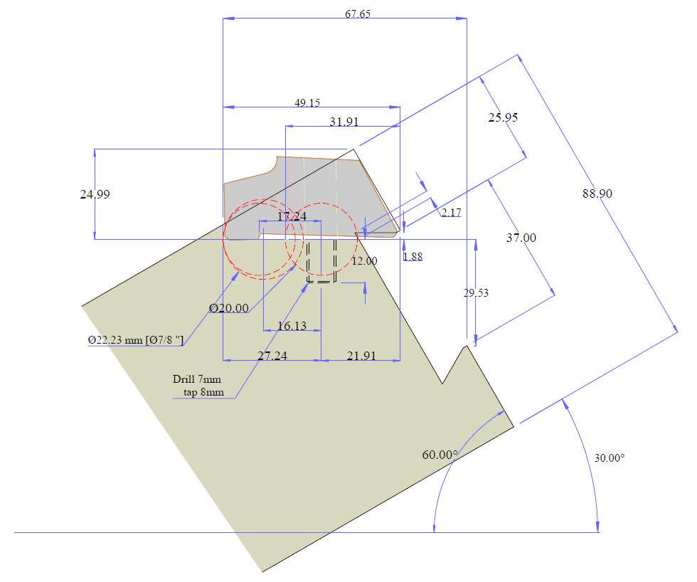

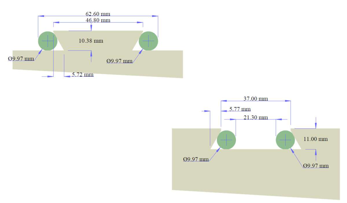

            The depth I used when I made my blocks was 11mm.
            If you haven’t done so, and if it helps, here are JPGs of drawings I created when I made a a number of CenteC RBs.
            They were created for my use only, with no intension of publishing them. As it happens, the fingers were the most challenging.
            (I have no idea why one picture is duplicated – I can’t remove it).
            Centec RB PDF Page1Centec RB PDF Page2Centec RB PDF Page3Centec RB PDF Page3Centec RB PDF Page2Centec RB PDF Page4

                Henry Bainbridge
                  @henrybainbridge40560
                  Brilliant, I have barely started, so these will definitely come in handy, thanks for sharing!
