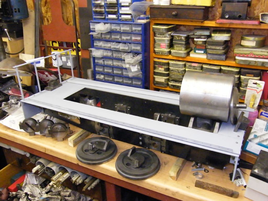

          We spoke via the 7 1/4″ forum some years ago. I ended up getting a set of drawings and have started on a 7 1/4″ model I have the frames erected and castings for horns, saddle, couplers, wheels, eccentrics, smoke box door and front ring, frame stretcher and motion brackets.
          One thing I did wonder about was if the model would be nose heavy and need some ballast in the bunkers and under the rear footplate.

            All engines of this size need as much balast as possible, if you can fill the tanks with lead and have a top up device from a tank on the driving trolley. On my Gemma the running boards are formed from a bar of steel instead of angle, looks the same and adds some much needed weight.
            A proper valve gear fitted to this engine and she runs very well indeed.

              I have uploades some pics, see my album.
              Current progress
