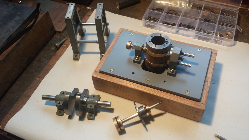

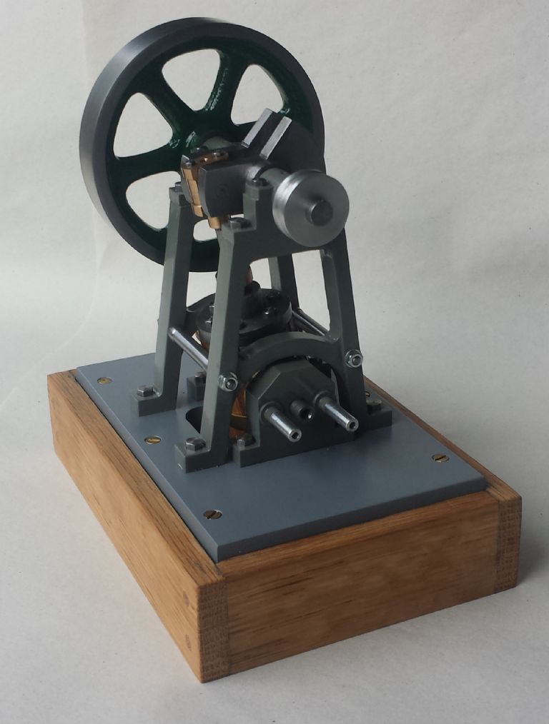

      Hi All,

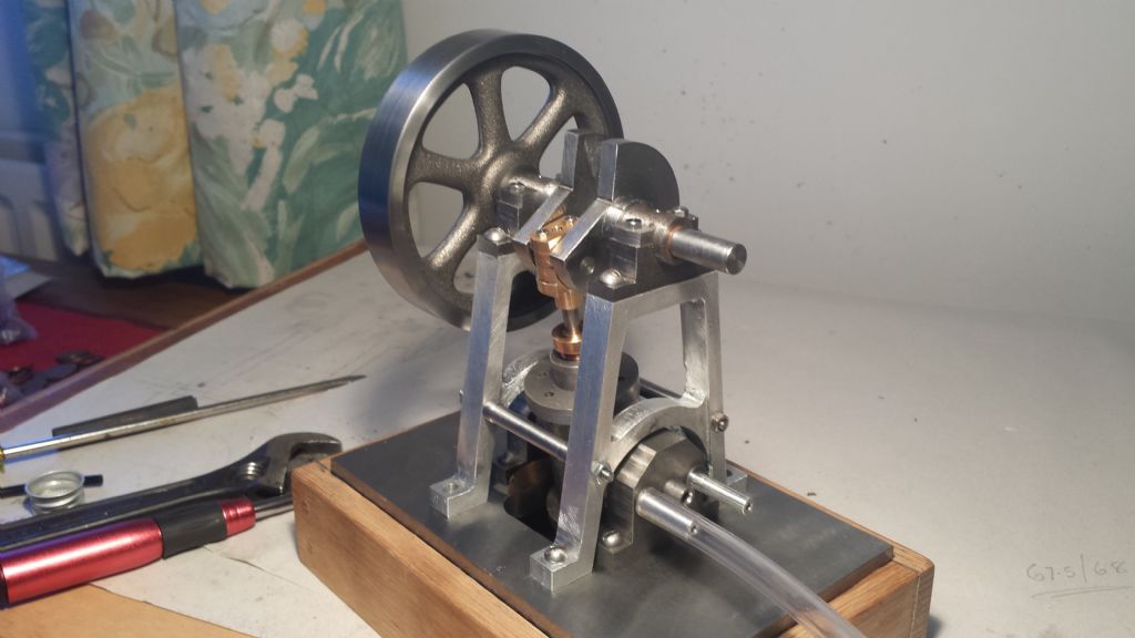

      Last year I made the simple muncaster oscillator, which I enjoyed very much.
      This my latest engine the muncaster d/a oscillator.20190621_200419.jpg
      I seem to have been working on this for ages but with the recent pee awful weather I found myself spending more time in workshop and finally got it running. Only on air and it's a very loose fit, no piston ring, no seals in end caps or stuffing box and with the port face still to be lapped up to the valve block, it's a little "hissy".
      Scaled up a little from original so 1/16" = 2mm which makes handling and machining a little easier.
      It's been good fun and about 85% there. Would like to oak clad the cylinder and of course paint to finish. Hope it's of interest Geoff

        another muncaster

              Jim the drawing is from a book by Henry Muncaster published in 1912, Model Stationary engines.
              The book was reviewed by E.T. Westbury in a series of M.E. articles in 1957. I believe those articles are available online. Sorry I don't have a link but they are easy to google and find.
              If you do decide to make this model, let me know. I have a spare cast iron cylinder casting which you can have for postage cost. The casting is from my own pattern. I had two cast in case I c**ked up one.
              I am also doing a cad drawing which is upscaled so 1/16" = 2mm so the 5/8" bore is 20mm and the 1" stroke is 32mm etc etc.
              Regards Geoff

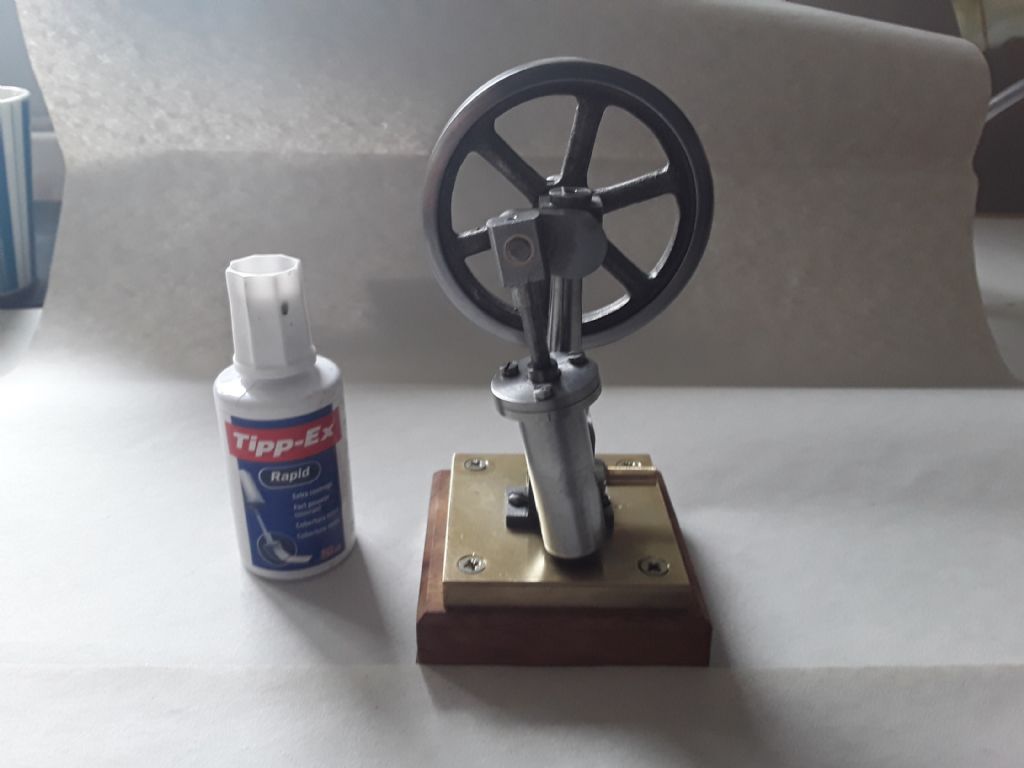

                      I remember your Muncaster, Jason, but at the time I saw it I already had Stu Hart's Vertical Cross which was similar only with a different crosshead arrangement.
                      I've ordered the Muncaster book from Amazon so I'll have a better idea of whether the double acting oscillator (oscoscillator?) is a goer or not.

                          My engine has a cast iron meehanite type cylinder. I have lapped the bore to a fine finish with 1000 grade paste and oil. The piston is gun metal a little under (.050) 20mm diameter, so an easy fit. I was considering using a viton o ring say 17 bore x 1.5 dia section or 16 bore x 2mm section.
                          I have read that cast iron is not compatible with this type of ring.
                          I have some teflon coated yarn 1/8" square which could be another option
                          Any thoughts or opinions anyone
                          Geoff

                              I have used Vitron in quite a few cast iron cylinders both on the air/steam engines as well as the larger hit & miss IC engines and they seem to run fine with little drag and plenty of compression.
                              If you are just going to run it for display then it should also tick over slower with no ring fitted.

                                    #421829
                                    geoff walker 1
                                      @geoffwalker1

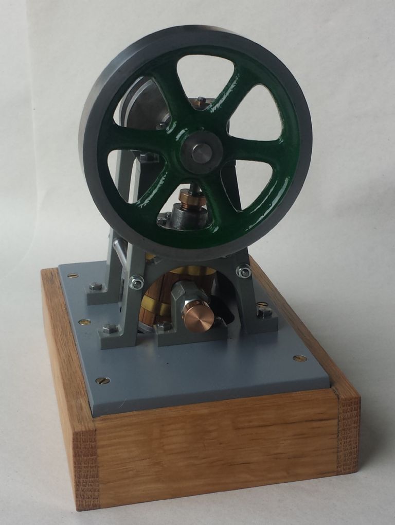

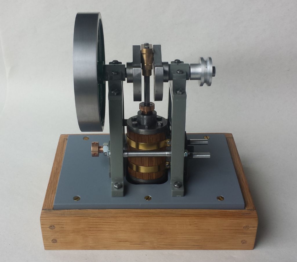

                                      Hi All,
                                      Well, it's all finished, painted, lacquered, etc. or as Jason would say "tarted up".
                                      The base is an oak lap jointed frame with a briwax finish.
                                      The baseplate is heavy, 150 x 100 x 10mm M.S. plate sprayed with a hycote primer and then lacquered to finish.
                                      The frame, valve block, bearing blocks etc. are primed then two coats of halfords industrial grey enamel and again lacquered to finish.
                                      The flywheel is hand painted with a humbrol primer and enamel.
                                      Video of it running is on you tube, search Bobbie jones muncaster double acting oscillator. Seems to be running really well, good balance.

                                              That turned out nicely Geoff, I've added the video to your post.

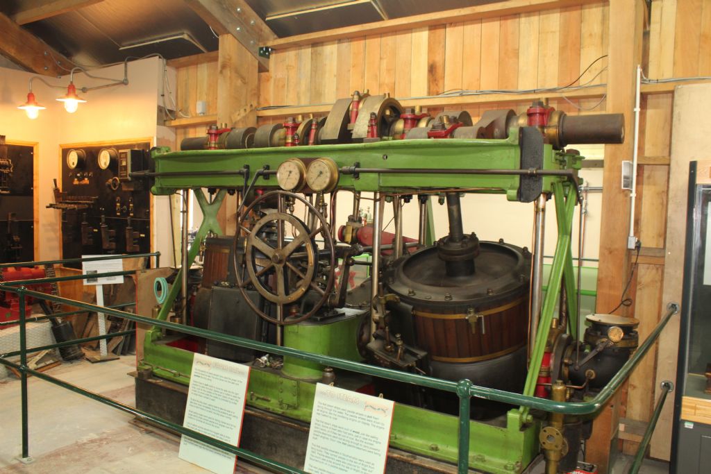

                                                Geoff,

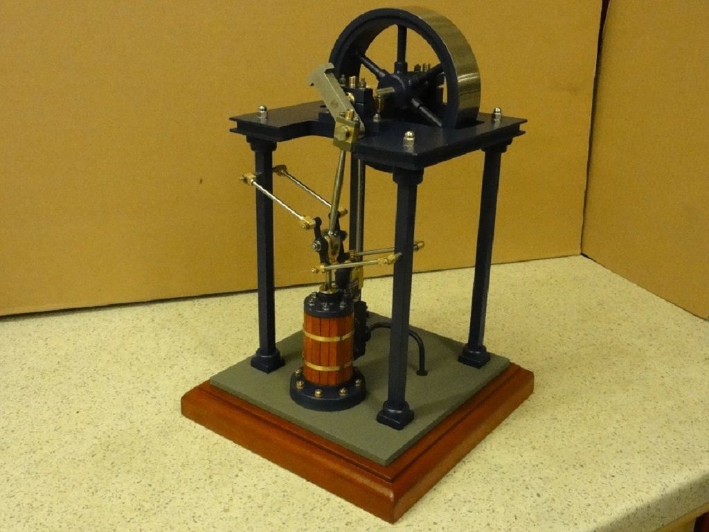

                                                I thought you might like to see this, its a twin cylinder full size version of your engine which came from a paddle steamer, if its not done already its hoped to get it running in the near future, it can be found at the Internal Fire Museum Tan y Groes, **LINK**
                                                Martin P

                                                    geoff walker 1
                                                      @geoffwalker1
                                                      Hi All,
                                                      Thank you gents for your kind comments and J for the video upload.
                                                      Martin, diolch. I've passed through Tan y groes many times on the way to Saundersfoot although not for many years. Will be in porthmadog next month but sadly Tan y groes a little to far south for a visit.
                                                      Ron, the J de W drawing to which you refer is indeed a muncaster engine. J de W's Drawing is 2x full size. I redrew the engine with full size dimensions and made it last year. If you would like a pdf copy of the drawing let me know via a p.m. Here is a photo of the completed engine20180720_164856.jpg
                                                      Atb Geoff
