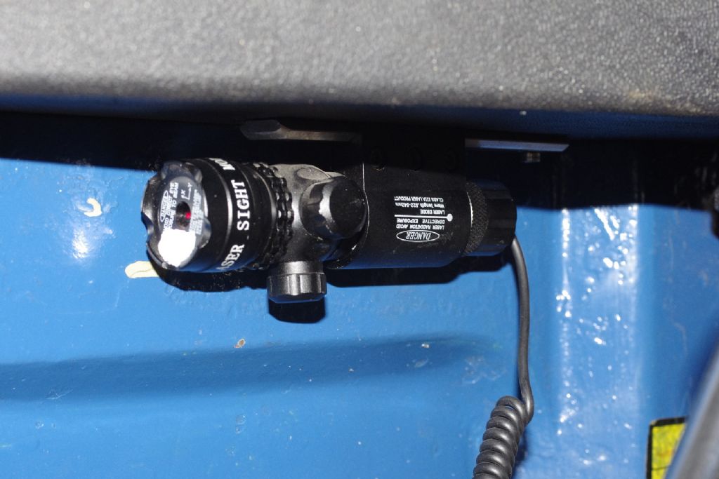

            I fitted a laser on the side of the museum's drill mill, it reflects off a window about 9 feet and back to a white target next to the laser. It is accurate to 0.002" and could be better if I got hold of a laser with a better focussed beam.

                A good set up by old mart but a couple of suggestions for anyone who takes up the laser method.
                Most of these laser pointers can be focus-improved with a suitable collimating lens in front of the device. A reflective metal mirror would be better than reflection from a glass mirror – no aberration due to reflection at surface and silvering, or both surfaces of a window pane. Even a prism, using total internal reflection, might be a useful ploy.

                  I will have to see if there is any improvement to be made in the laser, actually one of those sights that can be fitted to airguns. I have a small spirit level with a built in laser which has a much finer focus which could be used. Despite only reflecting off a window, the return beam is very easy to see.

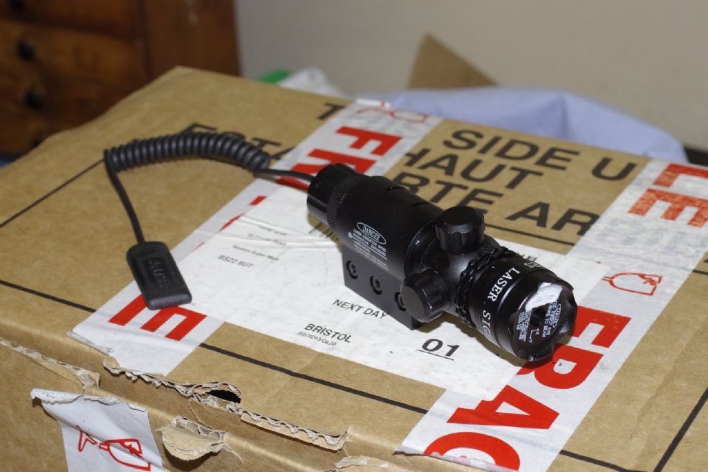

                          _igp2799.jpgHere are a couple of pictures of the laser, from ebay, which comes with a variety of mounts, and a useful remote switch which is shown fitted. The bit of white paint on the end is the target for the reflection. There is no optical adjustment, but after I cleaned both sides of the end glass, the focus is as good as the other laser that I was thinking of using.

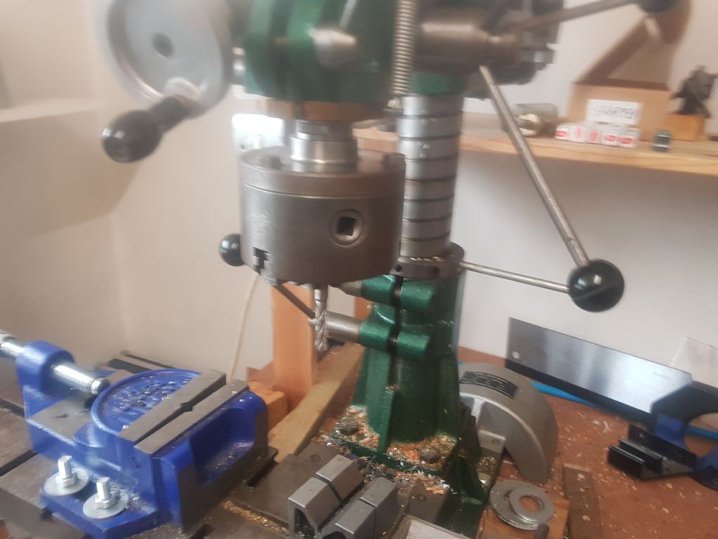

                            Im a bit afraid to ask this question as Im not well school on vertical mills But my DW is a treasure possession and when I asked about end mill and mentioned a 1/2 jacobs chuck I was suitable chastised by 100 lashes of a rhino whip and told to get a proper set of er 25 collets £120
                            I noticed I had a Myford thread on the spindle and as I had bought and eventually fitted a new 125mm chuck – bit of grief there reported alsewhere Myford nose job.
                            I now had a repurposed 4" Burnard chuck properly screwed up tight to the DW spindle.
                            As I had not seen any other references to using a chuck on a mill this way I thought I must be committing some kind of awful sin here
                            In my simple way it seems to work fine, but I never had any formal training on a mill
                            Any advice on my usage here

                              It's not something I would do as the cutter is likely not to run true & may work it's way out of the 3 jaw chuck under cutting conditions? Having said that if you are happy go for it.

                                I should say that although my chuck is 70 yrs old it is in good condition and seems to run true enough for my needs
                                But your point was strongly made about the jacobs chuck – and quite rightly so.
                                Maybe I should use a chuck stop (spider) so the end mill cant slip inwards
                                Its certainly something i shall bear in mind only serious use will show up the deficiencies

                                  Hardened Jaws don't grip end mills very well, you could maybe try soft Jaws, but still a bad idea in my opinion.
                                  I wouldn't want all that weight on the spindle anyway, but that's just me, treasured possession?
                                  Just get a collet chuck, if you decide it's not for you, you'll have no problems selling it with the machine.

                                    Get cheap collets to hold the cutters and use solid carbide cutters about 6mm to buzz through the work at high spindle speeds

                                      It's often more a case of the cutter pulling out of the chuck rather than riding up into it particularly if using a lot of the side of the cutter as the helix pulls it down. Although true the jaws may still have worn over 70yrs and become slightly "bellmouthed" so won't grip well along their whole length.
                                      I've done it a couple of times in the past when milling on the lathe but would not do it now that I'm wiser as I have better ways to hold cutters.

                                        This is Auntie Doreen we are talking about, max speed 1650
                                        What you are talking about is 3000 rpm + for MS

                                          OK JB I hadnt thought of bell mouth
                                          I will check on this
                                          I presumably could re grind the jaws in situ, or maybe use a Covid cutter to skim out the jaws parallel (i realise this is not as easy as it sounds)
                                          "helix pulling the cutter out"
                                          I hadnt thought of that, it would explain why i ended up with a deeper cut than when I started on one job

                                                Brian, it was advised you buy a collet chuck from decent supplier because often the ebay specials are substandard.
                                                But if it's a choice between a 3 jaw chuck or a potentially not fantastic er collet chuck, I'd give the collet chuck a chance,
                                                It’s not a cheap hobby, some things you need, some you don't, a proper way of holding Miller cutters is definitely one of the things you need, not really much point owning the mill otherwise, it's like people who buy fancy cars with massive engines but can't afford to put petrol in them
