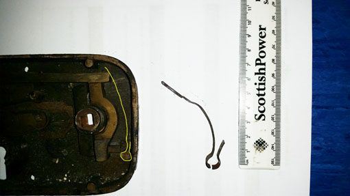

        I have been asked to repair this old door lock. The 10mm wide, 0.5mm thick spring has snapped where it fitted over a 5mm pin. I have tried to sketch this in the photo. What is the best method to create this? I can buy different sizes of spring steel flat from RS Components but I assume that this can not be bent.or would I form it from mild steel and then heat / temper it?lock spring.jpg

          It is a spring, so it is not mild steel and you will have to search for spring steel. Forming it hot and then harden and temper.
          Clive
          #229802
            Reeves do annealed spring steel strip in various weights and widths just form and harden

                  Lots of ideas there thanks. I have ordered a length of annealed spring steel from Reeves, well two actually as I'm learning
                  I will try and learn the art of hardening and quenching in oil. I will also visit local locksmiths. I have visited one – he said, sorry mate, that lock is too old, you'll have to buy a complete new one. The lock is from an internal door at my church, so about 150 years old.
                  Good idea Neil, the photo is not to clear, the end of the long arm has also broken off about 15mm down.

                      Andy, best what is make a former to make the bend, it will need to be a little smaller than the finished peg size though looking at it's function it is not too important as long as it fits the peg in the lock. Harden by heating to a cherry red, quench in oil. Now comes the tricky bit, tempering ! One method is to blaze off in oil or tallow. The idea is after quenching hold the spring on the edge of a soft flame i. e. not full power on you torch, and turn regularly until the oil ignites then move out of the flame but hold it above the flame thus adding a small amount of heat to keep the oil,alight turning regularly . You may have to add a little more oil just befor the flame goes out and continue until this burns off. Then you should have a spring ! You can dip in tallow and burn off, tallow has a higher ignition point than oil thus a higher tempering temperature.

                                    Thanks to everyone for your help. I bought two lengths of annealed spring steel from AJ Reeves. Yes, it was very easy to form into the shape I needed.
                                    Heated it until straw colour (as hot as I could get it) Immediately quenched it in cold water. Quickly dried it with heat then put it in engine oil (all I had at the time). Removed from oil then burnt off oil with gentle heat until dry. Put it back into the lock and hey presto, it worked a charm!
                                    I must admit, this was after a couple of attempts. One spring just snapped like a piece of glass, another one just failed to return to its original shape. It seemed that when it was straw colour, it had to be quenched very quickly. I was heating it right above the can of water so I could just drop it in.
