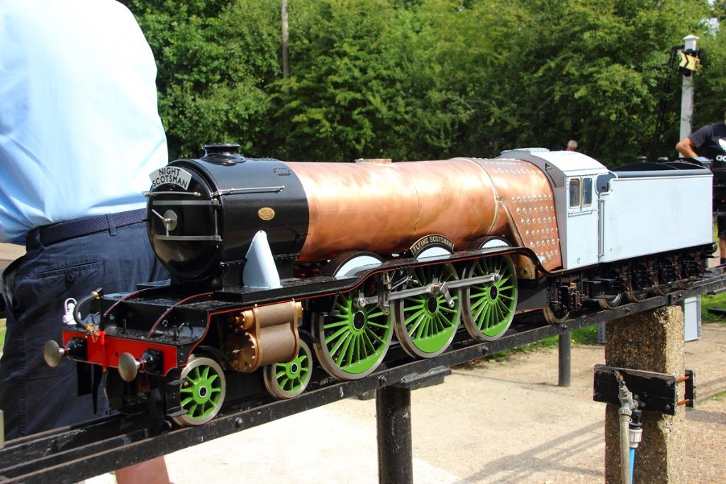

        Hi everyone
        This thread is really in response to another topic where it was pointed out about the lack of threads on locomotive builds and so I thought that I would do my bit for the forum in helping to add more content. However, I'm not going to start a build log here. Some may have seen or even be following my articles currently running in ME and thus don't want to take away from the editors hard work.
        I did think though that what I could do is to start this thread for people who wish to know more about my quest to build a highly detailed model of 4472 or have a specific question about the build. feel free to ask ask here and get a quick and honest response directly from thehorse's mouth' so to speak. This is perhaps something a little different, whether it's of interest to other members here? well, only time will tell..
        This image was taken two years ago at an event to commemorate the late Bob Todd, held at my home club track, NLSME. The model has moved on a very long way since 2018 but this was the last time that she was assembled (only for that day) and so perhaps the best picture to post to see her true form. She is being built to show her as she would have been seen in 1938 although there is a little modellers license which has already been detailed in the magazine. Everything is being built either to scale or as close as humanly possible and most parts are planned to be working. Well except for carriage heating, the gauge will work though..
        Anyway, as I say, I'll try to answer any questions that may arise during the series here asap.
        Regards
        Pete
