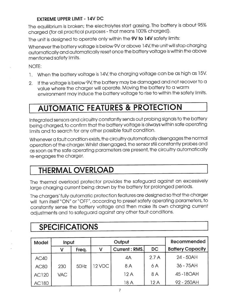

                                                      I bought a Clarke AC180 at a Car Boot Sale a few years ago … It’s vintage 1999 or thereabouts, but Clarke kindly sent me a copy of the manual star
                                                      This page may be of general interest :
                                                      d82aedd8-6c5c-4964-9771-d80b63e7c1fb.jpeg.
