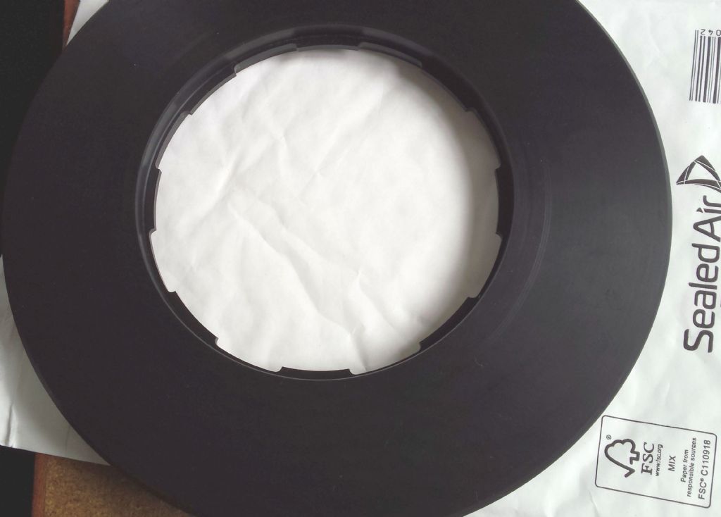

      I have a Steve Ward controller on the stepper motor of my rotary table and use it frequently for fairly conventional dividing purposes with no problem.
      What I want to do now is mill segment of a flange away to create an 8 eared bayonet, sort of horizontal castelations. I want the table to rotate a certain number of degrees after I have lowered the cutter and then stop so I can raise the cutter. The table then needs to rotate to where the next cut starts so I can repeat the process eight times.
      I presume the indexer is capable of what I want to do but I don't really know where to start with programming it hence asking if anyone programmes theirs?

                    I did not state but Jason surmised correctly that the ears and gaps are not equal. However the 24 division reply has given me an idea of how it can be done.
                    Using the loop command the programme could probably be very simple with only a few lines. I have not yet used the stepper whilst the mill is cutting but with another read of the manual and some unpowered testing will have ago.

                          I have just done a dummy run. I programmed it to move 19.5 degrees, wait, move 25.5 degrees, wait, etc and loop round 8 times. looks OK in mid air.
                          My bayonet has 8 gaps cut into a 2mm (radial depth) flange inside a 120mm bore leaving the 8 ears. Material is acetal and I'm using a 4mm cutter so will be doing it shortly.

                          Ian P
                            @ianp
                            Just done two of these.
                            All went OK but next time I will make the loop twice as long, or better still infinite. That will save having to restart the programme after each 360 rotation (easier for taking roughing and finishing cuts.
