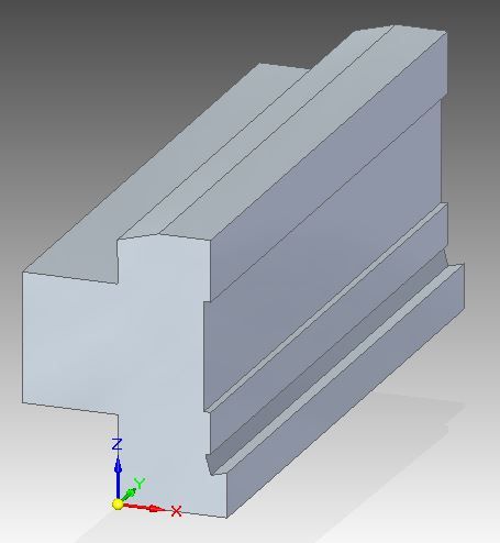

        I've ordered one and probably won't see it for a week or two. In the meantime I'm making up a toolholder for it to suit my Bantam QCTP.
        I'm wondering what the height of the blade is. And before you say 32mm, I'm pretty certain it's less than that. The 32mm seems to refer to the maximum height dimension of the rhombic space the blade fits into. However, as both sides of the long faces of the blade (the 150mm long ones) are chamfered at 15 degrees, the resulting height of the blade will be closer to 31mm I suspect.
        They say it is compatible with industry std 32mm blade holders so perhaps a different make may also have the same dims.
        This snip from the Korloy brochure illustrates my point. "H3" is 32mm, so what is the height of the blade? When I model it in CAD it comes out just over 31mm.
        Any real world measurements would be very helpful so I get it right in the absence of the real blade. Thanks.

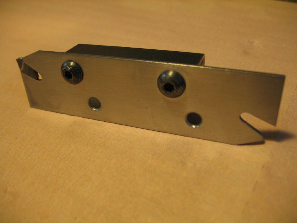

          You could also make you own blades like I did.
          The one shown below will fit into a standard 26mm block too.
          Martin.

            CAD model for Bantam-specific blade holder coming along. Basic section defined and extruded. Model of blade ready for assembly. WIP…..
            Planning to use an end mill for the 15 degree lower lip.

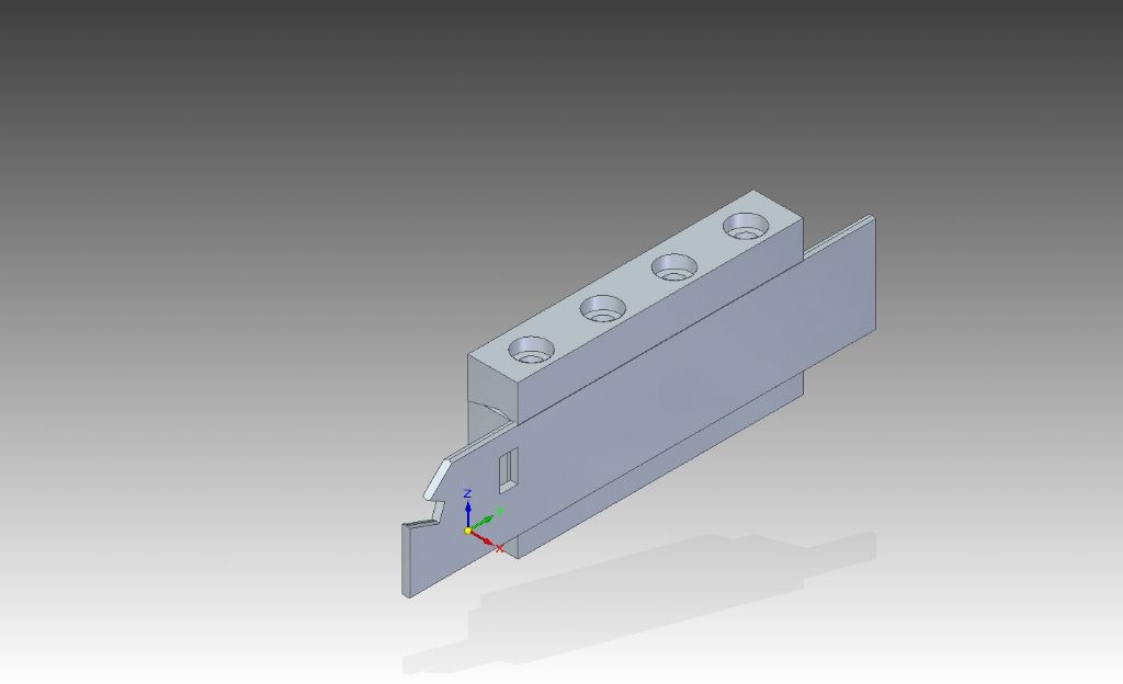

                    The other outcome of the modelling will be a block that works for a 2.4mm thick blade. The clamp is for thicknesses up to 5.3mm. I will make mine for only the 2.4mm blade and will thus avoid the "jaws" at the top and bottom sticking out by 3mm more than they need. Here's what I have so far: The insert feature is only approximate – I have no measurements to go on but it doesn't matter anyway apart from getting the cutting edge height roughly right, which I believe I have(!) – it's a Dickson type adjustable toolpost.
                    Latest assembly for parting tool

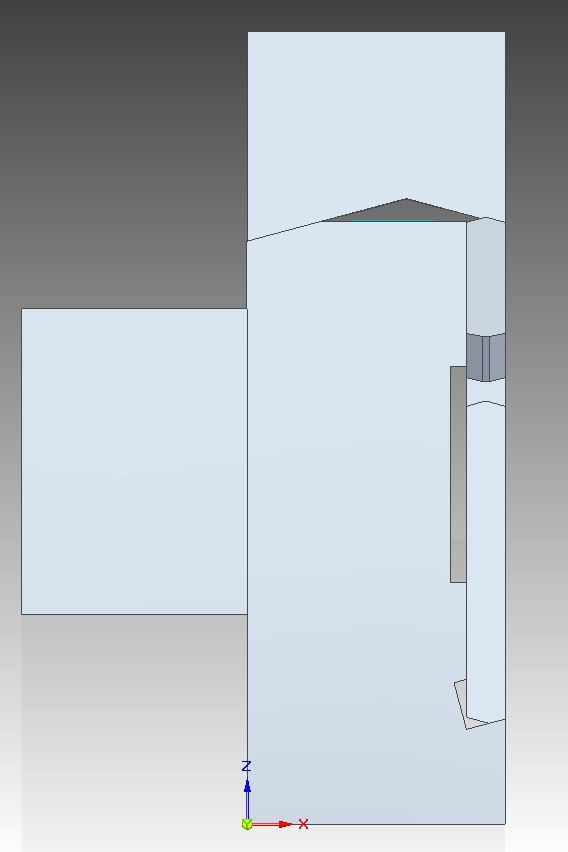

                      I've now finessed the dimensions and constraints so that the clamp bar contacts the holder and the blade correctly and created the drawings I'll need to make it. Hope I haven't missed anything off the drawings….
                      final end view

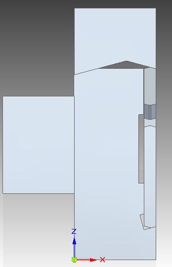

                      This is one view of the trickiest part, dimensioned to suit my Bantam and its Dickson QCTP:
                      final dims
