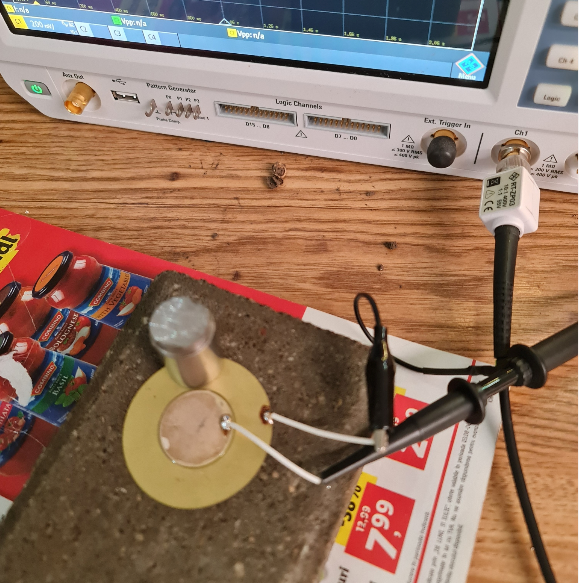

      Today I opened the alchemy lab. I made a concrete recipe with ratio 1:1:1.5 (cement, sand, gravel). The result should be a high strength concrete (C40). Also I added 2% plasticizer.
      In the second sample I add also polypropylene fiber (SikaFiber PPM12). The recommended usage is 0.6kg for one cubic meter of concrete. When I scaled the quantity for my small batch I got to many 0 after decimal point. So I add 10g of fiber. This proved to be way to much. The mix was no longer homogenous.
      Also I refined the test method to evaluate different concrete recipes. I used a large piezo transducer as a vibration sensor. It’s high impedance is a good match for the oscilloscope input.
      I made some tests with a piece of concrete I found in the garden. I discover that if I hit the block the results are not very consistent. Instead, if I suspend a weight and then I drop it the repeatability is perfect. Bellow are two consecutive tests:
      And this is the whole process:
      The only problem is that the results are very sensitive to location of the piezo sensor. I’ll do more tests when the two samples are cured.

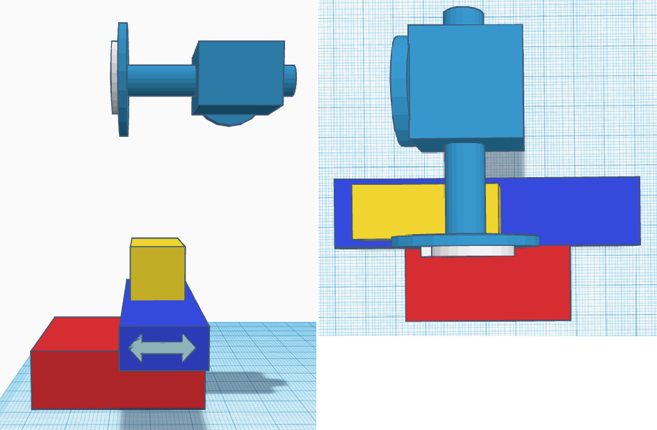

            I made a basic 3D model of the SG just to have an idea about the dimensions. I assumed the magnetic chuck is 400x150x50mm. The spindle is the one from the previous post and the grinding wheel is 30cm in diameter. The yellow piece represent the chuck + a 100mm thick concrete slab that will move along the X axis. Blue is moving along the Y axis over the red base. The stack looks tall but it includes also the space required by the linear guides.
            The problem is how to connect the spindle. If I want to have some 40cm maximum clearance between the grinding wheel and the magnet chuck then I’ll need a large vertical support block connected to the red base. This one alone would weight >200kg. Not a problem for my workshop crane but still … something doesn’t look right
