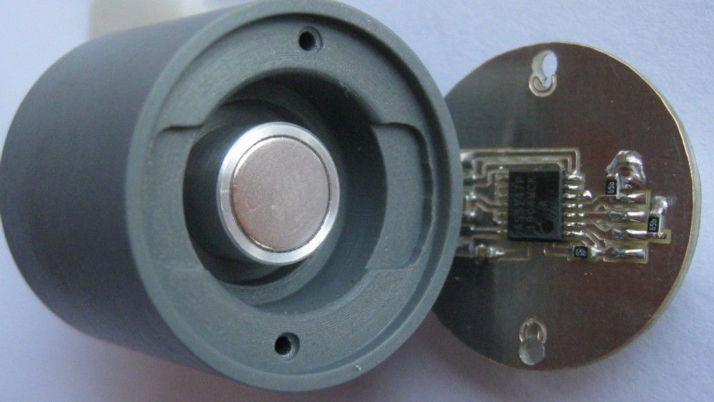

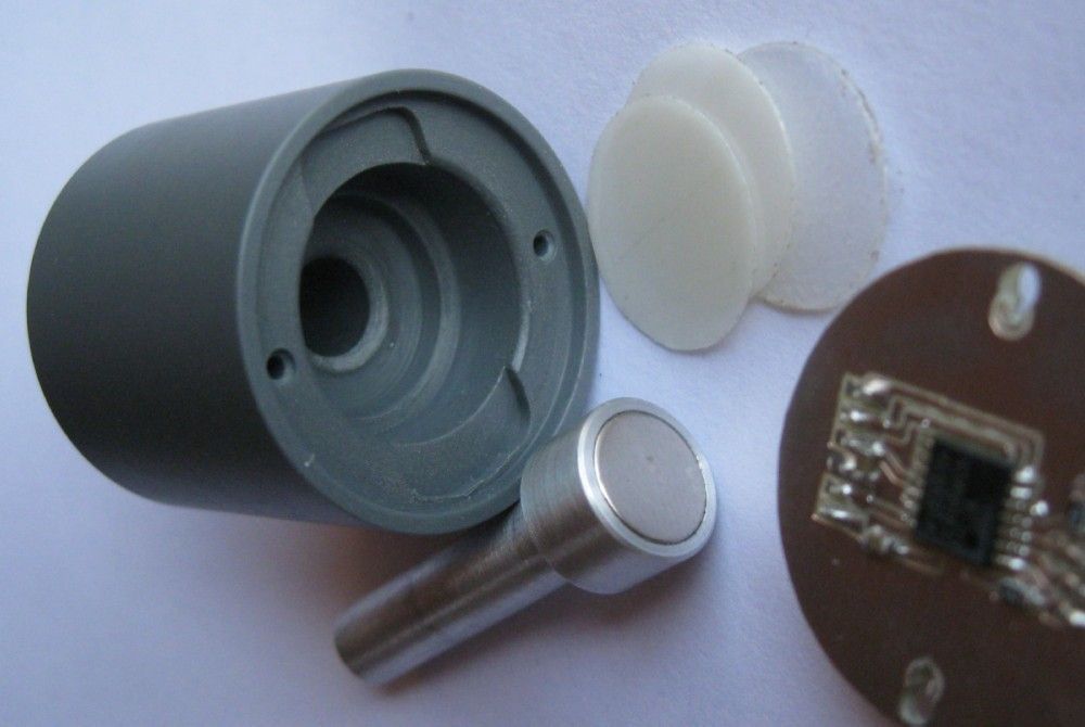

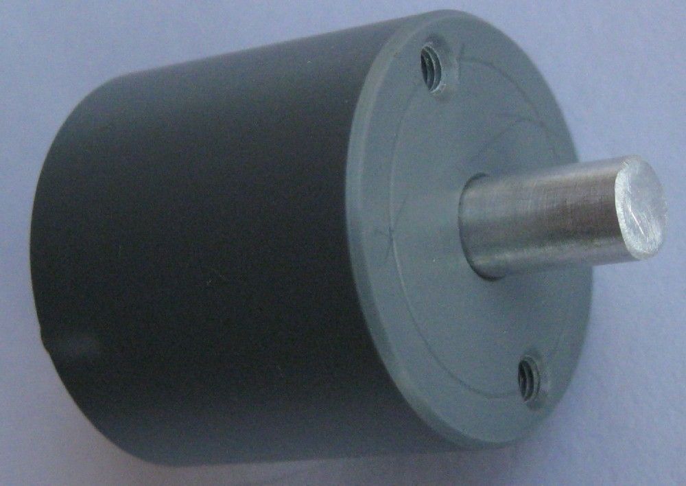

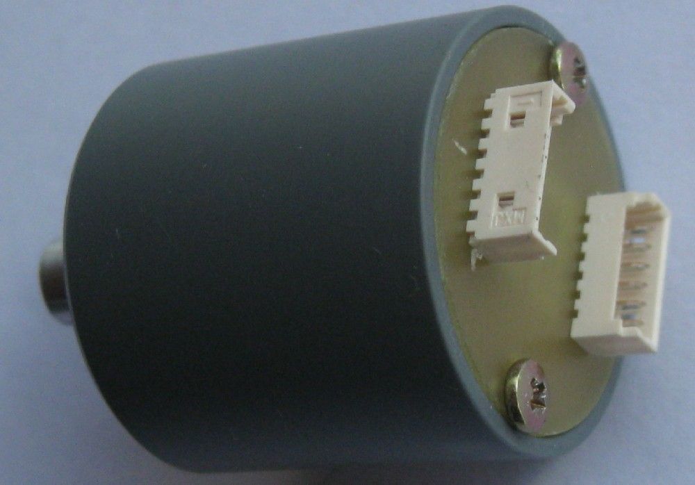

I knocked up a prototype to test, just used some PVC rod, with an Aluminium shaft holding the magnet
If higher performance ( speed..) is needed, bore out the ends of the PVC body shaft hole to take 2 x 6mm ID bearings..

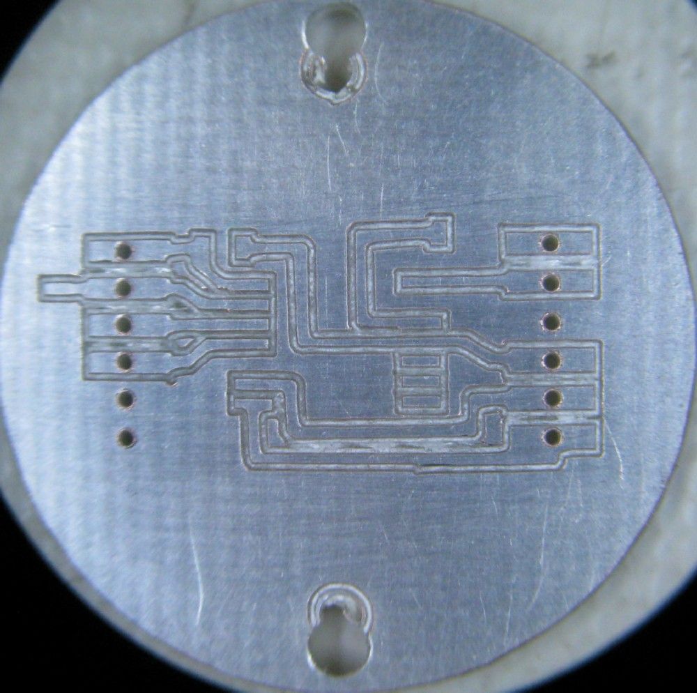

26mm diameter PCB for the device:
PVC Body, the magnet in the shaft and the pcb assembled
