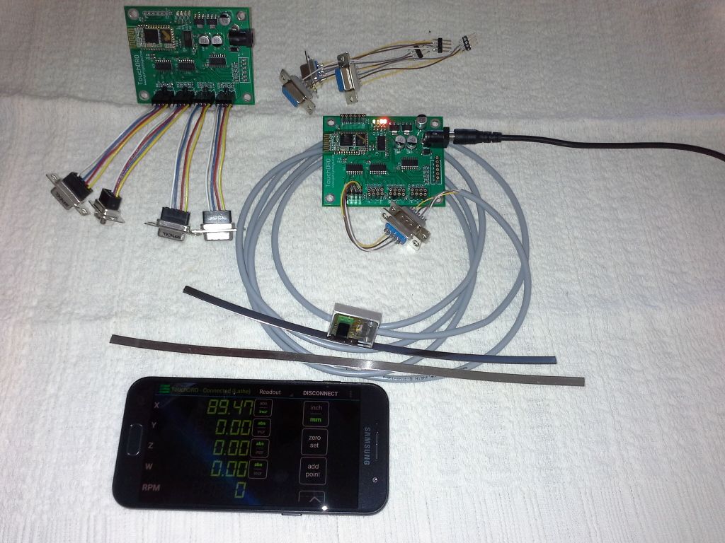

      Hi Beaker, thanks. I did progress a bit further with these DROs.
      I received the TouchDRO adapters from Yuriy some time ago. I downloaded the TouchDRO app on a tablet and connected via bluetooth to the adapters – it's very neat and clear and has lots of functions.
      Next I hooked up the read heads to the adaptors to check if they actually work – moment of truth!
      I did a temporary set up as I have not attached the read heads and magnetic tape to the lathe and mill yet, so I just slid the read head over the tape by hand on a table, surprise surprise it worked!!
      I had a small hiccup as I found that one of the adapters had a defective input channel so I contacted Yuriy and did troubleshooting together. He confirmed that part of the board was defective so he sent me another one – thumbs up for his aftersales.
      Next step is installing the tape and read heads on the lathe and mill and calibrate the scales, but I'm holding off for now. It's unbearingly hot in the workshop and I can't concentrate in this heat – I desperately need an airconditioner!

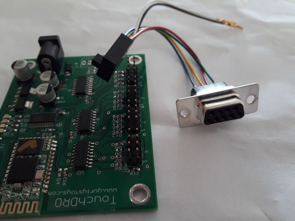

        Being too hot to work in the shop I retreated to my study (thank God for the ac!) trying to figure out how to connect the read heads to the TouchDRO adapter.
        I have a question regarding this connector (9 pin type). The circuit board came with these female ports – they look like a LCD/monitor type connector (don't know the name). Now I need to connect the read head cable to these ports. All cables with this type of connection I've seen (like data cables) are molded to the plug.
        Does anyone know what connector I would need, or is it a case of buying some 9 pin data cables, cut the plugs off and solder them to the read head cable?

          Search fo D sub or D subminiature, widely available from electronic suppliers.

            Hi Mike, thanks for pointing me to the right direction. Something like these links should work I guess.

              Yes Chris that is what you need.

                Hi Mike thanks. I got the connectors yesterday (backshells out of stock arrgh!) and soldered all the connections – tedious job as the wires are so thin! Anyway, I hooked up the readheads and checked them one by one, and after sorting out a couple of crosswired connections, got them all working. Next step mount the heads and tape on the machines and figure out how the DRO app works!

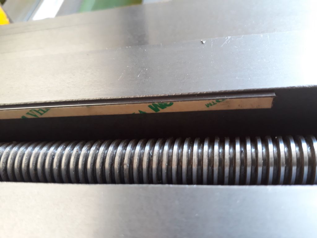

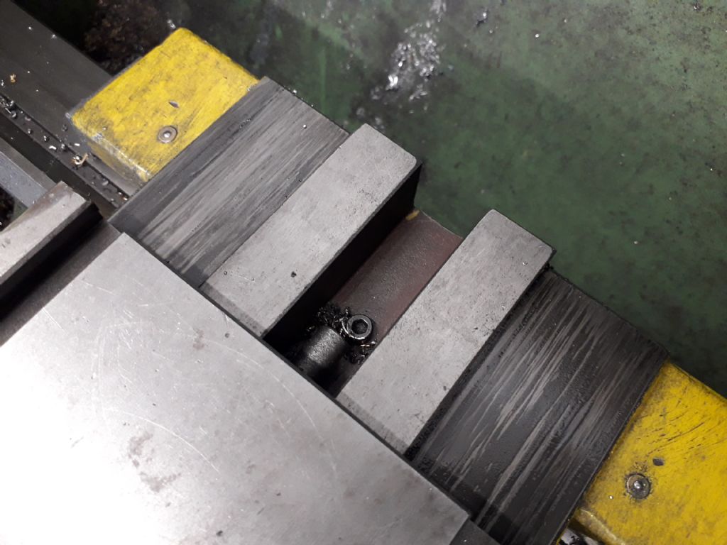

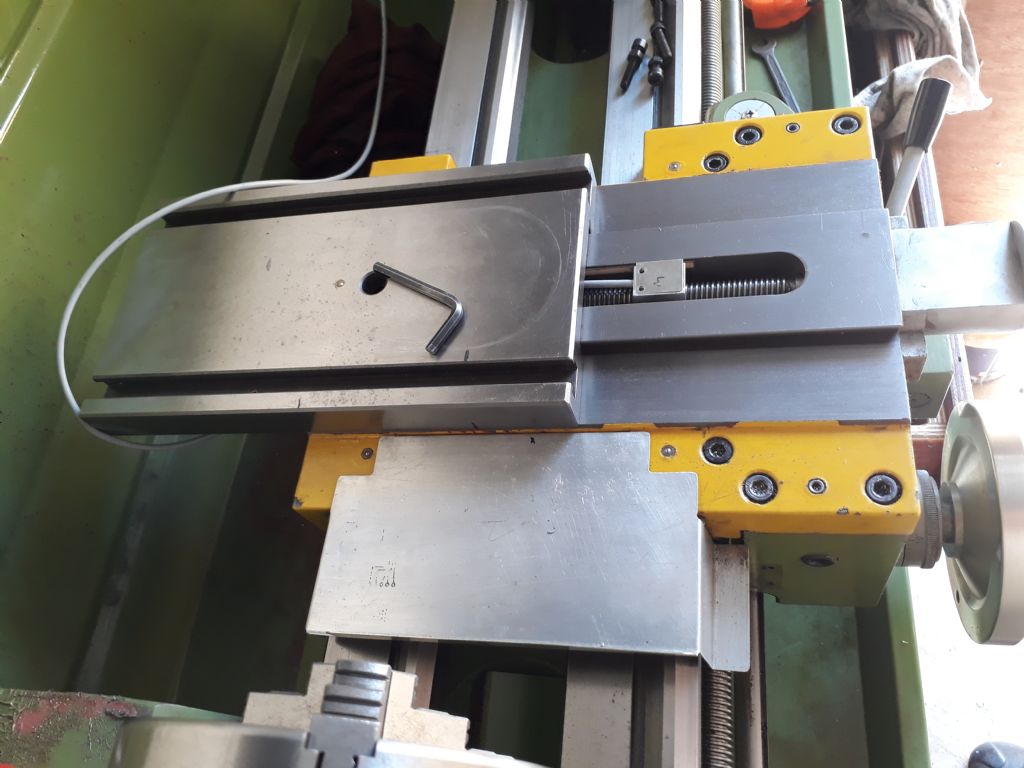

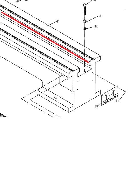

                      I'm in the process of installing the DROs to the mill and lathe now. The plan is to stick the magnetic tape (supplied with double sided tape) directly to the machines and then fabricate the brackerty for the read heads. Started with the brackets for the mill first and that's almost sorted – I just need to install and align everything to the table and column.
                      The lathe on the other hand is a problem – my plan for the Z axis is to install the tape directly to the bed shown in red in the picture below. The read head I'll install under the carriage – should be protected from unwanted hits etc and excessive swarf and oil.
                      The X axis however id proving to be a bit of a headache. Preferably I would like to install the magnetic tape directly to the cross slide aft face (tailstock side) but the gib screws are getting in the way. Most X axis installations I've seen seem to extend quite a bit back onto the tailstock area and I would like to avoid that if at all possible.
                      Would it be a good alternative to install the tape and head on the forward (chuck) side?
                      Ps the lathe is a WM280, I would like to know how owners of this type or similar lathes got around the installation of the X axis readout
                      Edited By ChrisB on 25/07/2019 19:19:46

                        on my 280 have thought about putting the strip on the underside of the cross slide offset slightly above the lead screw, there looks to be just about enough room to also get the read head (small emsi) in beside the screw or maybe a small extension out the back so the strip can be longer and you get more room for the head.
                        Is the double sided tape solvent proof? I would worry about paraffin or WD40 dripping onto the Z strip

                          Posted by JasonB on 25/07/2019 20:26:05:
                          Excellent idea Jason thanks! Would have never thought of that.
                          I think that might just work, will have a look tomorrow morning and see if things fit in. The read head is very small it's 25mm long by 18mm high (might be smaller than the emsi ones) so it might squeeze in.
                          As for the Z axis, the adhesive tape looks like its quite resistant to chemicals…according to the RLS website FAQs regarding the tape. **LINK**

                                Took the cross slide off this morning to see if the read head would fit next to the lead screw. Unfortunately there's not enough space, my read head is 7mm wide and the space between the lead screw and slot in carriage is about 5.5 – 6.0mm.
                                There seems to be just enough space above the lead screw however, so if I mounted the read head directly to the under side of cross slide directly above the lead screw, and then installed the magnetic tape to the side of the slot in the carriage, it might just work. Will take a some pictures as it's difficult to explain with words sometimes!

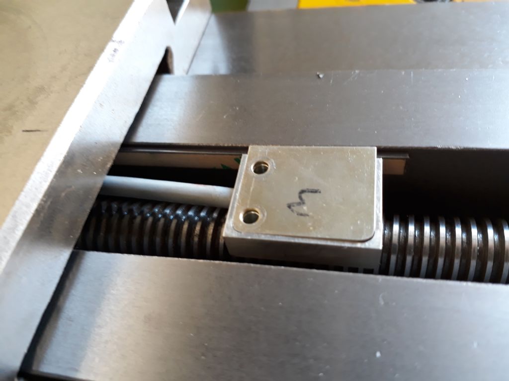

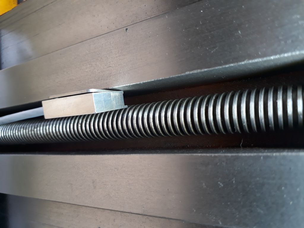

                                  Photos as promised:
                                  As can be seen in this photo of the carriage, there is not enough space for my read head to fit in next to the leadscrew, (7mm wide head)
                                  However I can install the magnetic tape to the side of the slot in the carriage where the cross slide lead screw lives. ( note: the tape is the other way round holding on as it's a magnet – still not 100% committed so did not install it permanently yet)
                                  The read head just fits in the space above the lead screw between the carriage and cross slide. I can install the read head in the position shown in the photo below. The head will need to be secured to the bottom of the cross slide and the head cable fixed securely out of the way of the lead screw.
                                  I think this might just be possible, but I would like to know what's your opinion, especially Jason's (since he came out with the original idea!)
                                  Edited By ChrisB on 26/07/2019 13:34:59

                                    I think where you show the head in the last photo will clash with the nut when the cross slide is wound fully towards the operator.
                                    Why not put it right at the back, the screw does not extend the full length so you don't have that in the way or risk catching the wire
                                    What are the 3 dimensions of your head and I'll take a better look at mine later. This is a photo I took a while ago of where it would fit with the mag strip extended out the back by 50mm or so with the extension also serving to protect head and scale from swarf.

                                      Posted by JasonB on 26/07/2019 14:14:34:
                                      I think I did not explain myself properly Jason. My intention was to install the head aft of the nut (approx 20mm aft of the grease point) The head would be installed directly to the underside of the cross slide and as the nut is also bolted to the cross slide they should not come into contact. My picture above is probably misleading, as the head should be under the cross slide (but then I don't have X-ray photo capability yet!)
                                      I got your point now Jason, yes at the back in the area you point out in your photo the head should fit nicely I think. It's dimensions are 25mm long, 18mm high, 7mm wide. the tape and foil cover is 1.7mm thick and I need a gap of about 0.3mm. So I'd say the total height of the head and tape should be 20mm.

                                          That looks like a plan, there seems to be about 9mm between the top of the screw and underside of the slide so your head will fit there. Strip may be a bit close on the nut but easy enough to shave a fraction off one side of that if the strip needs a bit more room.
