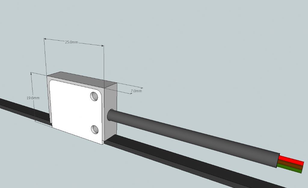

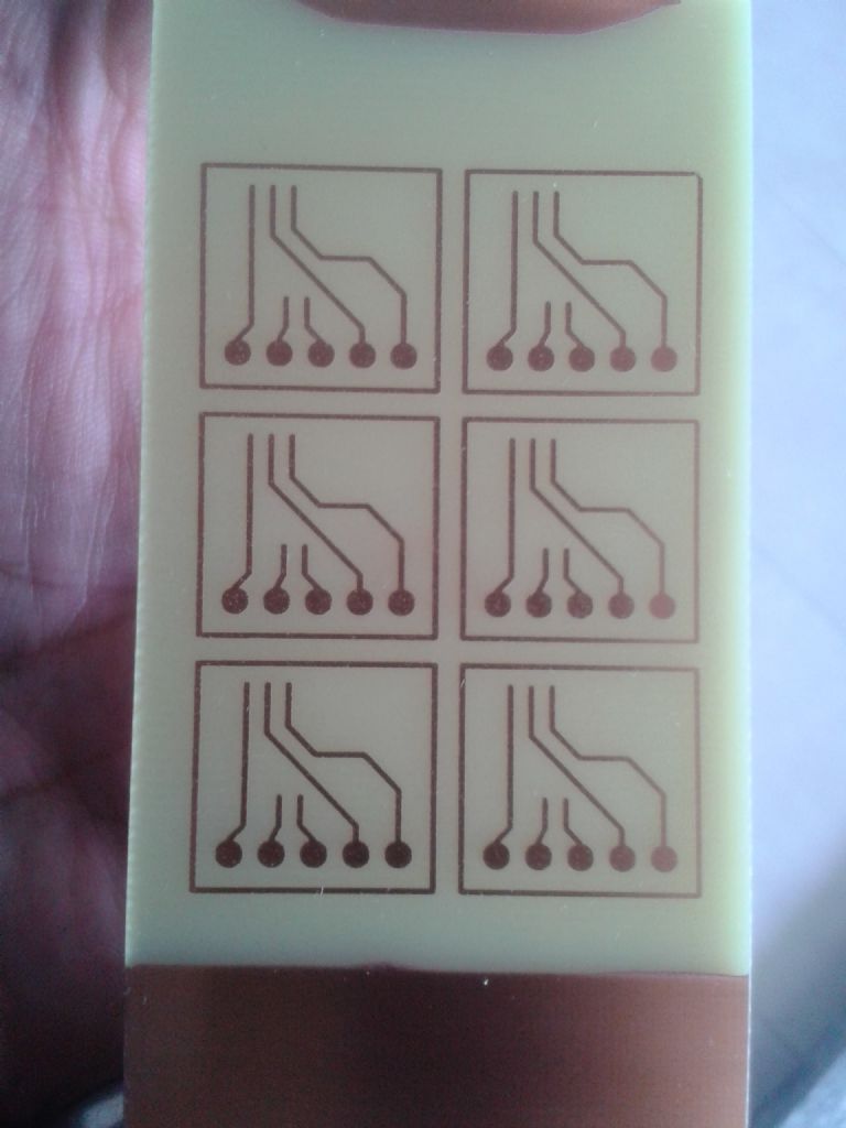

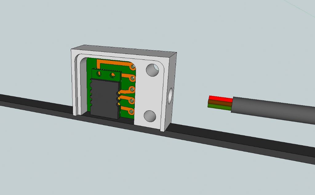

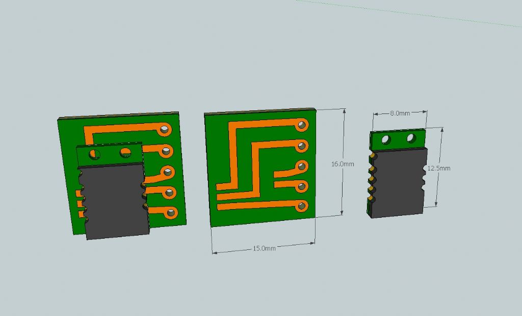

              So until I get the encoders which are on order I'll start with the preparation. I need to print/etch a small board to mount the encoder on as I'm never going to be able to solder wires to the encoder chip (the contacts are less than 1mm apart!) Then I'll mill the encoder housing out of aluminium and try to make all fit inside.
              Started off with some drawings to get a good I idea of how things will fit in.
              Overall read head dimensions will be 25x20x7mm, compact size so it will not get in the way and hopefully makes installation easier.
              Internals, encoder inside the read head,
              The boards I need to build and the encoders which are on order.

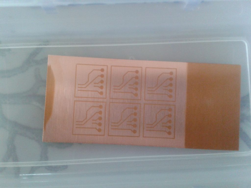

              I have a day off today (my birthday!) so I'll get on with these boards this morning – it's an experiment as I never did a board before but youtube and the internet is very helpful!
              I'm using a photoresist pcb board, developer and a homebrew ferric chloride etchant… let's see how it goes!

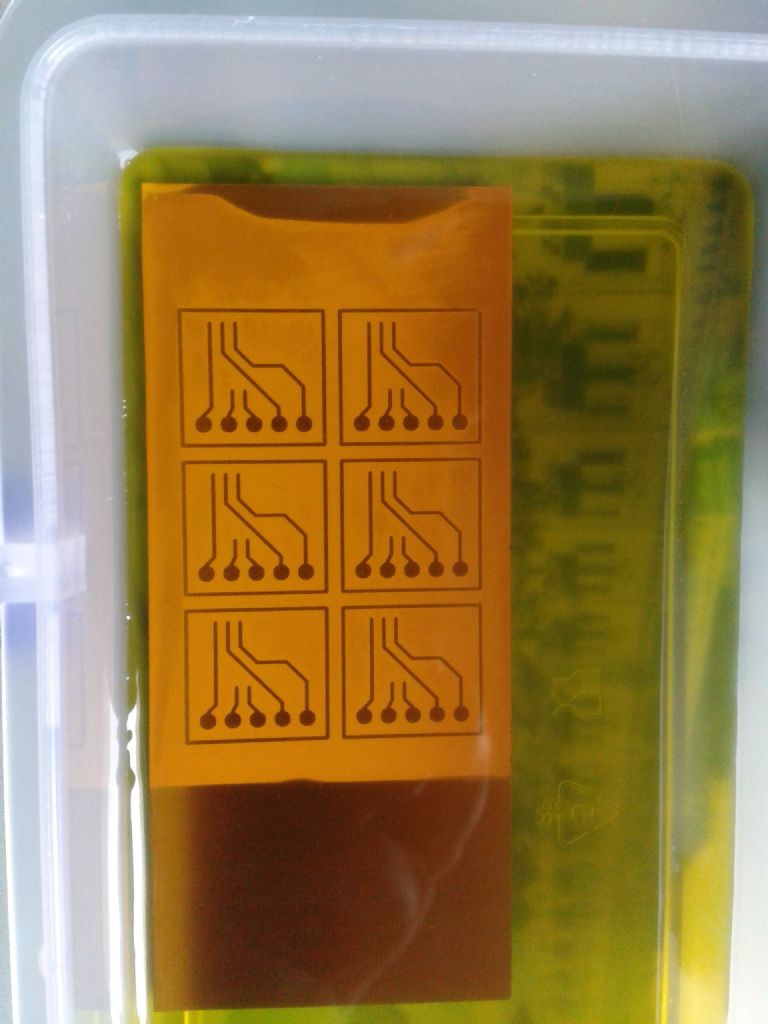

                        Works in progress: The PCBs are developed and being etched, so far so good!

                            The circuit boards have etched nicely, I will need to trim them to size and drill 1mm holes at the 5 solder points for the wires. Not sure how to cut them to make them identical…might take them on the mill rather than sawing them off.

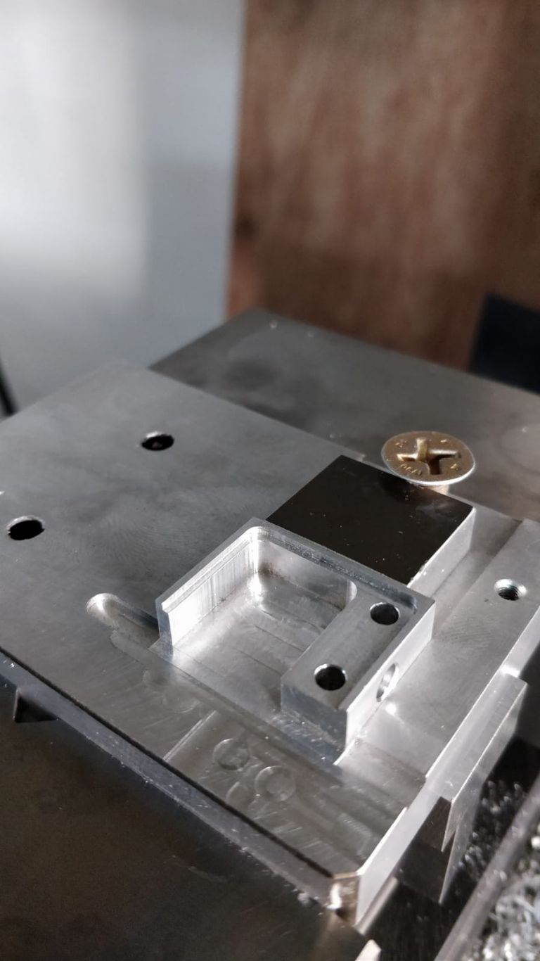

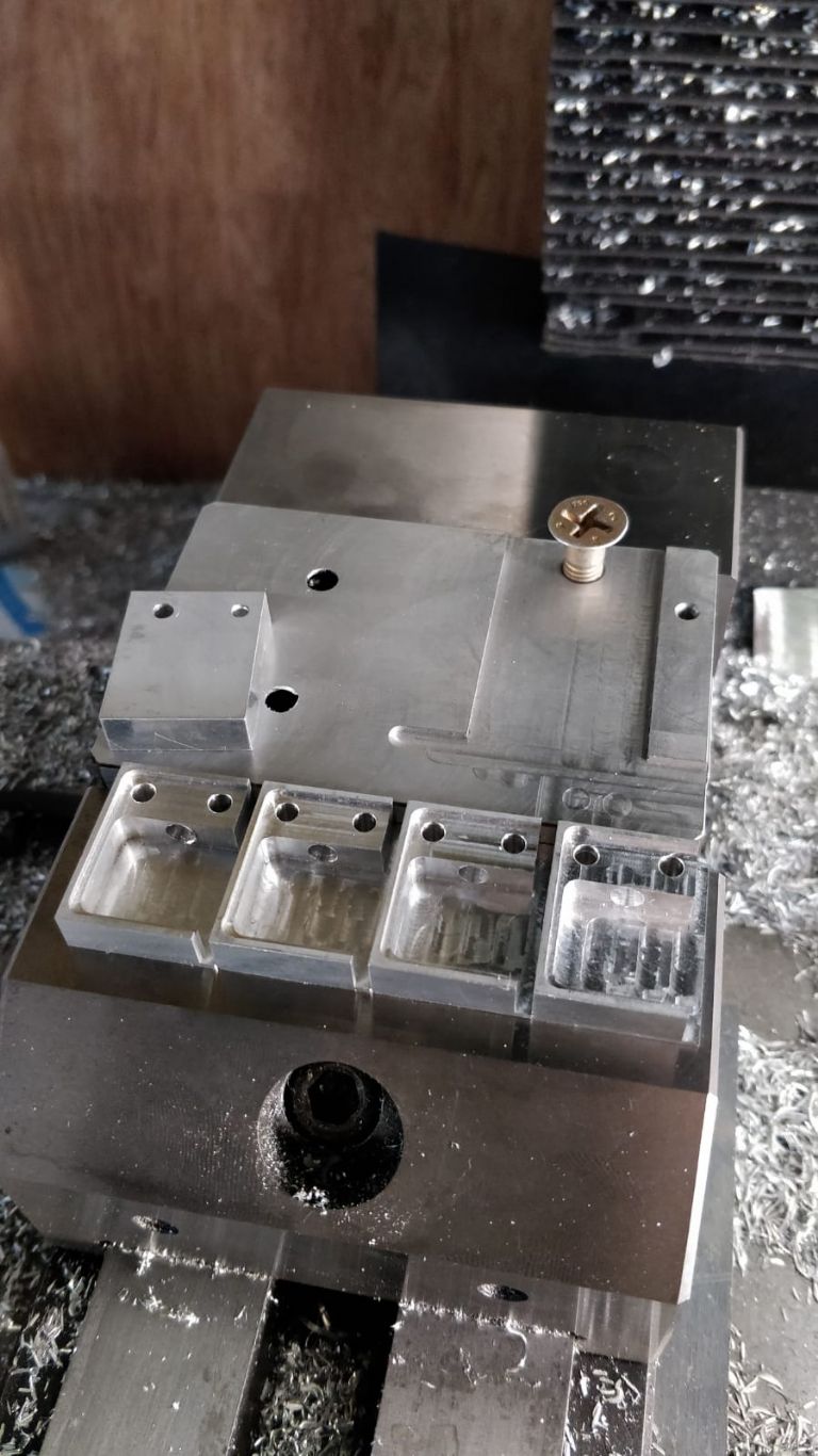

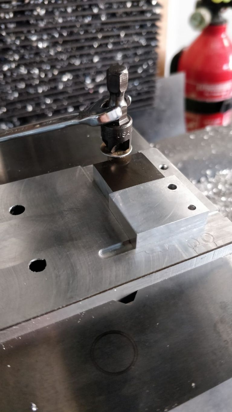

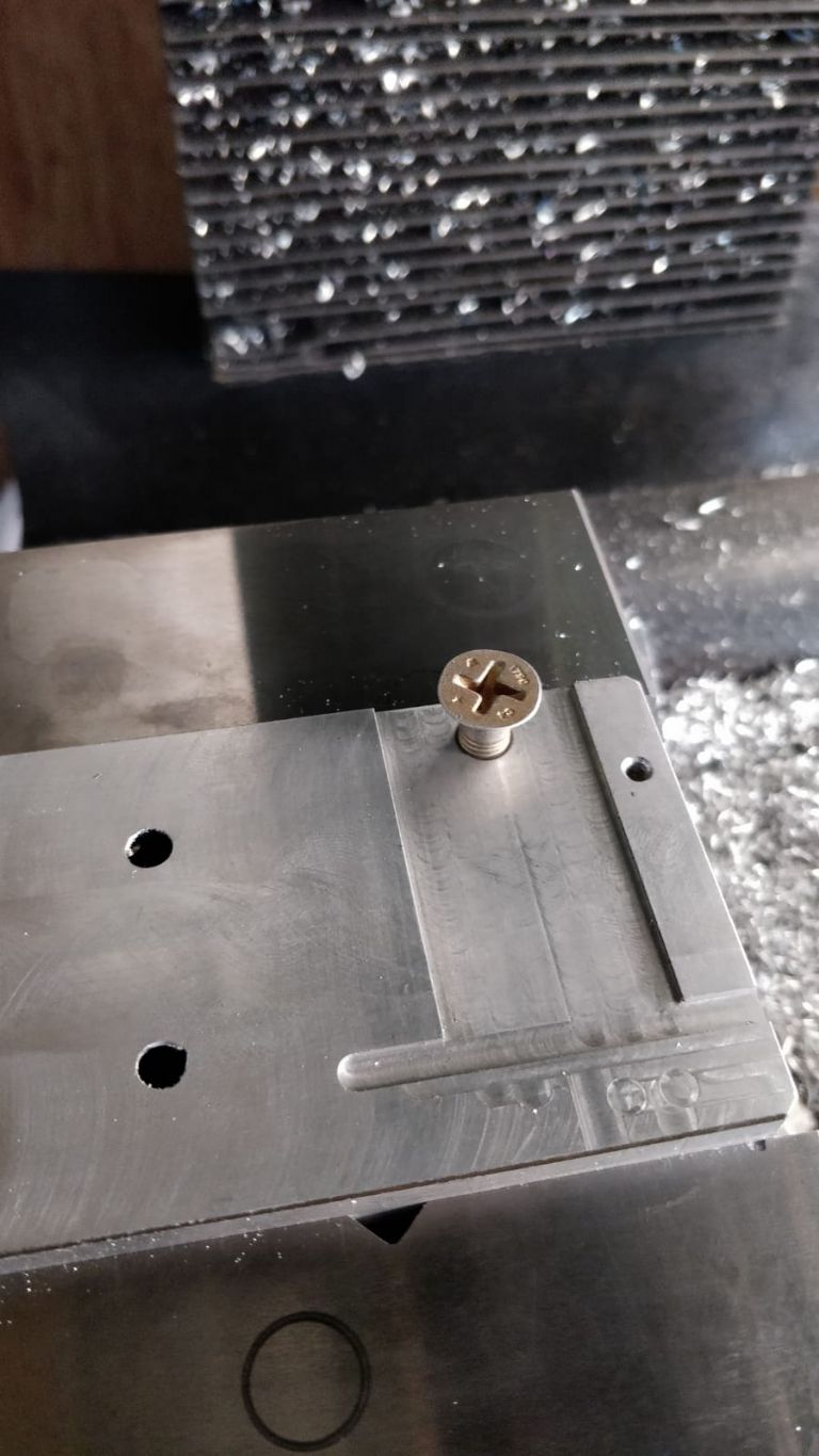

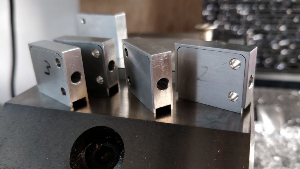

                                      Some more progress today. Milled the encoder housings out of aluminium, all ready for mounting the electronics. The encoders should arrive over the weekend, but will have to wait a bit longer to try them out and see if they actually work as the TouchDROs have to come from all the way from the States – might take a while.
                                      First I machined the read heads in to the final outside dimensions and then made a fixture to clamp them.
                                      This is the fixture held in a precision milling vice.
                                      Read head blank clamped on the fixture ready for machining. Clamping action is very simple, I tighten the screw, in turn the countersink pushes a "jaw" away which pushes against the work piece. I could have clamped the piece directly on the milling vice but was afraid the part would distort. Besides that, with this fixture I could get a good degree of repeatability ( had to make 5 pieces)
                                      First read head ready, four to go!
                                      Almost done.
                                      Ready. Also machined the covers which will also act as a guide to keep a gap of 0.5mm from the readhead to the magnetic tape.dro8.jpeg
                                      #407647

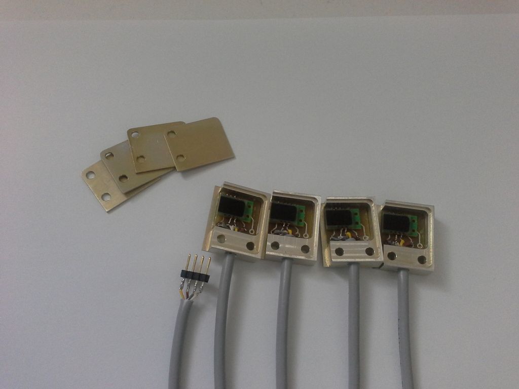

                                              Some more progress : received the encoders over the weekend, so next step was to solder the encoder to the pcb and then install everything on the readhead casing.
                                              They are indeed small and was a bit concerned I might not be able to solder them as the contact points are really close to eachother, but I managed. I checked continuity and all seem to be fine, the the proof of the pudding will come when I receive the touchDRO, so fingers crossed!
                                              I anodised the aluminium read head casings with chromic acid, the material is 7075 and has a tendency to corrode although it's probably unlikely given it will live in an oily environment.
                                              Next step is to seal the encoder inside the readhead casing, I'm split between resin or sealant, not sure which way to go. I would prefer resin as it will become one piece. On the other hand with resin, once cured there's no way I will open the thing again if I need to.dro12.jpg

                                                I would wait before your 'next step' so that you can test everything works before potting.
                                                Are you connecting the cable screen at both ends? There is a case for connecting it only at the 'input' end of the wiring (the TouchDRO PCB connector) but you only seem to have 4 pins.
                                                Ian
                                                #408153
                                                ChrisB
                                                  @chrisb35596
                                                  Not sure if I did this right, I connected the shield to the read head casing, the casing will slide and contact the lathe and mill body (which are grounded) so I'm thinking I should have a ground, did I get it right?
                                                  In reality I don't know if cable shielding will be necessary as there will be no other electrical wires routed along the read head cable, so I would think noise should not be an issue – but I might be mistaken.
                                                  Good advice re. waiting before sealing everything…hope the touchDro wont take long to arrive!
                                                  #408158
                                                  Ian P
                                                    @ianp
                                                    Connecting the screen at both ends introduces the 'possibility' of the screen carrying current. Only connecting one end means that the screen is purely a screen. In sensitive audio or electronic measuring instrumentation it is usually only connected at the amplifier end.
                                                    Current flowing through a screen could be induced to the contained (signal) wires by capacitive coupling, in a perfect world no current would flow through a screen connected at both ends because the equipment at both ends should be at the same potential. In practice your lathe motor and lathe metalwork might be plugged into one 13A socket and the PSU for the DRO electronics might be in another socket so there might be a 'loop' of ground/earth wiring that acts as one turn of a transformer that could couple surges and spikes into the signal wires.
                                                    To be fair logic level signals in this DRO application are pretty immune to interference and there are a lot of 'could's' and 'possibly's' in my previous paragraphs, in practice grounding the sensor end will be OK. Not sealing everything up yet allows you to test and if necessary make changes.
