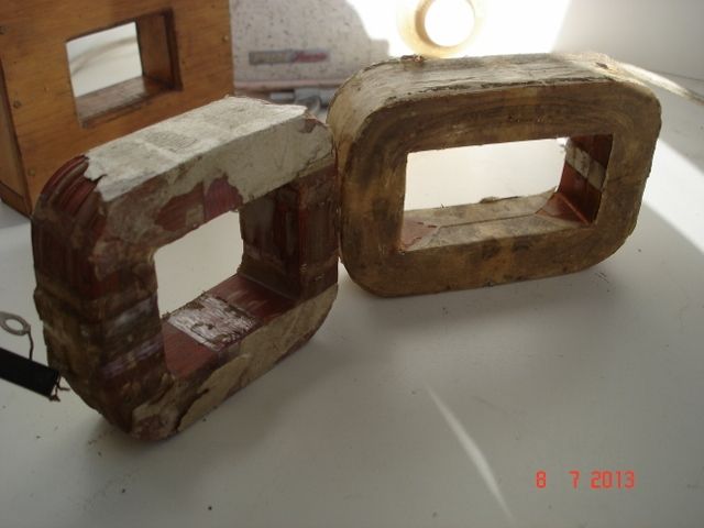

                            dsc00683 (640x480).jpgI'v got the demagnetizer, it uses a coil from a microwave oven, and the transformer control from an old electric blanket (3 heat)
                            Ian S C
                            #316266
                            Paul Lousick
                              @paullousick59116
                              That looks like a bit of very sophisticated gear !!!! I assume that the micrometer is used for accurately setting the dial on the transformer.
                              How does it work ?
                              Paul.
