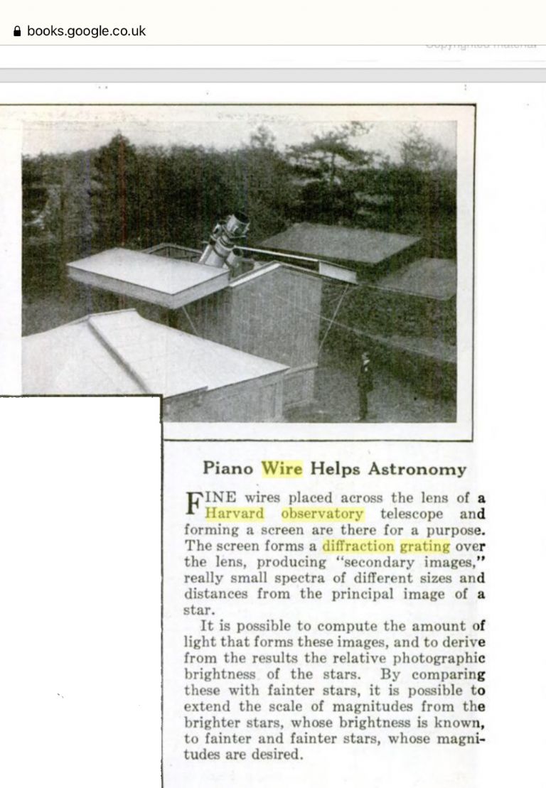

              I am pretty certain that this is not a spectrograph grating. There are too few wires, which would give a very dim image; and the spacing is too large for optical wavelengths which would make the first order spectrum very close to boresight. As Martin and another previous poster have suggested this is most likely to be an aid to mirror or lens testing – Martin maybe you could describe how the gratings you made were used?

                    Blimy, now you are asking, its a while ago. Essentially its a Ronchi test. From memory I used a green LED through a pinhole with the grating the other side of the pinhole. The device is placed at or near the centre of curvature of the mirror and viewed through the grating which etends above the LED mount. Interference generates a pattern of light and dark stripes across the surface of the mirror. For a perfectly spherical mirror the lines will be straight. It's quite good at detecting turned edges and hollow centres. For better deternination of shape the knife edge test with an appropriate mask works well.

                      Rewinding to 1913 … which pre-dates the object in question: **LINK**
                      http://articles.adsabs.harvard.edu/pdf/1913MNRAS..74…50C
                      9 pages :
                      On the Application of Parallel Wire Diffraction Gratings to Photographic- Photometry.
                      Edit: although made for a much larger telescope, the description of the wire tensioning [section 5] seems relevant.
                      Edit: and here is the cross-referenced article about 262 stars:
                      http://articles.adsabs.harvard.edu/pdf/1913MNRAS..74…40C
                      Edited By Michael Gilligan on 16/08/2021 11:00:09
